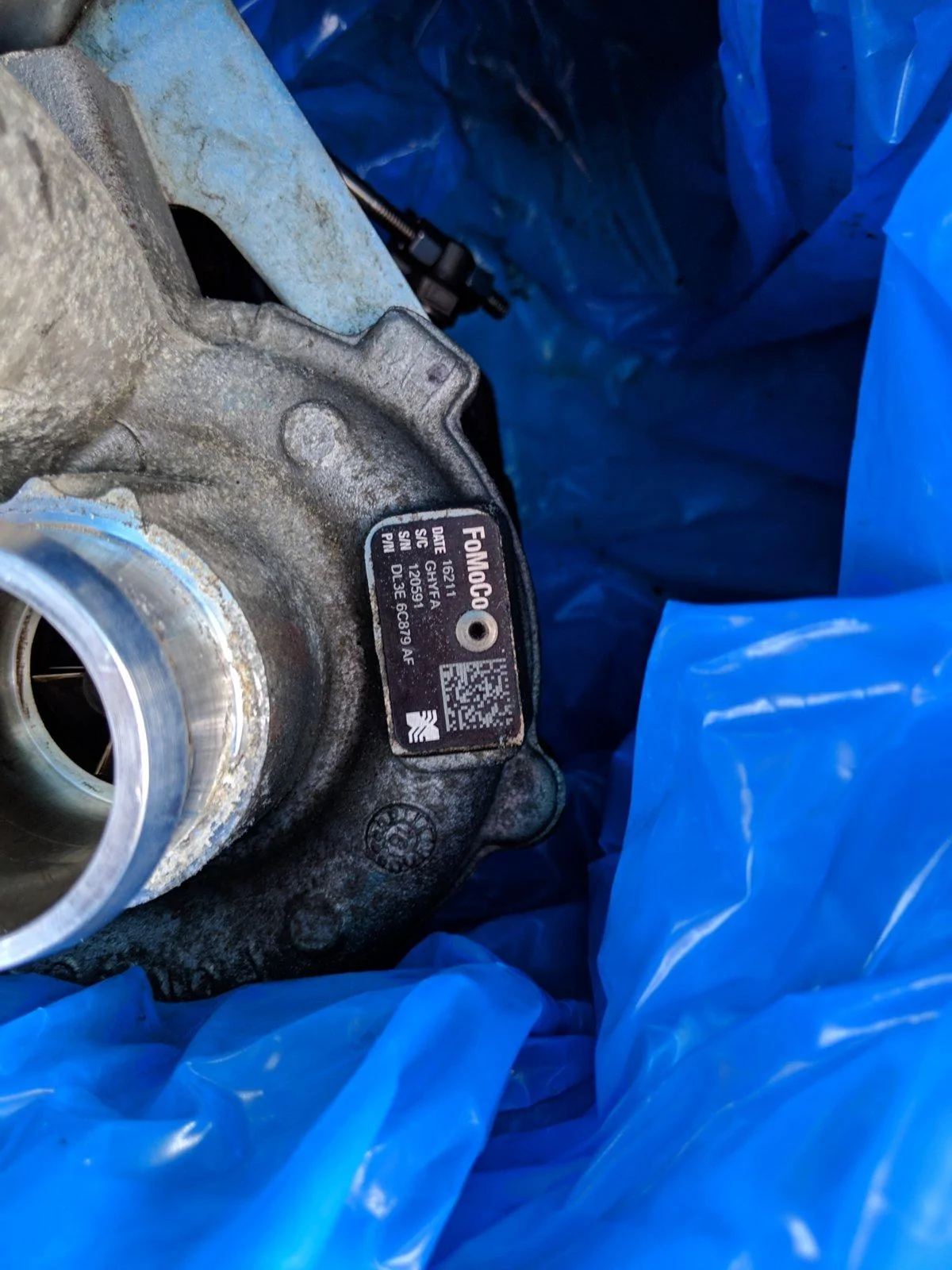

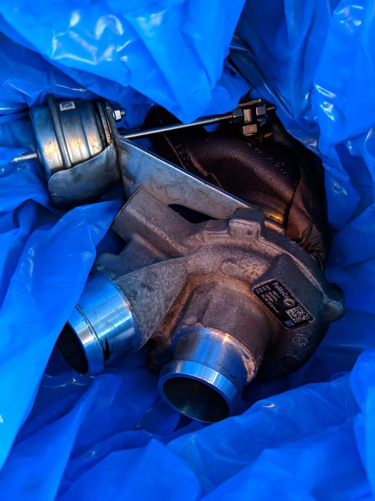

Well.... My plans just took a drastic turn today.... Found these locally for a price I could not pass up. Got both turbos (from a 2016 F150, About 50k miles on them), both manifolds, both stock downpipe adapters (will either modify them or use them as templates) and associated bolts for $350. Turbos look good, have no play in the shaft. I think I will run them as is unless I discover an oil leak issue. I will rebuild them if that is the case.
Now beings the work of planning out the rest of the system. Sucks that the M90 project does not get to happen now but again, this was to good of a price to pass up! Plan to keep my build on pump gas and likely will go with a liquid to air intercooler and port the exhaust manifolds.

The 2016s are a better turbo all around and so are the manifolds from that year. However all the ecoboost guys say they cant be put into gen 1 builds. Wonder how that will play in? I think you got some good components for the start of a good build....just to a dyno tune through a speed shop and not a remote tune if it can be helped. Can't wait to see your project.

I am not seeing where things are different enough to not fit on previous cars. The guy I bought them from said that the 15-16 turbos are slightly larger then previous years but that they are still gen 1. 2017 is when gen 2 came on the scene. The manifolds are certainly different for the gen 2s.

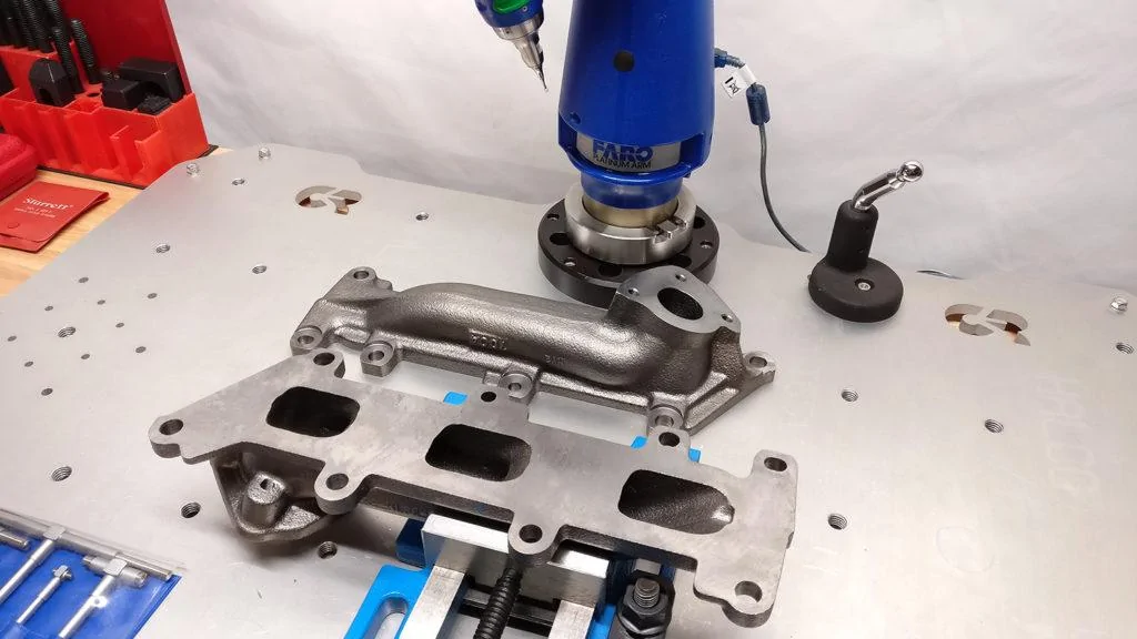

I have toyed with the idea of seeing if I can get gen 1 turbos bolted to gen 2 manifolds. Gen 2 manifolds have a different flange on the cylinder head side but I'm not sure if the turbo flange is different or if it mounts the turbos in a slightly different location...

Gen 2 manifolds....

Sorry confusing the years. The turbos are different in each variation from the 2011-2012 / 2013 -2014 / 2015-2016 and so on. The differences range from the way flanges connect due to changes in the manifolds (earlier manifolds almost always experienced heat warping), deletion of internal BOVs, slightly bigger compressor housings, etc. Your right gen 2 is 2017+. What u have will work well, but port those manifolds!
