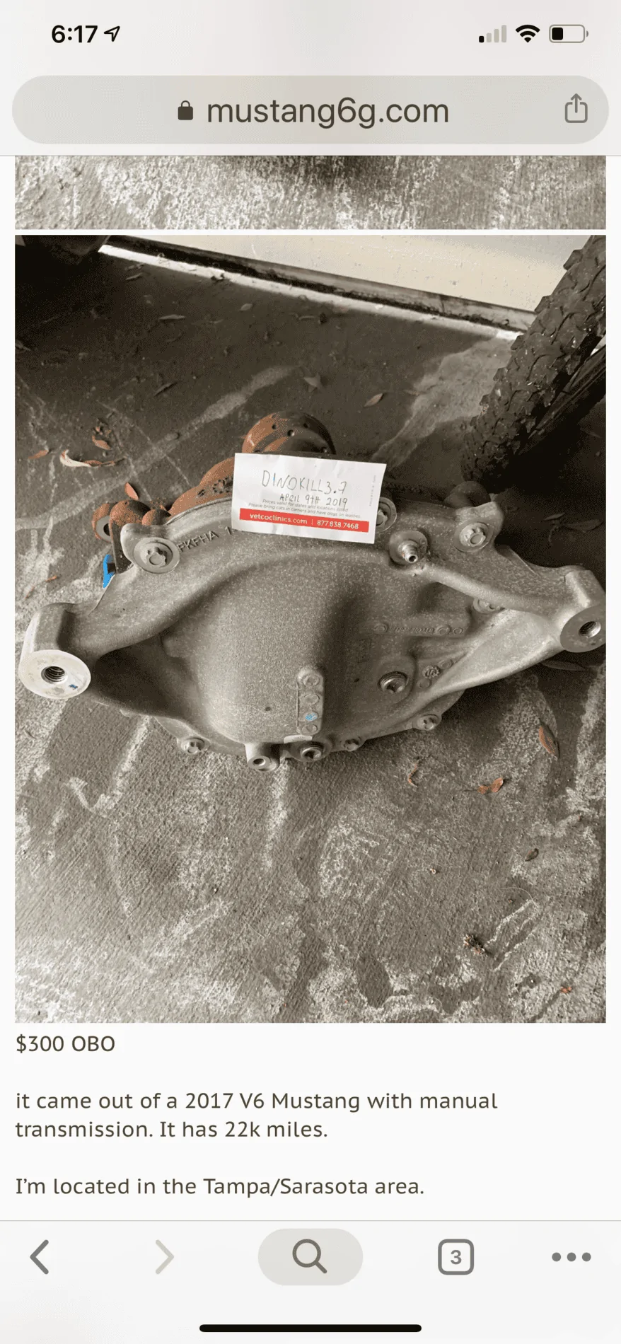

Here is one that was posted in the for sale section, it’s sold, but it exists
Ah yes forgot about the V6 manual. EB and GT manual has 3.31 as lowest numerical ratio.
Either way you'll be looking for a while likely.
