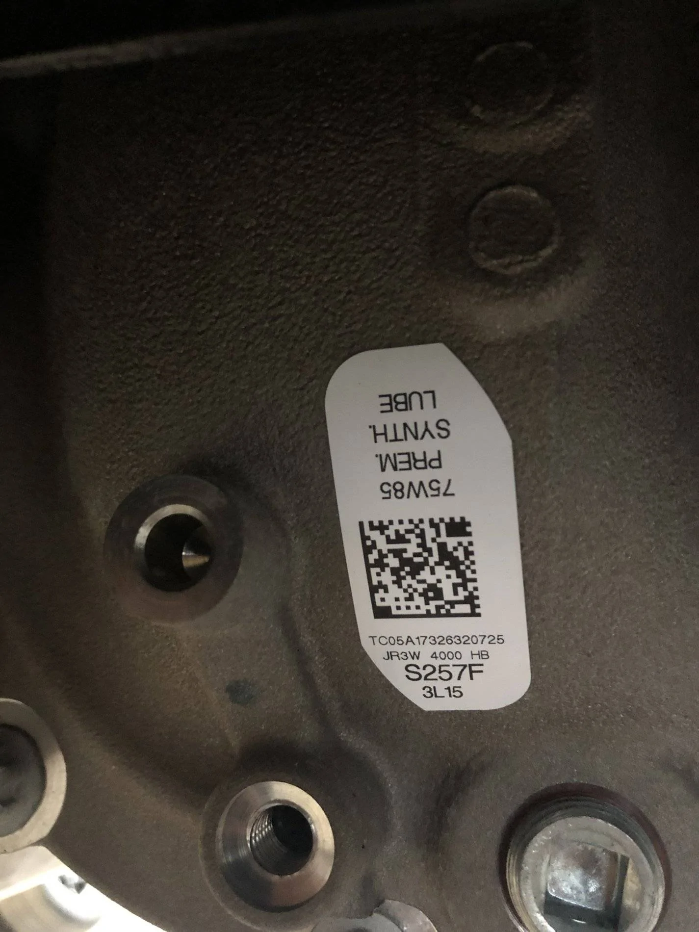

What gear do I have???

I see you list your car as a PP car, this should have a 3.73 Torsen diff, wonder whats going on. Either you changed cars, or the diff has been changed. The sticker is probably accurate on the diff. Hmmm...

If you really want to know and not sure:
1) Put a narrow white line on the rear tire
2) Put a mark on your driveshaft
3) With the rear safely elevated and secured with support stands on level ground, turn the rear wheel and see how many times the drive shaft rotates
On a 3.15 gear, the driveshaft will rotate just a tick over 3 times for every complete 360 degree rotation of the tire.
