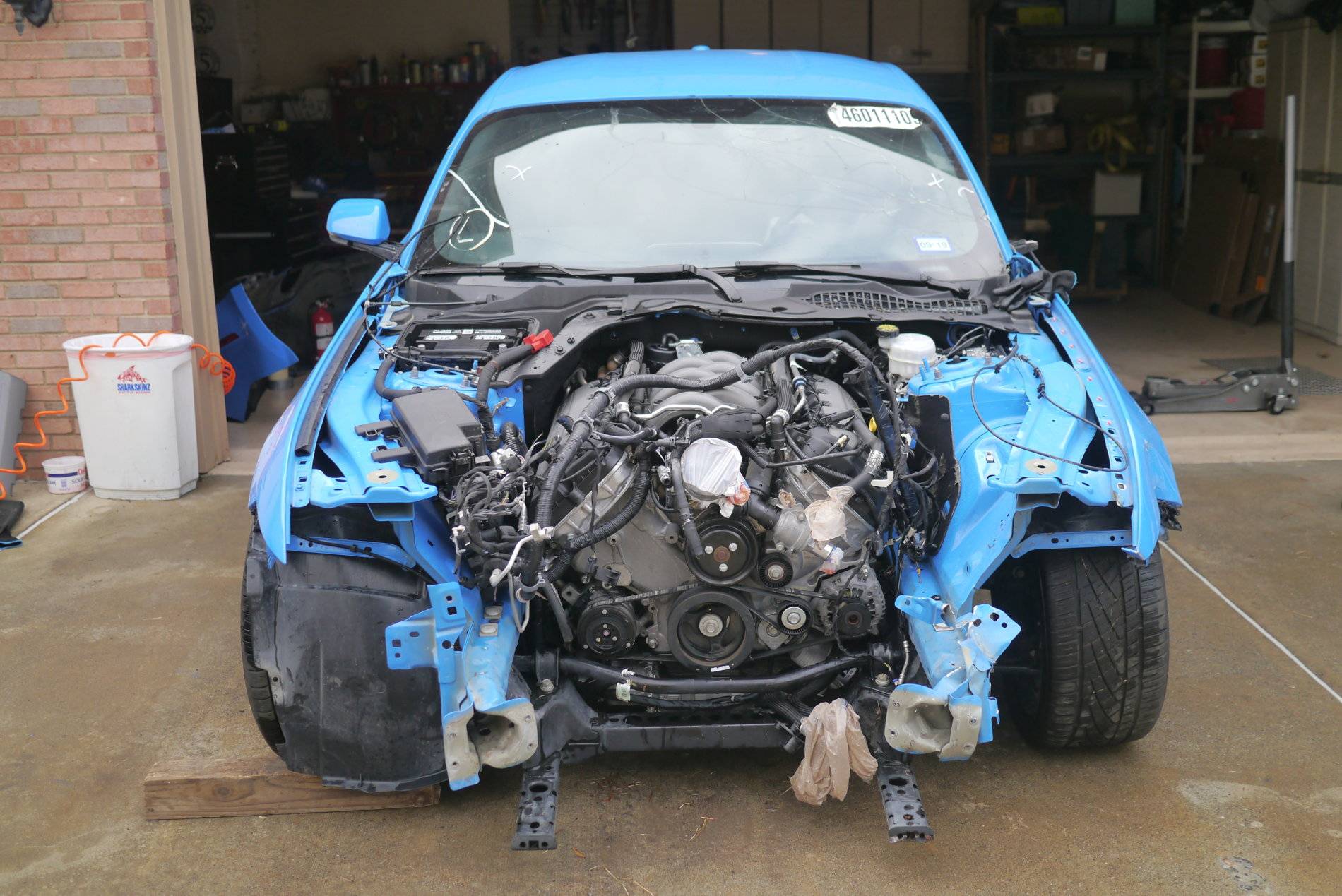

I was wondering what are the minimal wiring you need to keep for the 2nd Gen Coyote engine to run? I have a wrecked 2017 Mustang GT that is donating its drive tran to a FFR Cobra project. Usually people buy crate motors with Ford power packs, but I cheaped out and bought a crashed Stang. I have heard that wiring can become a bit tricky since the computer wont see the dash, ABS, and a few other things. Can anyone share a bit of wisdom?

I bought a wrecked GT, so I have almost everything. But I did read on Cobra forums that mustang electronics don't play well if certain parts are missing. My kit car wont have ABS, original dash, and a few other things.
