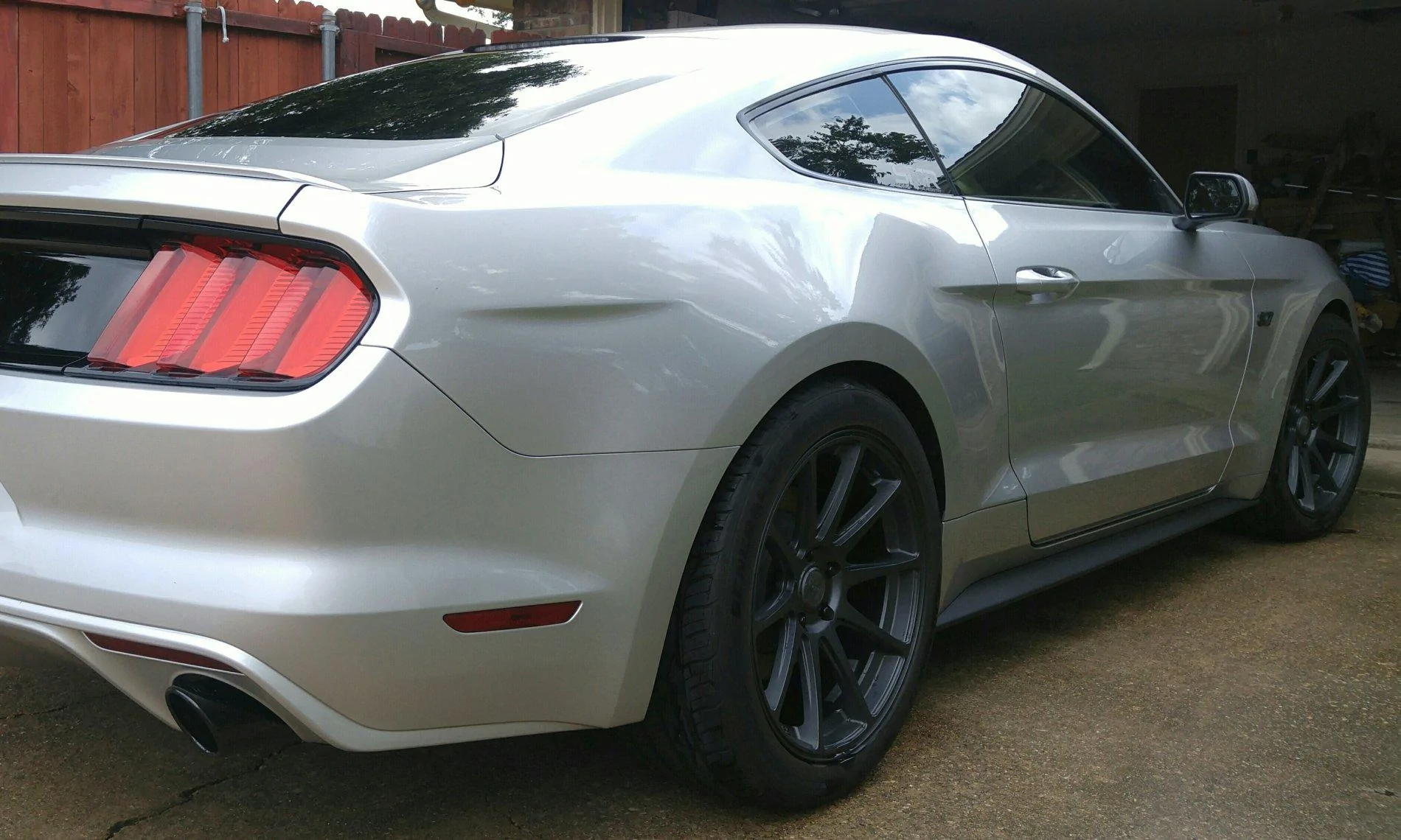

I have your same wheels from SVE and went 275/35/19 Michelin PSS. Pic below for reference. IMO you could do 40 profile if you were stock height. I'm also non PP.
Thanks, looks darn good.
