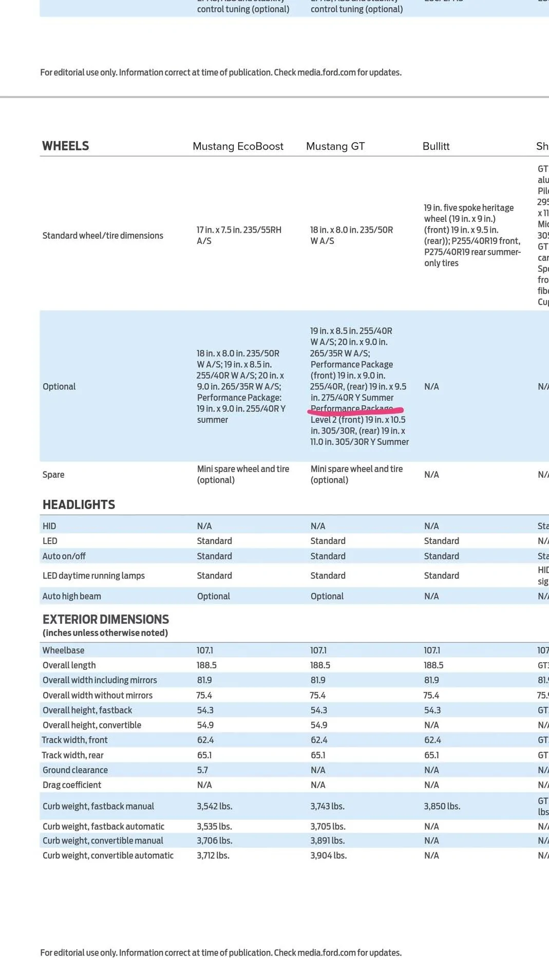

The stock PP1 rear are 9 1/2 with 275/45/19
I bought a extra set and going to use the extra rear set on the front of mine
It should be a 275 40 from the factory

yes the rear is that is why I am using the other rear set for the front so there are 275/40 all the way around

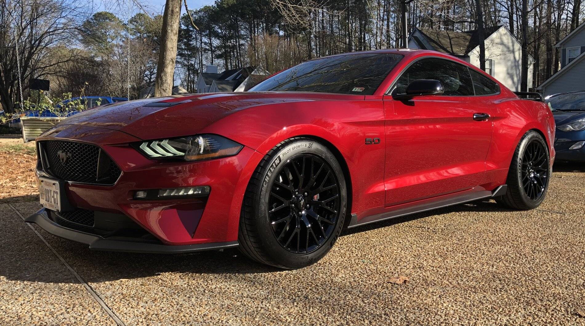

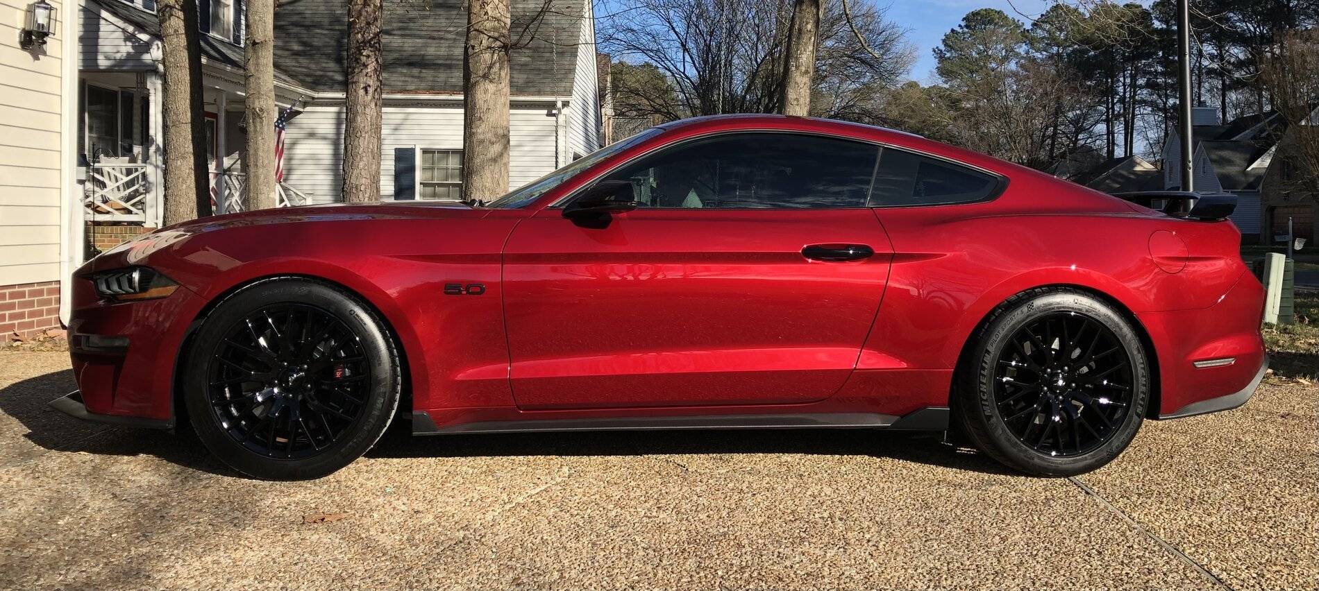

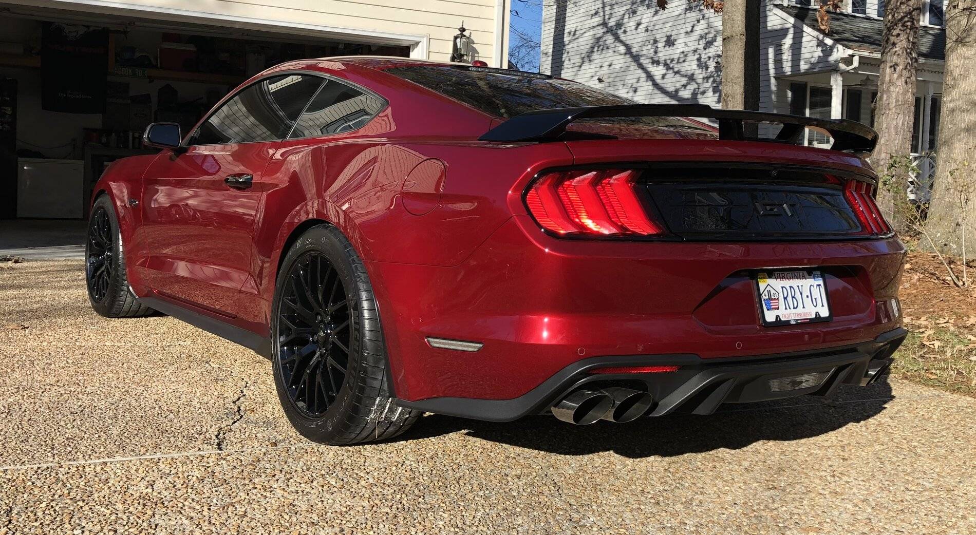

Put a set of rear PP1 wheels upfront yesterday. Steeda 25mm spacers all 4 corners, 275/40s BMR min drop springs. Drove 70 miles today and no issues.
Fly2High
Sep 9, 2019
78
1,191
615
Long Island
Frank
2019 Mustang GT PP2
Any reason you got 4 rear wheels? With the spacer, how far off does that come to what the front offset was?
What are the wheel offsets now?
Why not just buy an aftermarket at the correct offset and go without the spacers?
Not judging, just thinking of alternatives.
86pagt
Aug 29, 2019
355
370
Virginia
Dale
2019 Ford Mustang GT
I had the 25mm spacers already before going to the 19x9.5 upfront.
the 19x9.5 has a + 52.7mm offset so now it’s + 27.7mm. Sure I could go buy 4 new 19x9.5 or 19x10 wheels with the proper offset but I like the the OEM PP1 wheels and will eventually go to extended studs and run either a slip on 20mm or 15mm spacer.
