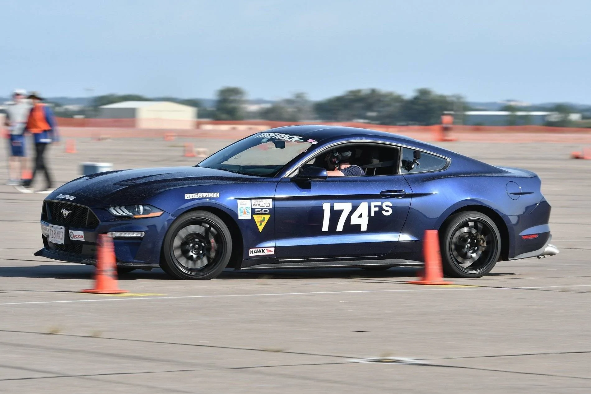

There I was, feeding my sidewall to the ground, when all of a sudden...
My 275 on an 18x9
My 275 on an 18x9
That's a whole extra inch of wheel width for 10 cm more section width compared with OP's ask.
275 on a 9" is generally OK, but more than that not really. For autocross it helps more than hurts, as you've found.
