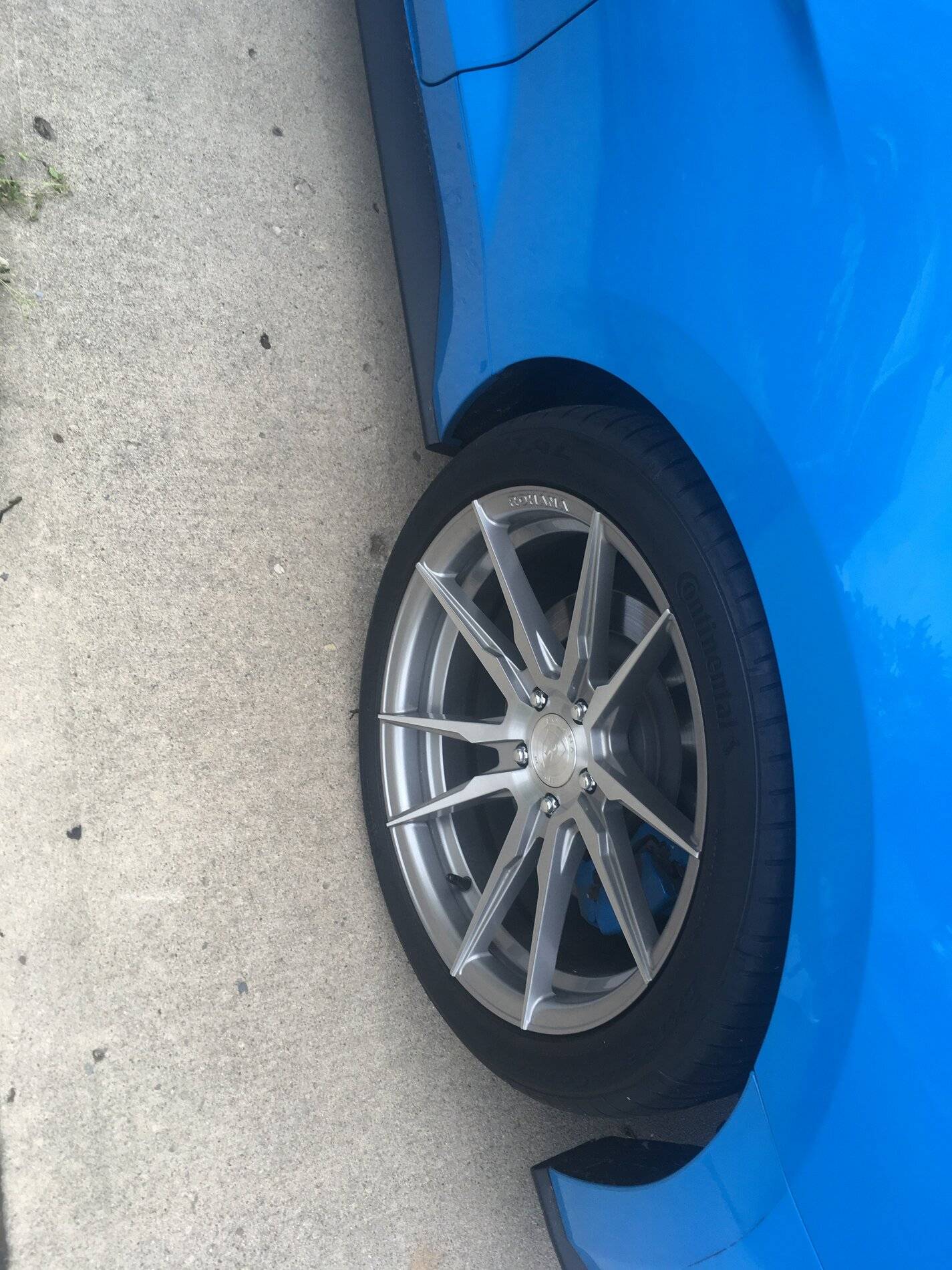

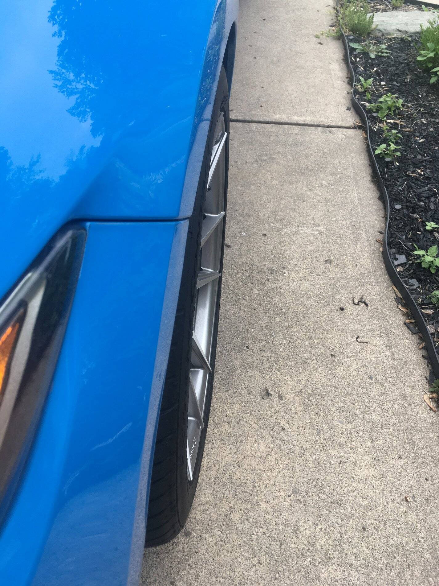

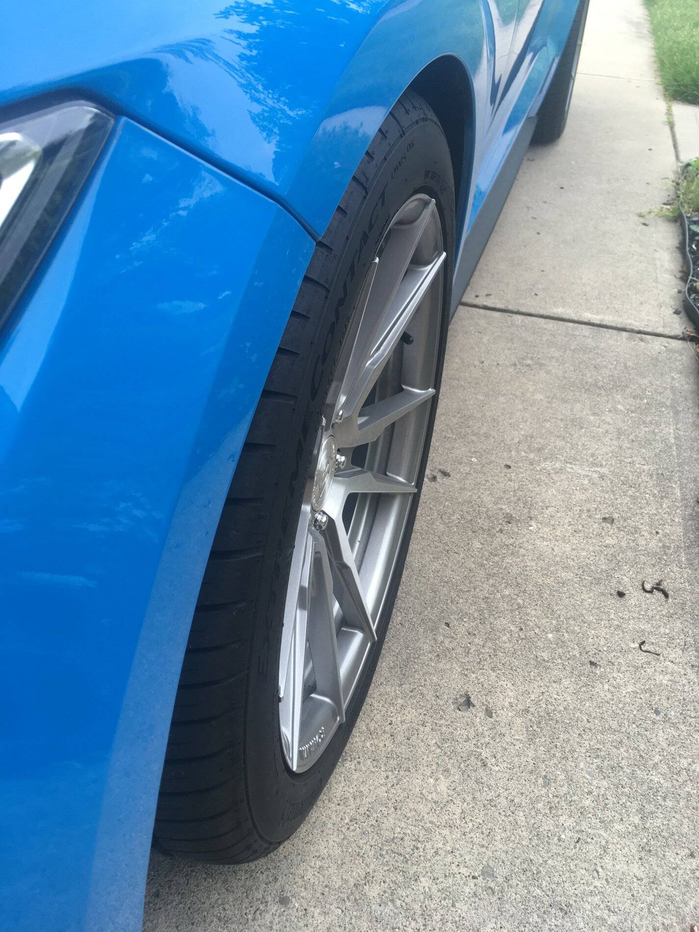

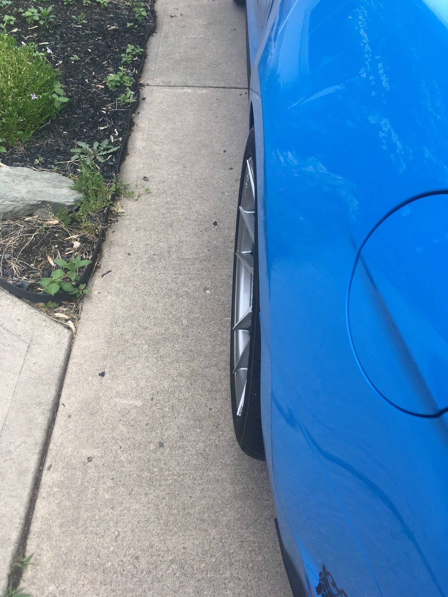

I can only tell you my experience. but 255/265/275 all was stretched on my Rohana 19x9.5
I had to get a 285/35/19
FreePenguin
Sep 29, 2019
81
5,354
3,704
Ohio
Donald
17 mustang
My 255/40/19 that I had on my 19x9.0's they fit perfect on those, then I got 9.5 Rohanas transferred them over, they was stretched as heck. The discount tire test fit the 265/275 and they barely look right, like minimally passable. I then went to 285/35/19 and boom. fit great.
Just took these photos for ya. I got nothing else to do, cant drive right now due to being injured.

nope, shame though. im full steeda suspension, it would probably handle great. im too afraid to hitting a cone to do it. my friend did it and I was passenger and it was a hoot! he grazed a traffic cone and it marred his paint, I lost the interest after that. it scuffed his car up a bit.
I think if I did track, id want a spare car, just for the track. I dont wanna hurt my baby. 265 imo will be too small for 19x9.5 275 should offer SOME rim protection or be damn flush, in my case, 265 and 275, was just as stretched as the 255, it was still pulled inward.
the 285 gave it a nice round appearance. ymmv on wheels, go to discount tire, they will test fit wheels for ya. I went through several on the spot! they was great
