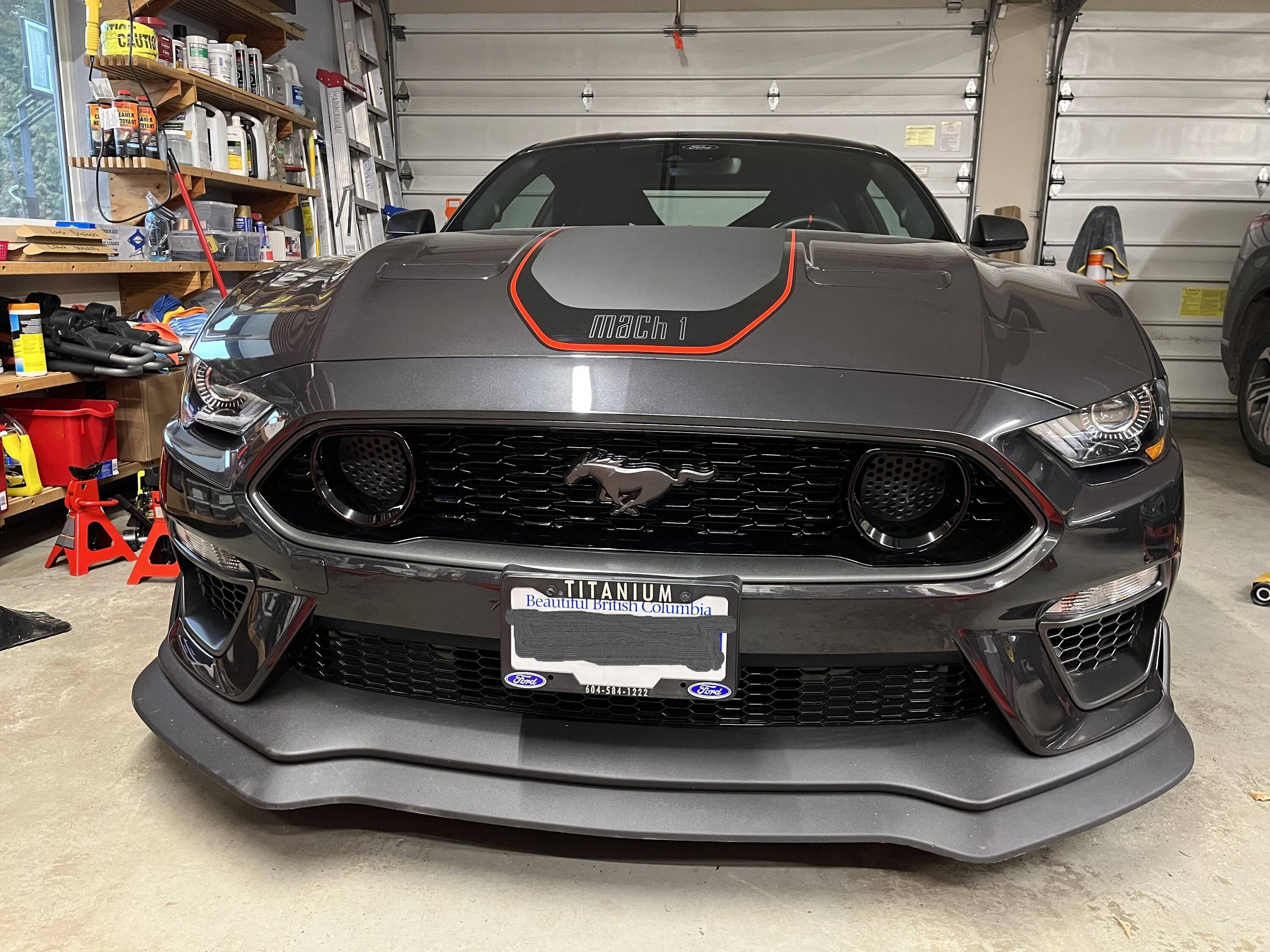

Both sides done. Passenger side was easier than I thought. Had to drill a small hole on the very left side on the delete (left of the fog light hole) as there is a clip there as well. So able to pull it to snap close.

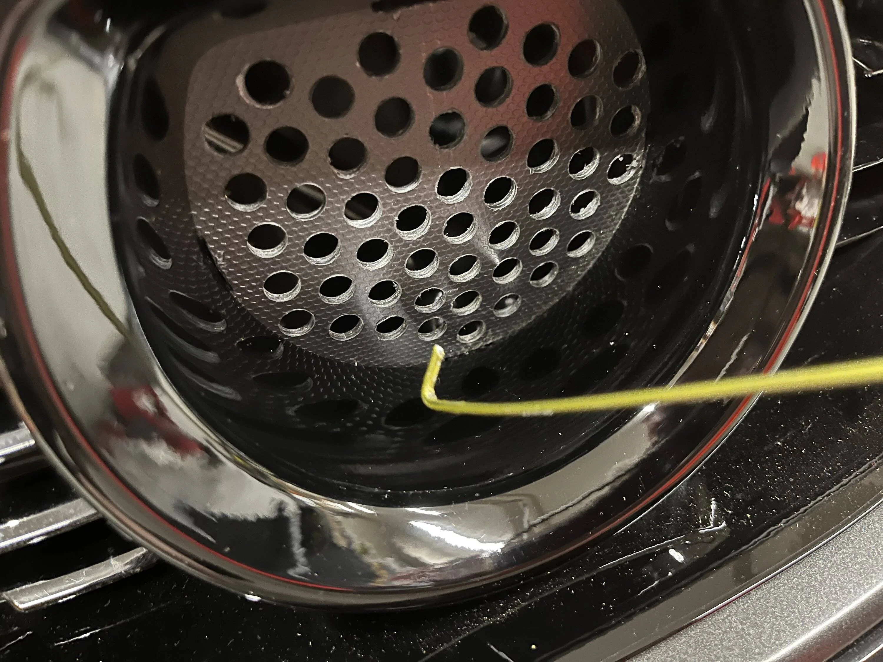

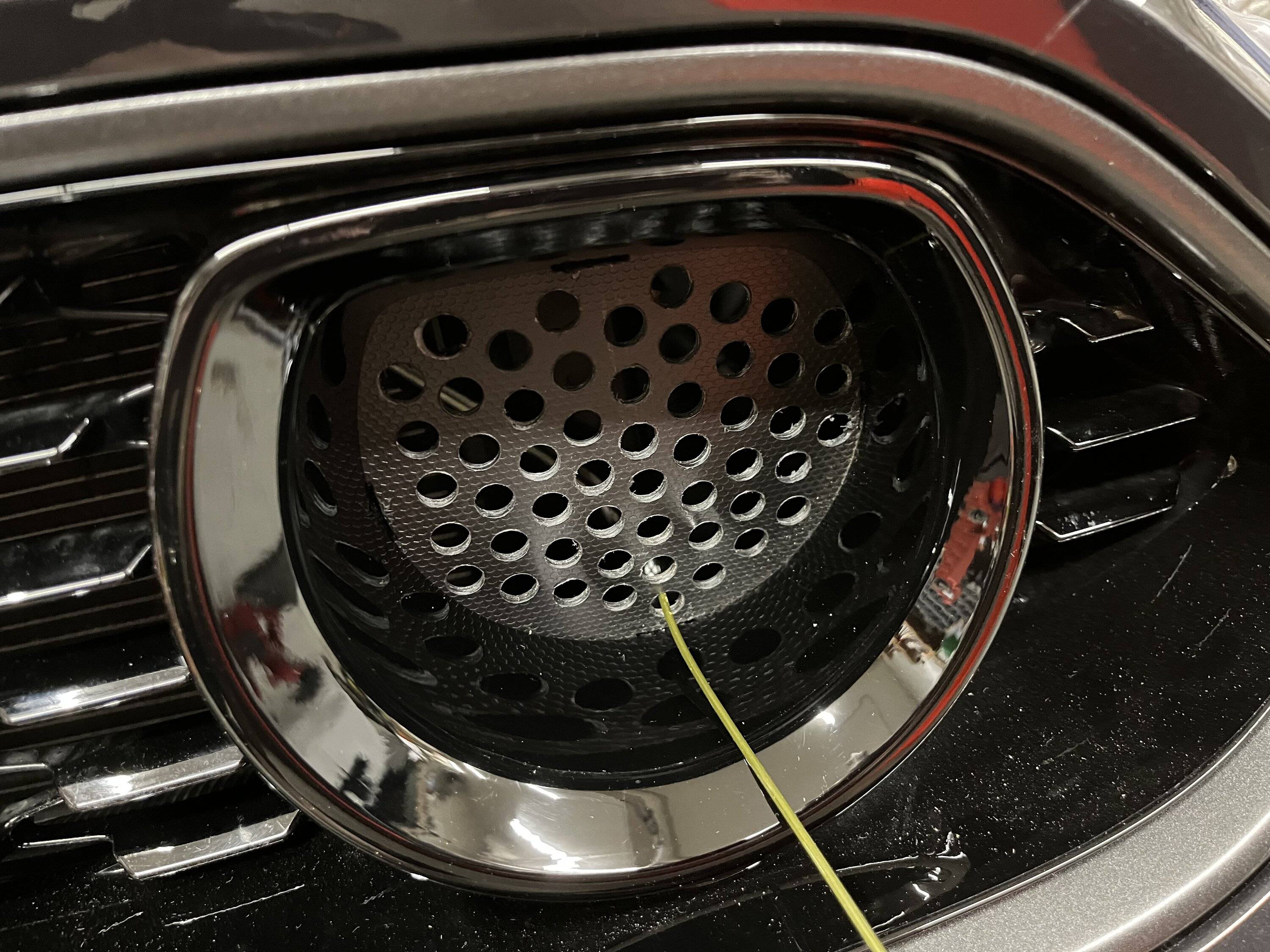

I'll share shortly. But yes, remove top radiator plastic cover. I saw this link on youtube.
Drill the deletes and then reinsert them in reverse order of how you removed. Position them in place and using the drilled holes, put a coat hanger wire with small bend 90deg on the end and feed through the hole closest to the blank clip and pull towards you until it clips in place. Repeat for the other clips. For the passenger side, the fog light delete is bigger. There is a clip on the left side from the fog light hole (you'll see this in the video link) and I drilled small hole above the clip so I could also pull it closed.

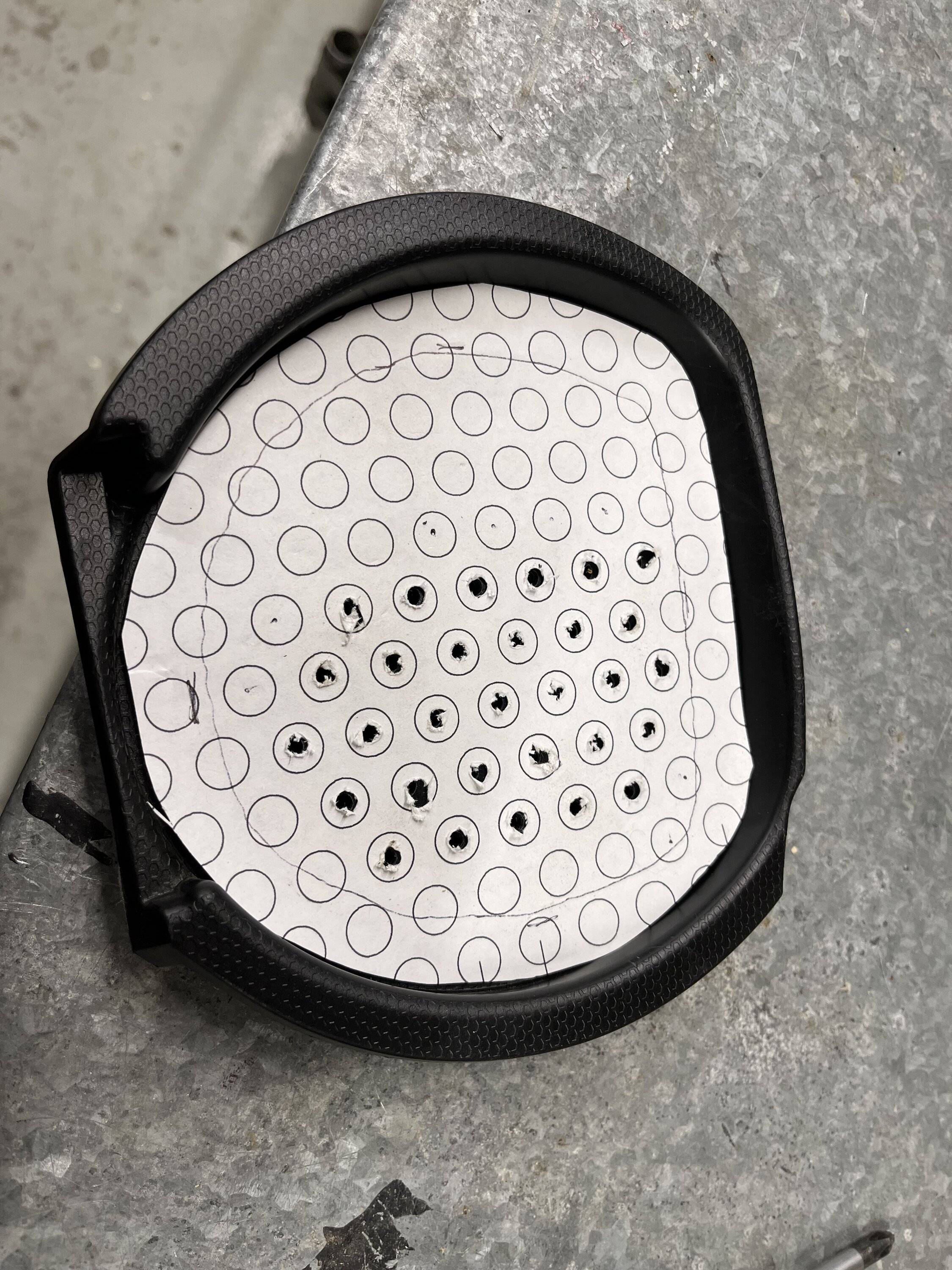

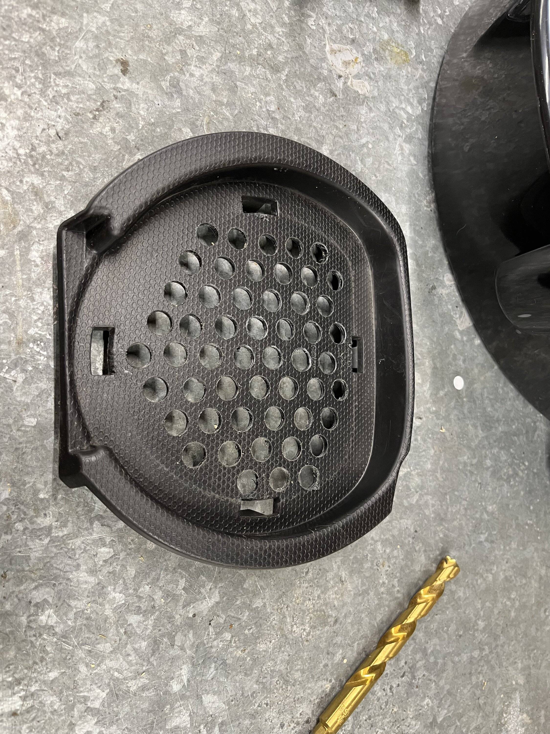

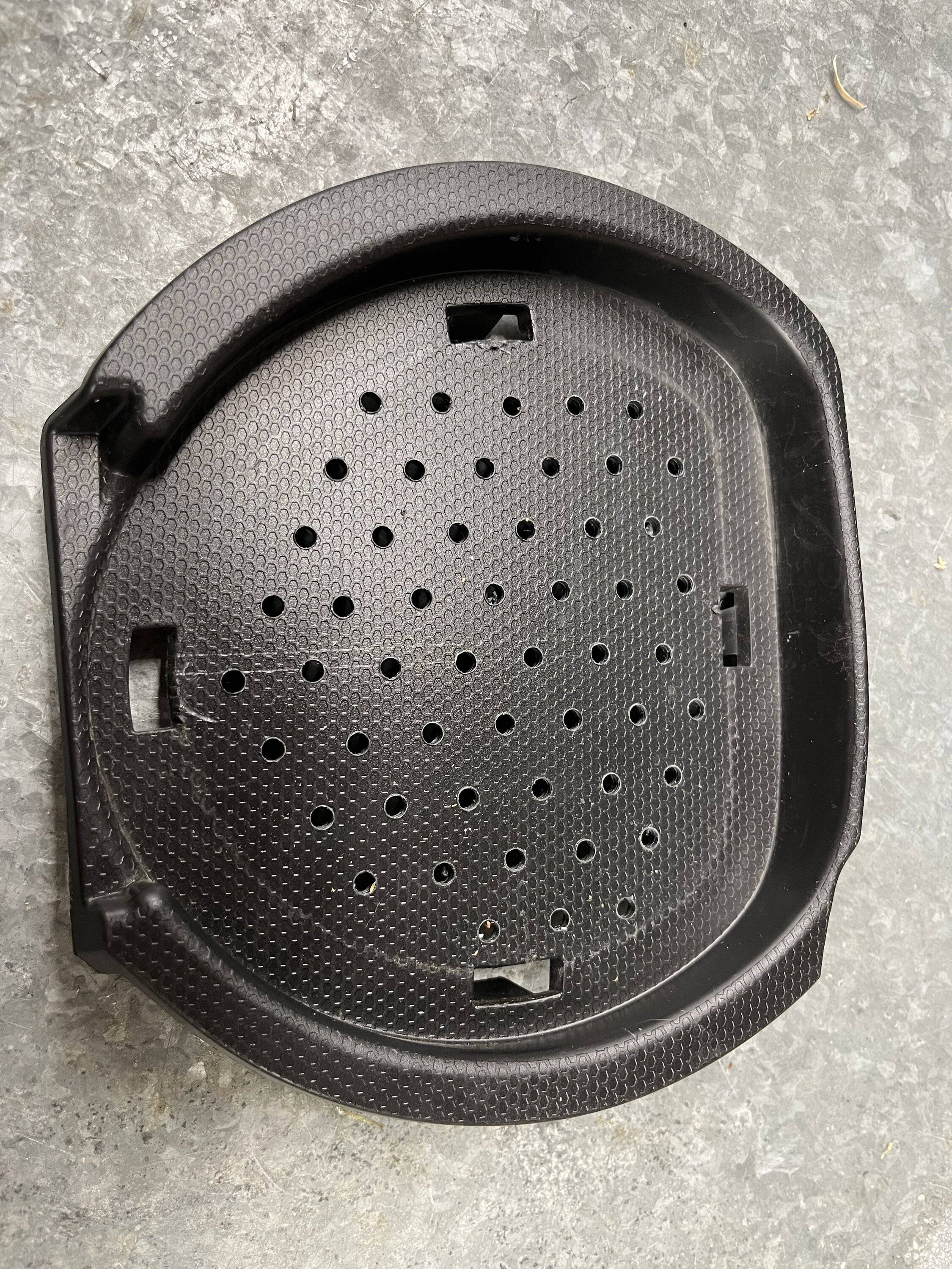

Using the paper template, I cut it to fit into the round groove of the delete. This stops if from rotating and stays pretty well in place. Put the delete like this on a bench drill and used 3mm drill to pilot drill each circle. in the center. Just estimating the center of each small circle. When drilling, I pressed down with my left hand and fingers on the template next to the hole that I was drilling so it would not rip up with the drill. Once I got the pilot holes done, I followed up with a 9.5mm (or 10) drill and drilled through each pilot hole.

It's pretty easy to put these back. Slip them through the top, catch it with your one hand through the fog light hole, and guide it to almost exactly where it should be. I use a long screw driver and the wire hook. Once it in line, then put the wire through the hole closet to the clip, and pull it and it snaps into place. Repeat with the other clips.
