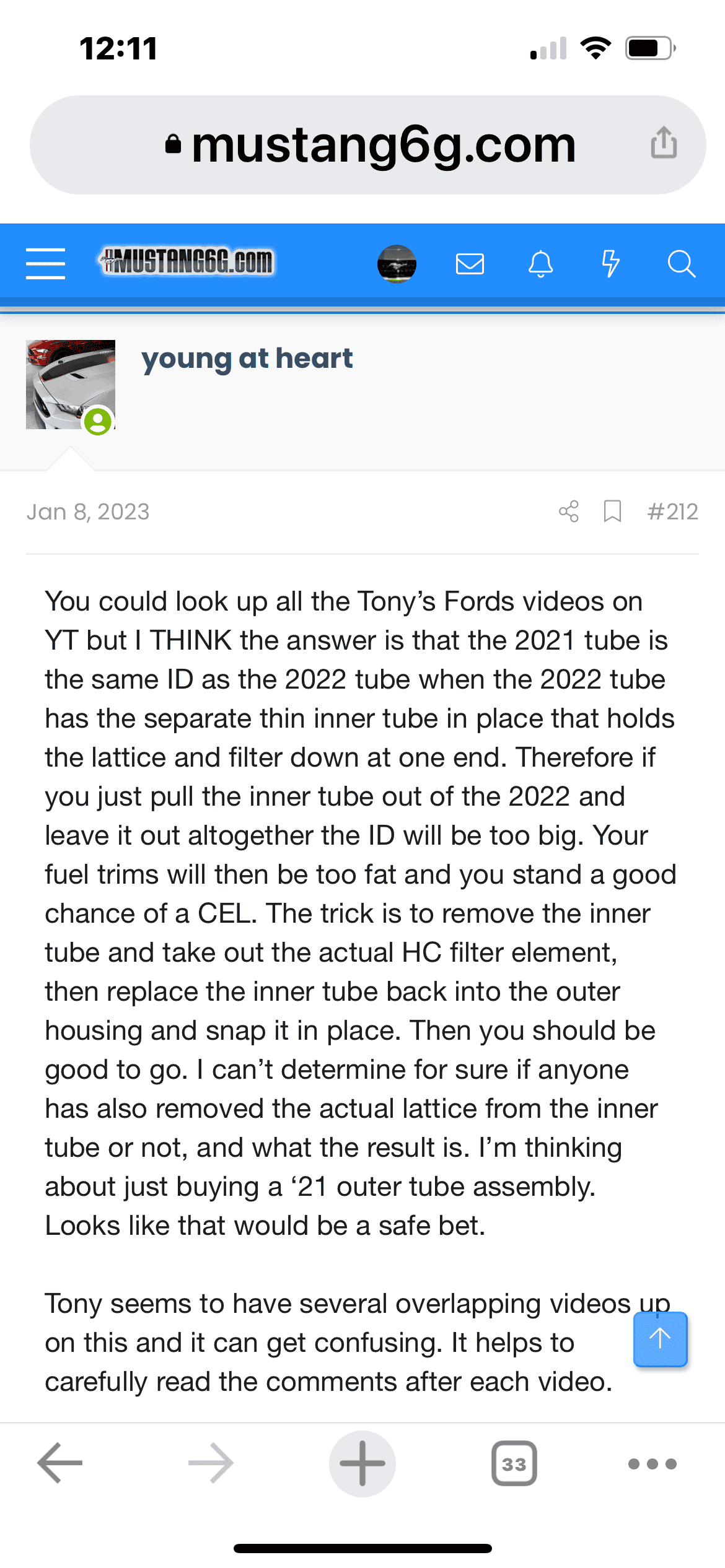

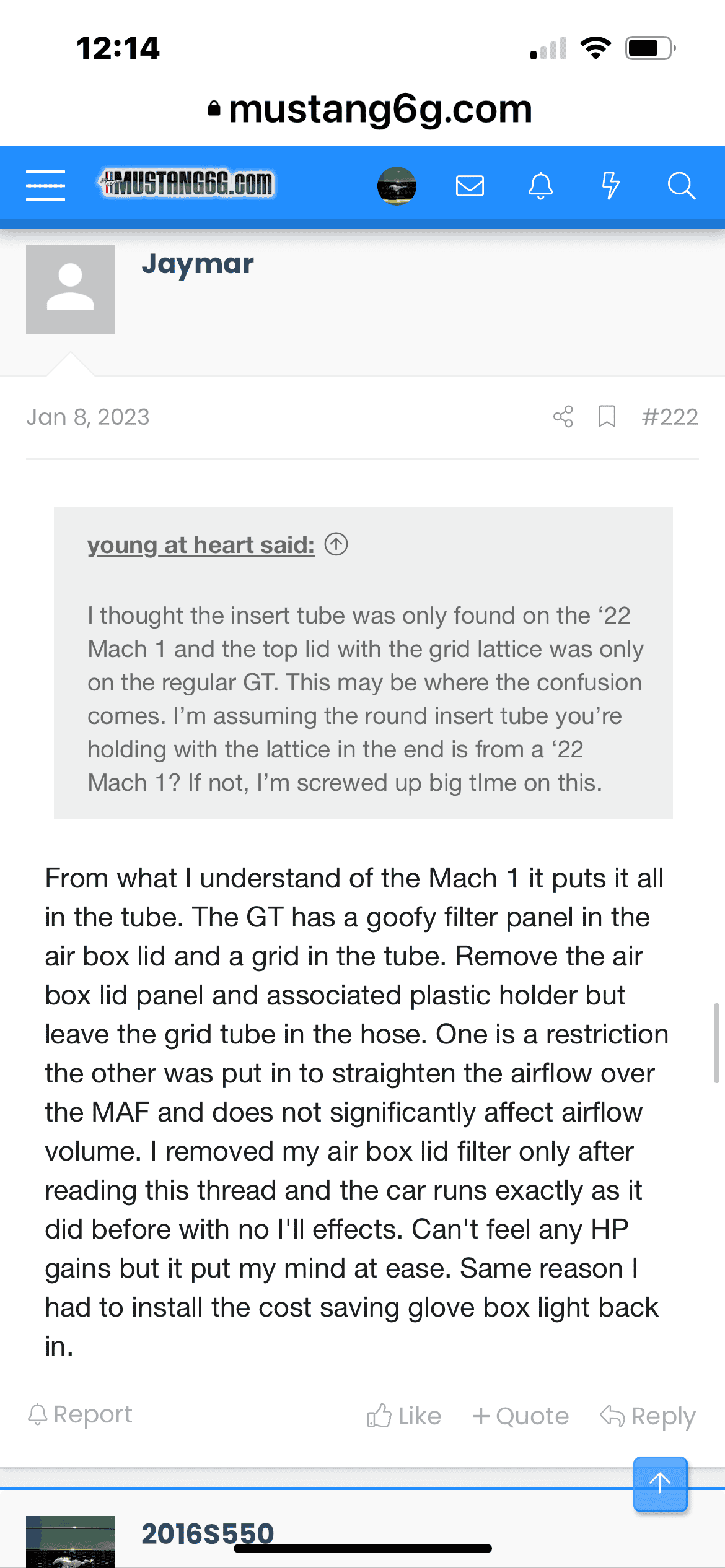

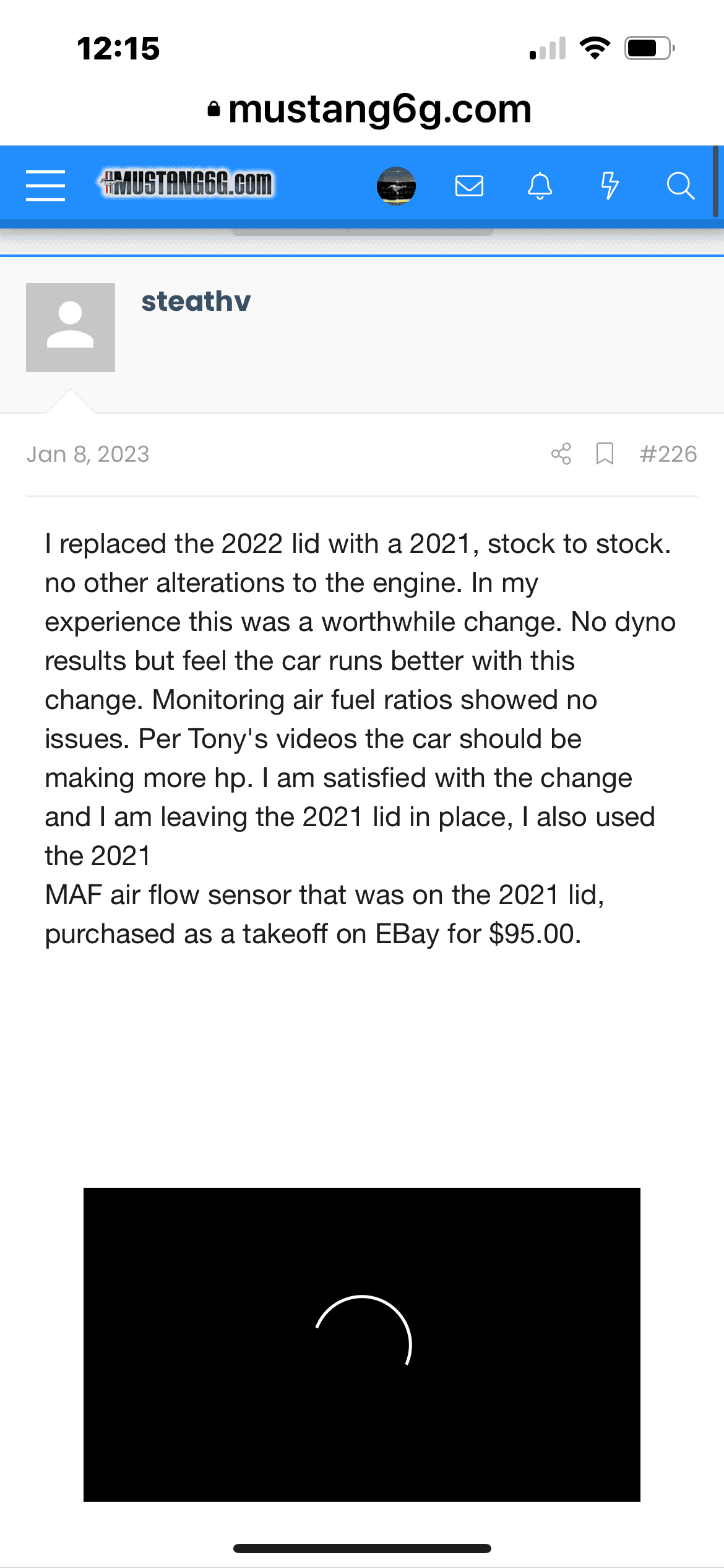

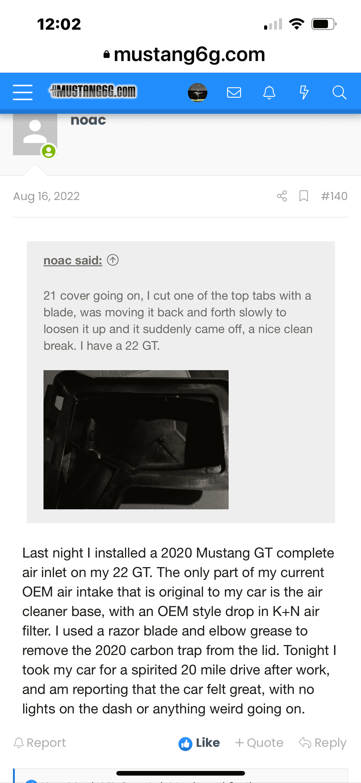

To answer your question…NOBODY has documented that they have removed BOTH the Charcoal Filter, it’s grid holder as well as the GRID INSIDE the Intake Tube (Grid is inside an INSERT into the tube).
I have attempted to get an answer about the Tubes Inside Diameter WITH the insert. I wanted to know if the inside diameter of the 2021 Tube (which has no insert with the Grid) is the same as the inside diameter of the 2022 Tube WITH THE INSERT INSTALLED. Meaning if I installed a 2021 Tube would that be the same amount of air flow as a 2022 Tube with the insert installed. The MAF sensors are the same part number for 2021 and 2022 for informational purposes.
I have found 2, yes 2 members from the thread linked above who are on STOCK tunes that have installed a 2021 LID and had no CEL or issues present. I imagine this would produce the same effect as removing the 2022 Charcoal Filter, it’s Plastic Retaining Grid, AND the Plastic Grid Inside the Tune Insert.
That is the route I planned to take just in case I chose to re install the OEM 2022 equipment should I need to. Of course that not a free mod like cutting your 2022 Lid would be….
Here are clips from the thread.
