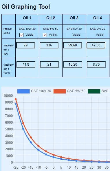

The diesel oils aren't bad. In fact, lots of people seek them out for high performance gas engines due to the higher ZDDP content. Here's how the cold viscosity of the 10w-30 diesel oil stacks up against motorcraft 5w-50:
Looks like the 10w-30 cold flows better than the 5w-50 in all but the most extreme conditions.
The only potential issue here is that the high ZDDP content theoretically could poison the cat converters, but I really doubt this is something you'll ever have to worry with. The phosphorus content is only about 25% higher than ILSAC grade API SP oils you'd typically use, but even that works in your favor in terms of engine protection. And even still, the Phosphorus limit doesn't even apply to the 5w-40s and 50s we commonly use so the Phosphorus content could be, and likely is in line with what many are already using in Coyotes.
Its been my understanding that the high ZDDP levels are only an issue for the Cats if there is significant blow-by.
And it isn't only the ZDDP, diesel engine oil has a much more robust detergent package. As I said earlier, that engine will probably be cleaner after the next oil change than it has been since it was new.

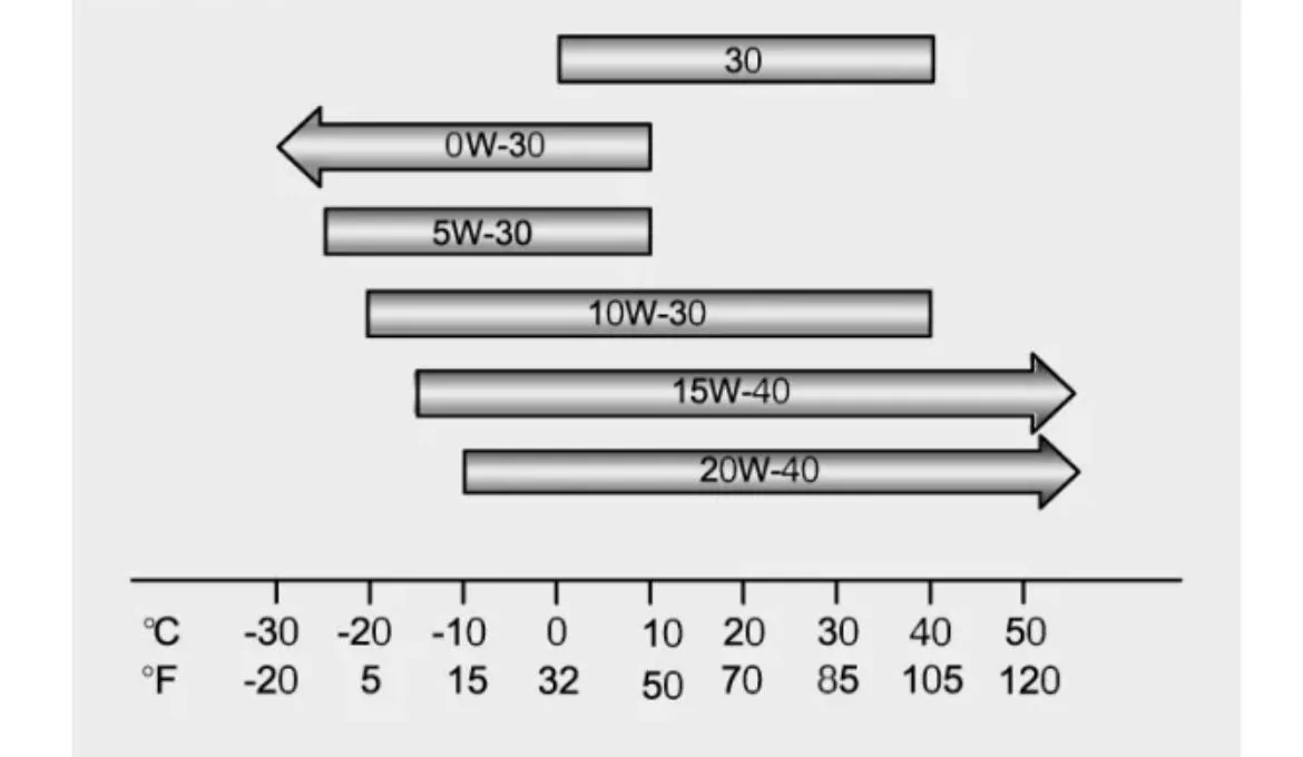

I would get the oil changed now and let Ford know what they've done. 10w is to thick for cold startup . I run 5w40 but I'm in Australia. I use Penrite oil which I believe is the best we have available.
