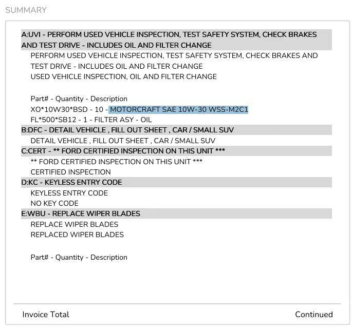

Garfy
Jan 4, 2021
965
608
Utah
Gary
2020 Mustang GT, 2012 Honda Fit Sport
I purchased a 14k mile 2022 GT from a Ford Dealership and after a month of ownership discovered that I have the Coyote tick. Nothing terrible, really loving the car but thought id check the service records of what was done prior to my purchasing of the vehicle . I noticed that the oil was changed and the part number for the oil shows "MotorCraft 10W-30 WSS-M2C1" which if I am not mistaken appears to be diesel engine oil according to the part number. Is this okay? Thanks
I think they got the viscosity wrong to begin with as the 2022 manual specifies 5W30 engine oil, not 10W30.
