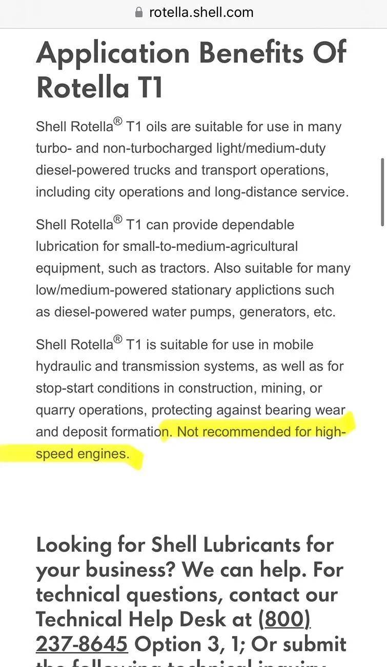

That’s what I’m also wondering, and what defines high RPM ?
You'd have to ask Shell. 2500-3000 rpm?
Here's a screenshot of their website talking about Rotella T1 (there's T4, 5, 6... so this obviously doesn't apply to all of them), but this is probably where those claims come from

Just looked at a bottle of T1 and it carries the SL API designation.
