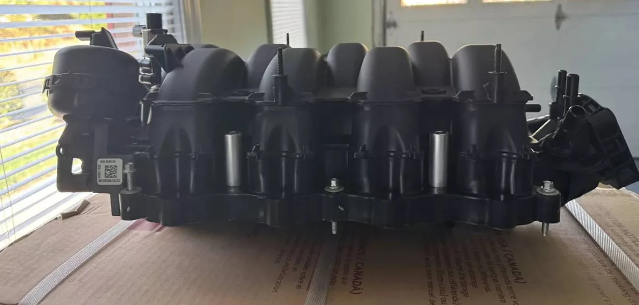

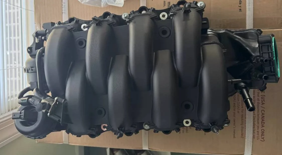

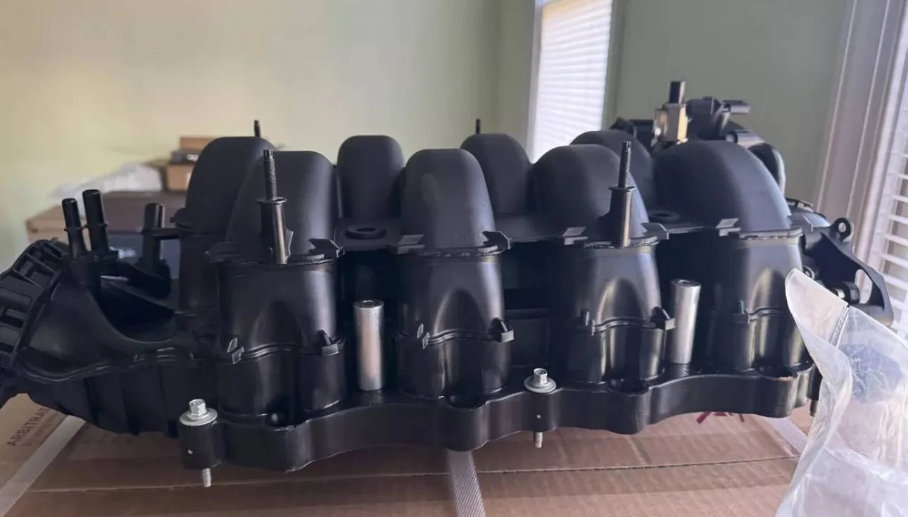

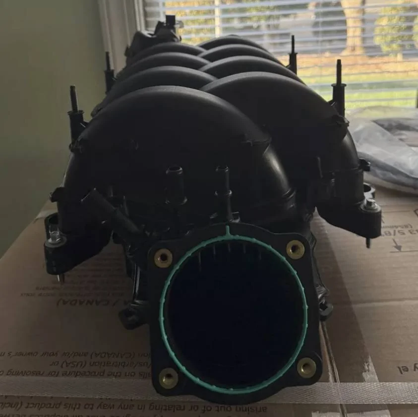

Only these, no bottom pics
NightmareMoon
Nov 22, 2015
7,210
6,506
Austin
2016 Mustang GT PP w/ Voodoo
That does look like the 18+ IM and definitely not the GT350 mani.
just make sure you have the hoses you need if you’re trying to use it on a non 18+ car. That one looks stripped of it’s lines.
