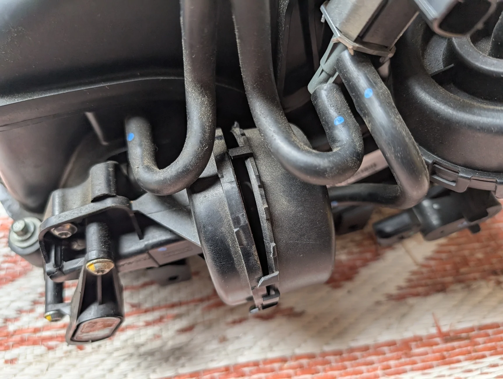

So I have a 2019 GT Premium PP2. I found a Bullitt intake finally. Well it was damaged in shipping.....specifically there are parts on the back that are damaged. I cannot find parts diagrams with specific parts on the intake manifold. Does anyone know of a parts diagram for the intake. Can anyone help me identify and possibly replace the part I have shown here....the plastic clips are broken off. Also I'm ignorant...what are the parts I am looking at. Are they parts of the AIS or emissions system? Can they be deleted?

that is the vacuum actuator you can remove the both of them and install lock outs for about $50.00 or you can find some that have put lock outs on and has the actuator cans for sale. I put on a 2018 manifold on my 2015 with lock outs so I have the vacuum system sitting here

Thank you....I have read about IMRC lockouts but I'm ignorant as I said....never knew what that was.
So since I will be getting a tune anyway to run the Bullitt intake, throttle body and air intake....I just buy a lockout kit and make sure I'm tuned for that as well I am assuming.
Thank you for your help.

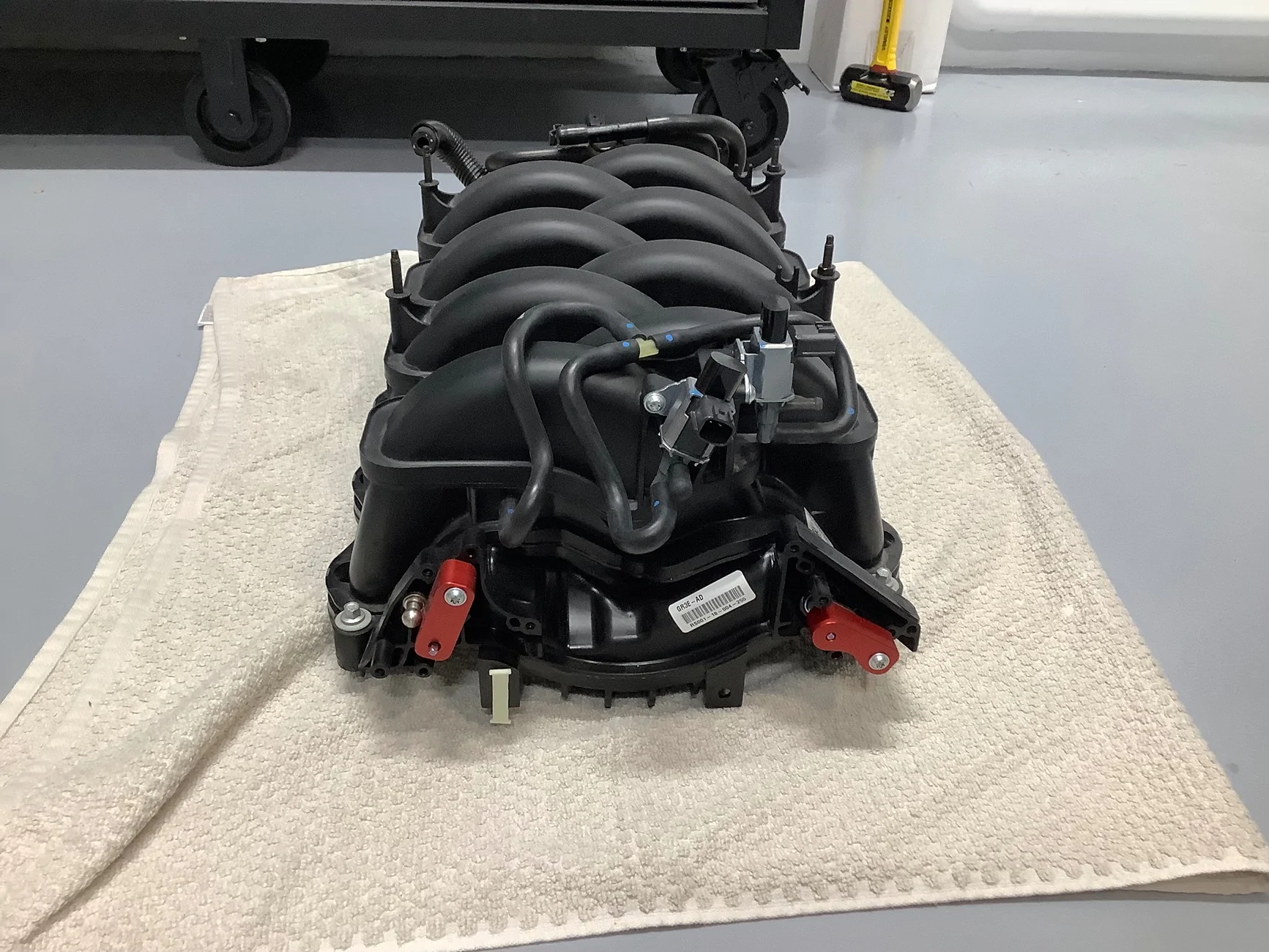

It is totally compatible with your manifold. It has never been used. It would come with the solenoids and vacuum lines and mounting brkts. $120.oo.

That's what I did. Lock outs are really easy to install. You can find you tube videos that will explain it all.

Yes, this is the way!

you can remove all of those vacuum lines and the relays. They won't be used with the lock outs.
