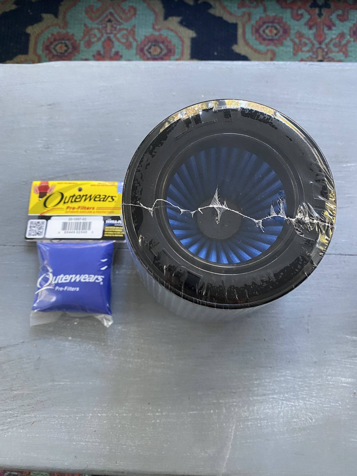

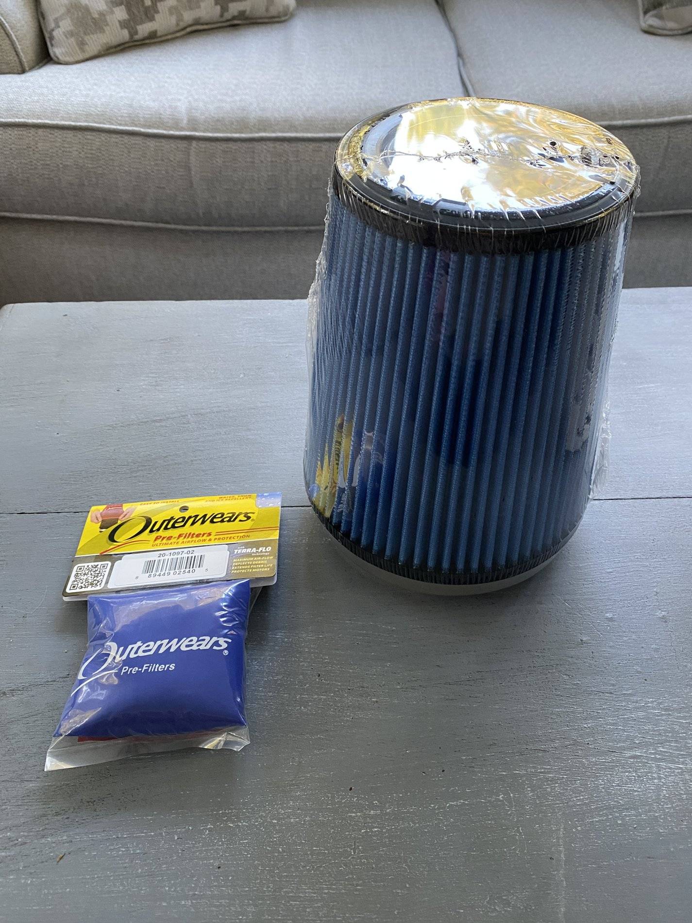

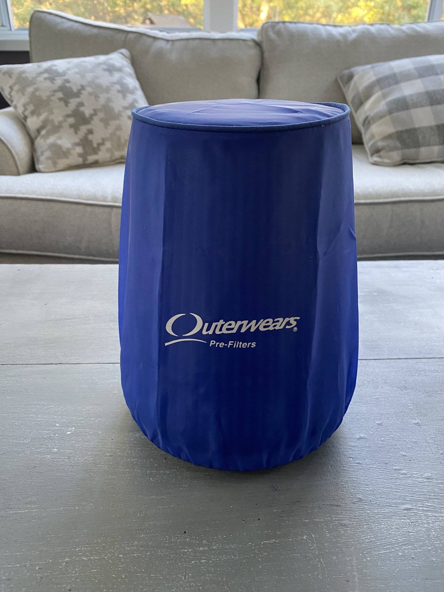

What prompted this post, is my car is at Shelby American getting the Signature Edition package. It will be getting a new hood which has two additional hood vents, one on either side of the OEM vent. This is going to increase the possibly of even more water entering the engine compartment. I wanted to find an alternative to my 1320 CAI, because I just don't want to worry about water. I also decided to follow the lead of others, mainly @kilobravo , and purchase a pre-filter. This will keep the filter cleaner much longer, and also repel any water that may make it to the filter through the grill opening, if caught driving in a heavy downpour. I also think this would keep the filter dry when washing the car, if I decide to remove the air box cover.
I only use S&B oiled filters because I like the additional open filter at the top. A friend of mine who owns a very successful supercharger company turned me on to them years ago. If S&B is the filter they choose to use in their kits, it's the one I will use on my cars.
Here is the "Powerstack" top
Outerwear pre-filter (part # 20-1097-02) installed
