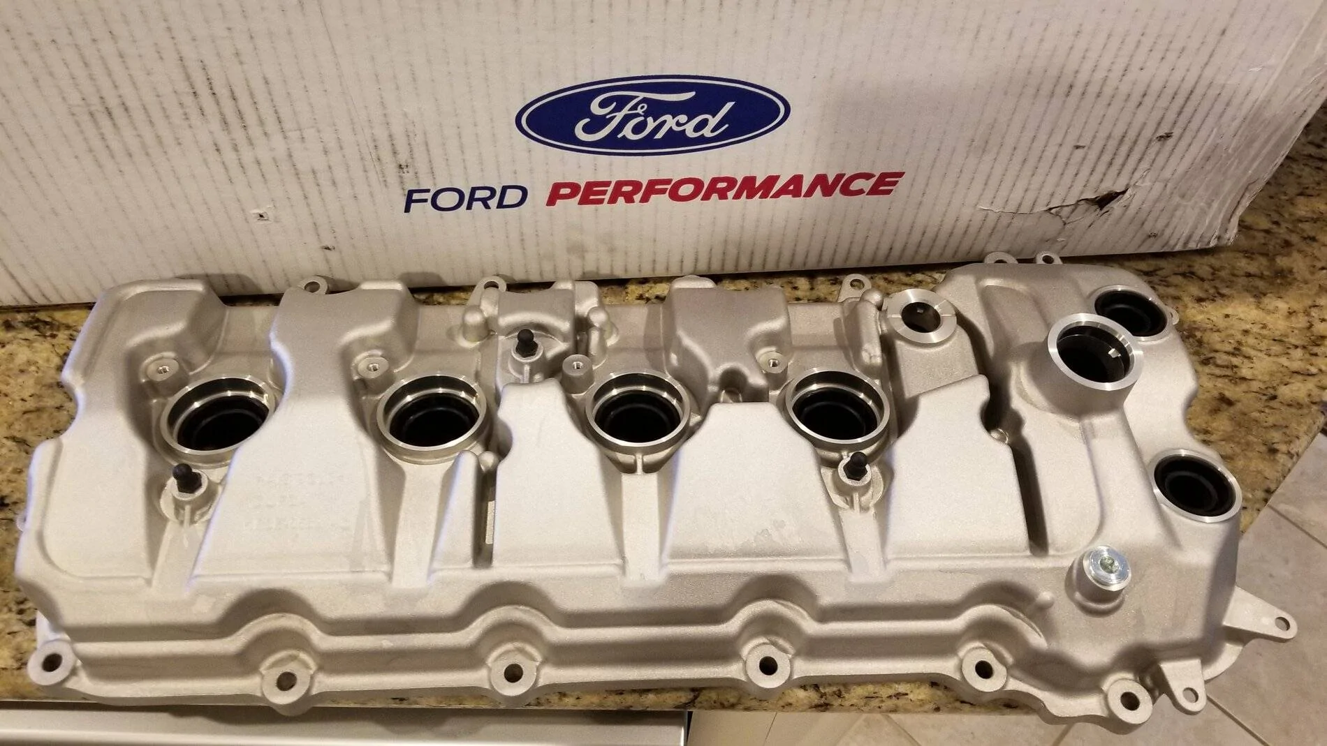

Has anyone installed these on their GT350? I just bought a set and plan on powdercoating prior to install. I have heard the oil dipstick needs to be changed out - can anyone verify and let me know a part number?

I run them. My OEM tube (not the stick itself) worked fine. I did have to upgrade to the GT500 stick and tube extension for the GT500 oil pan, tho.

I run the covers as well as the GT500 oil pan. In regards to the dipstick, you can run your stock tube and stick with the covers and oil pan for that matter.

Are you sure about that? I measured the stock tube + dip stick and the GT500 dip stick + tube + extension tube and found the GT500 combo to be about a half inch longer. Not saying you're wrong, just more that my measurements implied they weren't compatible.

I hear ya. Asked a Ford engineer friend about it. He said the depth of my stock dipstick does not change in comparison to any oil pan I would have chosen. The pan does not change the depth reading that the engine wants. As we know it just takes more oil to get there with this pan. The GT500 dipstick and tube can be used without issue but the change in design for the GT500 was specifically to clear the strut/k-brace on that model.
