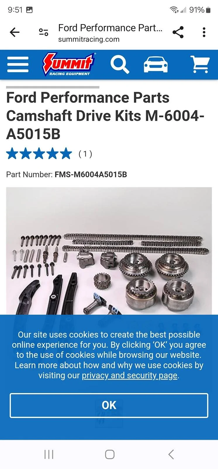

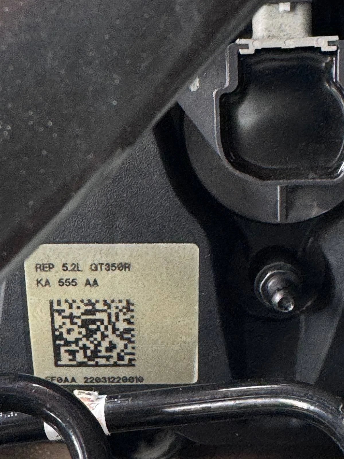

Hey guys, I own a 17’ GT350 but did get a gen 2 GT350R motor installed under warranty. I’ve been having some issues with a misfire and have cleaned and tested my injectors, replaced spark plugs, performed a crank re learn and cleaned my MAF sensor. The issue still persists and is now only doing it during idle. I am looking at replacing my Cam Phasers along with my VCT solenoids also gonna knock out my OPG & CS while that’s getting done. I am having a very hard time finding the correct phasers. I’ve found the Ford Performance set but they say they only fit the 16-18 GT350’s does anyone know what Cam Phasers & VCT solenoids fit my gen 2 Voodoo motor? Please help me 🥲

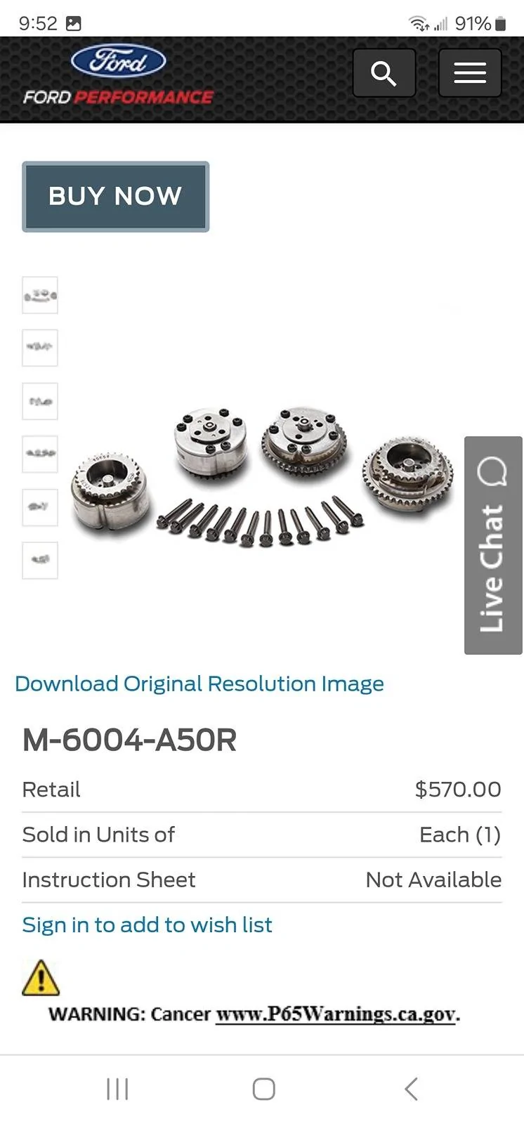

If it is Gen2 you want these.
