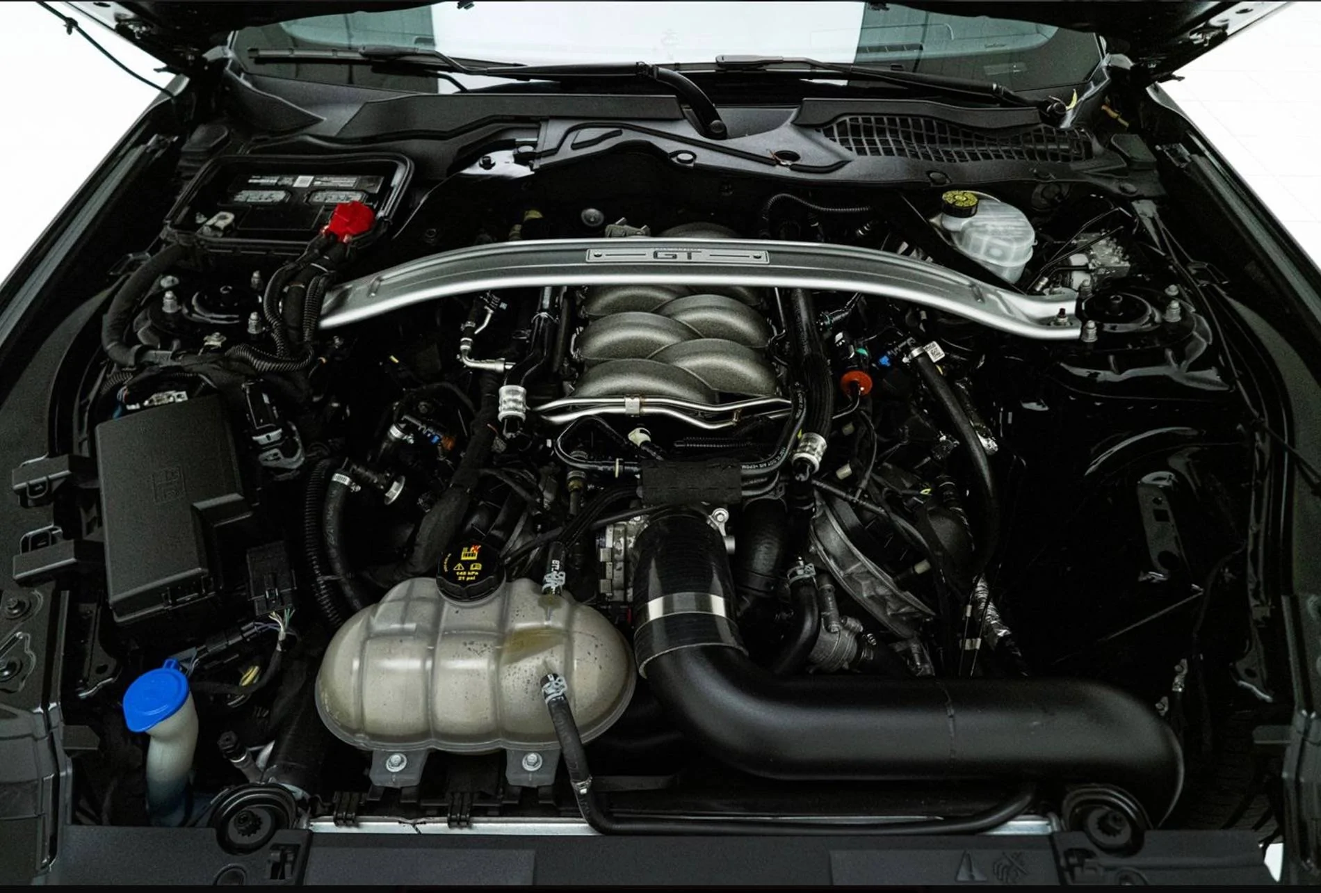

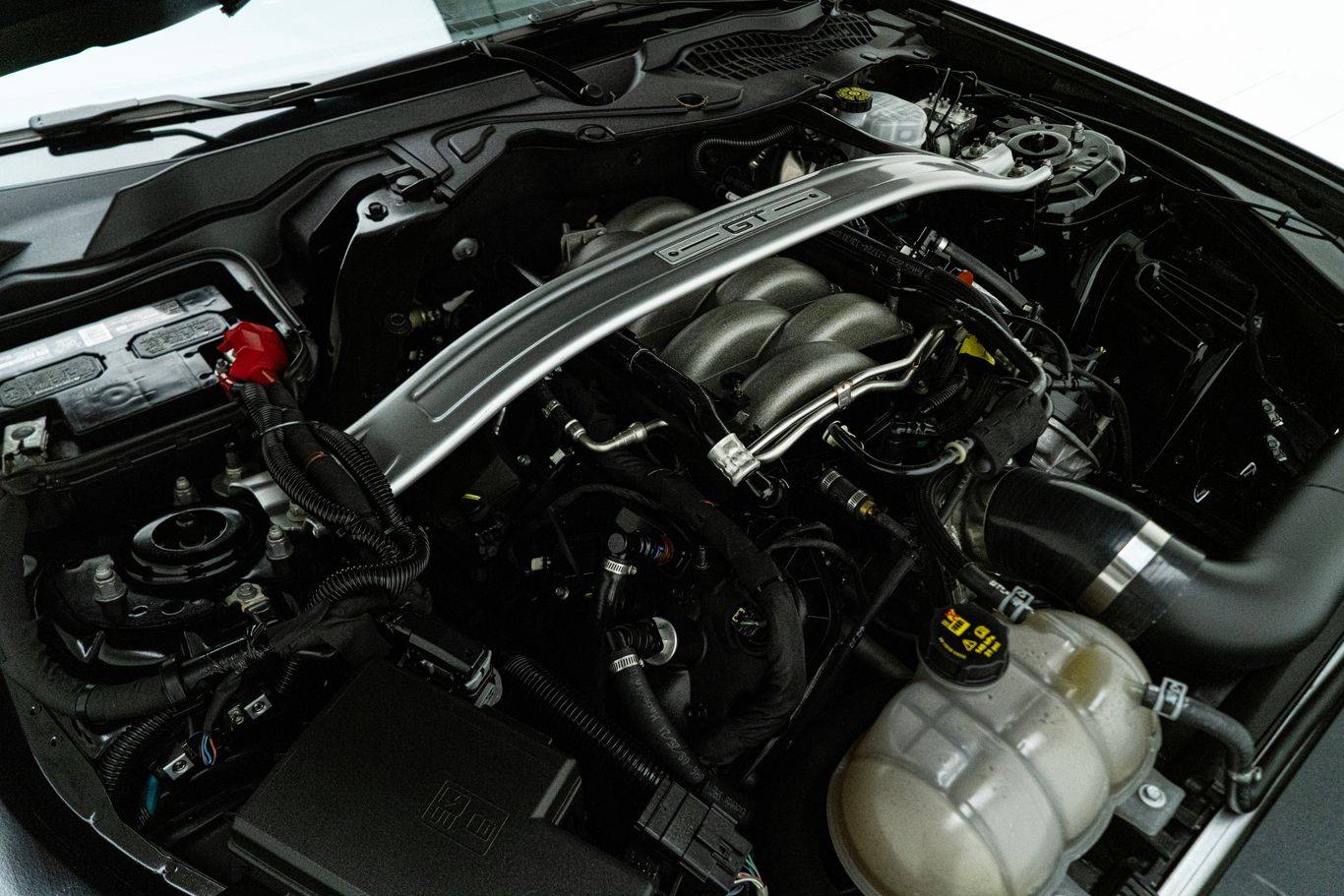

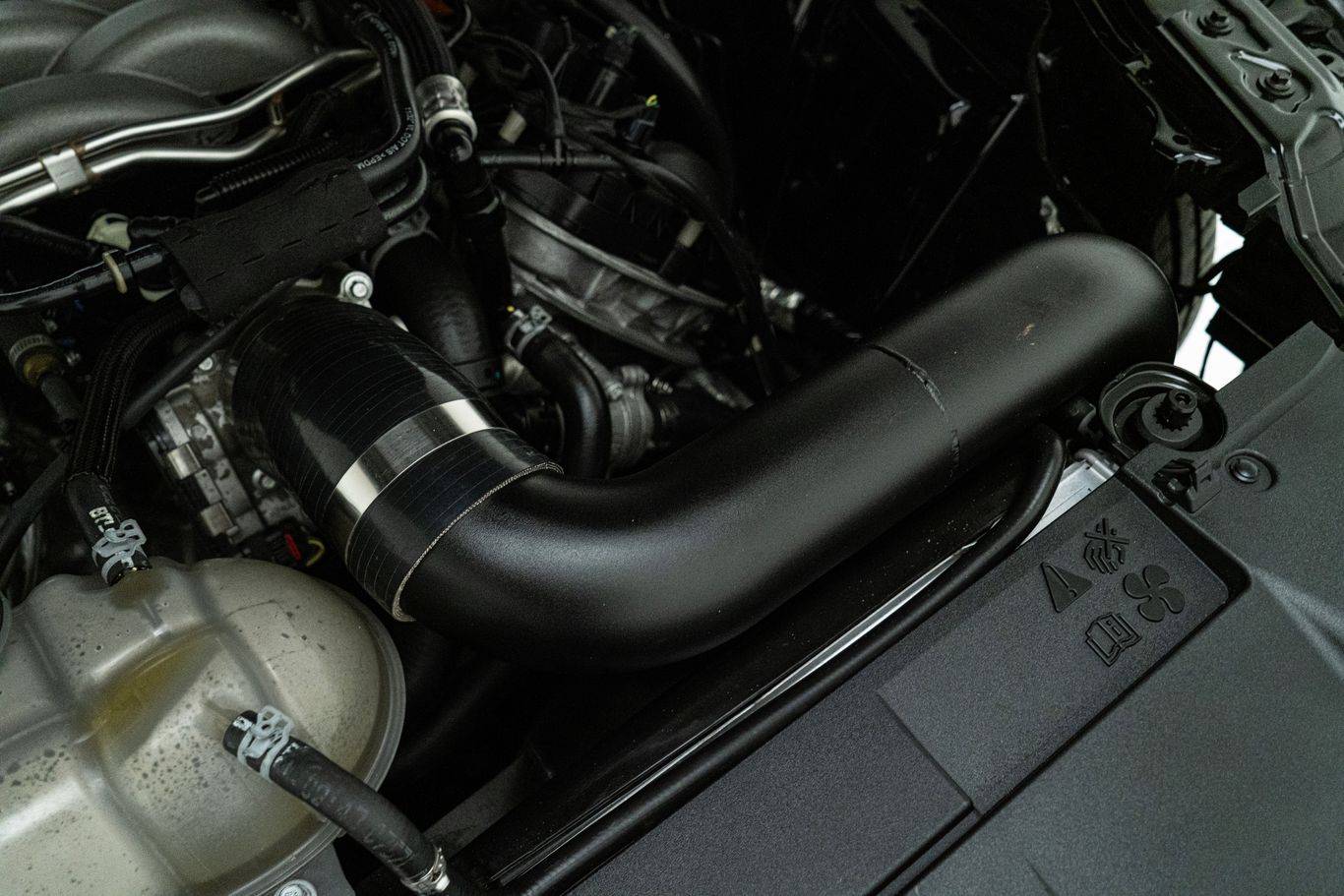

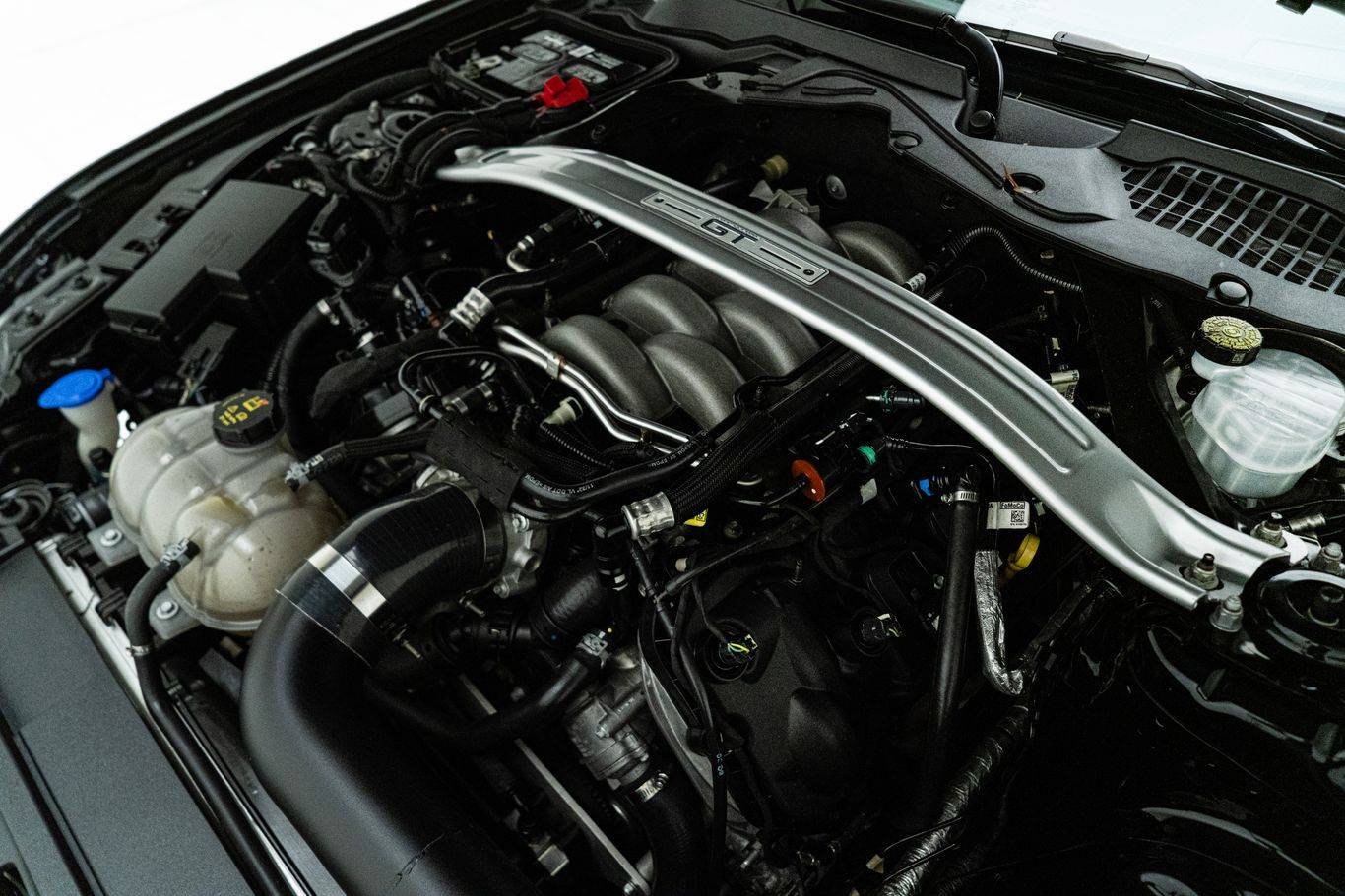

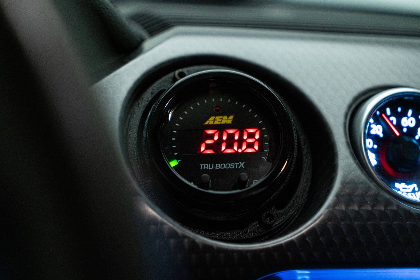

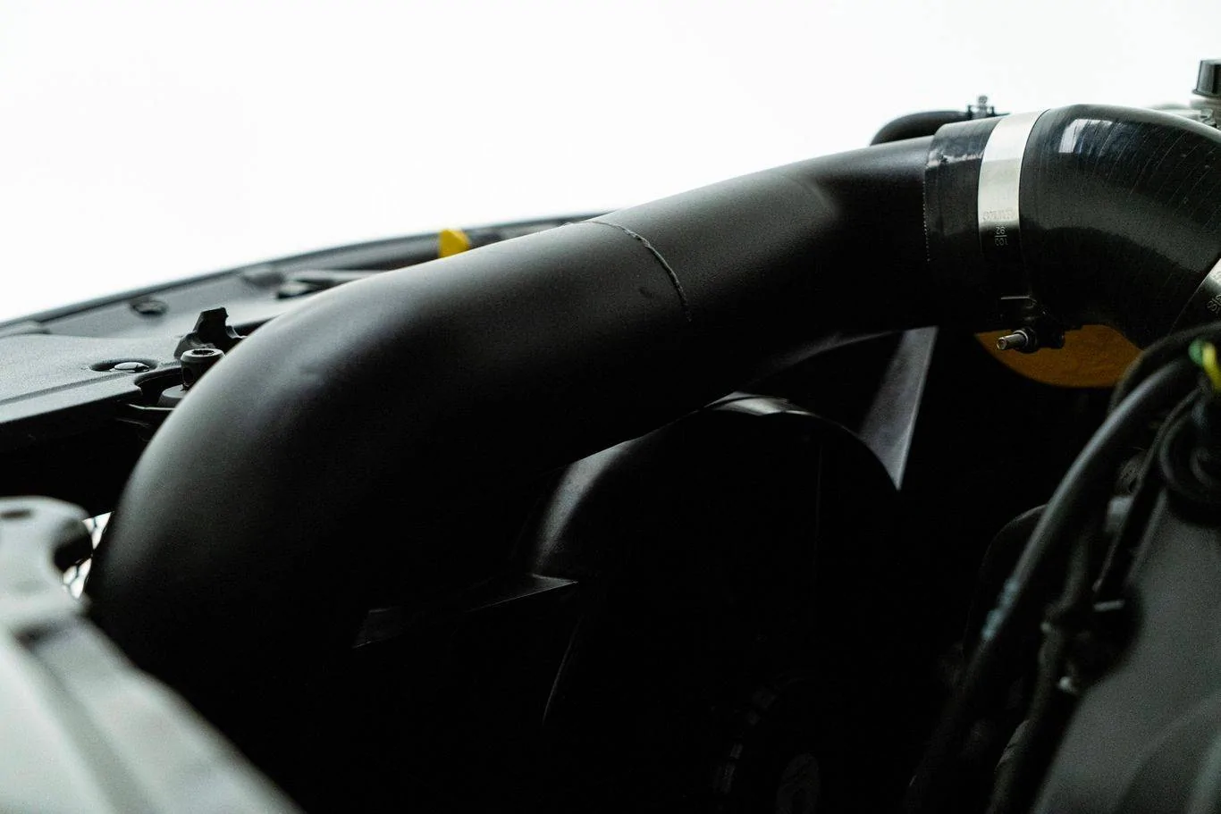

Found more of the photos from the advertisement of under the hood. You can’t see much as the turbo’s are mounted below, not top mount. I will get to taking more of the intercooler mount and turbo’s themselves. I need to check the air filers as I am only getting 9.75 psi rather than the tuned 10 max.
