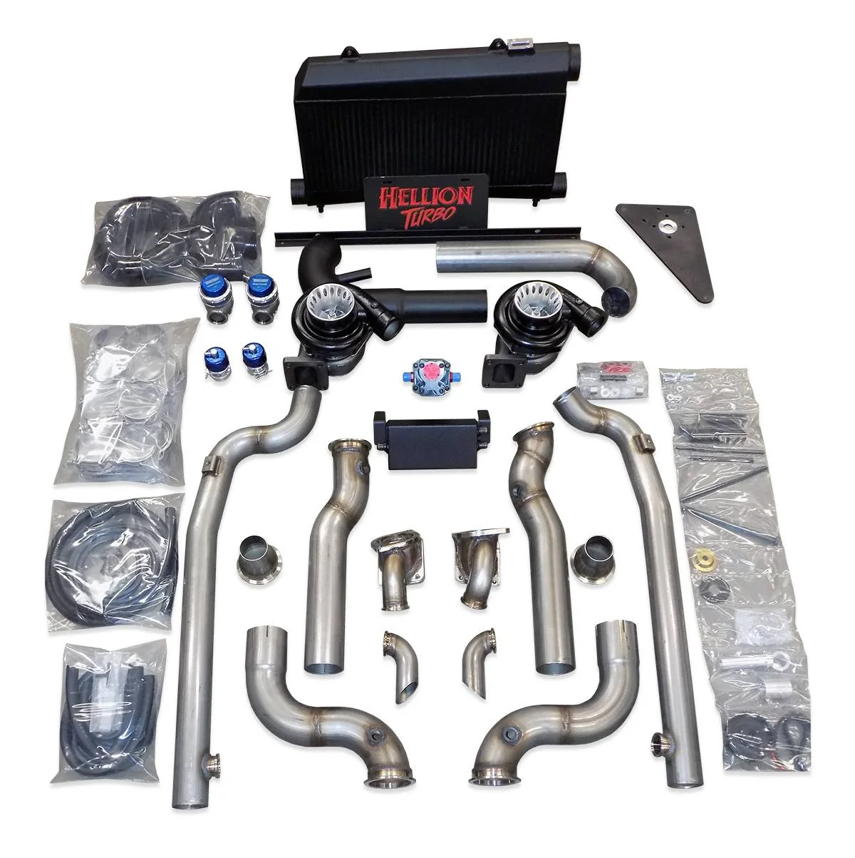

thanks for replying. it's hard to get user feedback it seems around here. anyway, for their sleeper kit, which components would be best to get cerakoted? i dont want rust if i do it....see pic below for components...

Rust shouldn't be a huge issue. All the pipes are under the car besides the inlet pipe which is coated black. Im in florida so rust isn't a huge issue cuz no salt.
