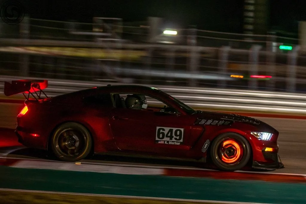

While I normally appreciate the sentiment of real data, you're just not going to get that. I've gotten 4.5 days out of OEM rotors with Raybestos ST43s and I've gotten 12 days out of OEM rotors with Raybestos ST43s. Difference? temps, tracks, my driving style, aero, etc. Only way you could *reasonably* test this as a normie is to only run the same track in relatively identical conditions, focusing on consistent lap times. And that would require many, many hours of track time. And THAT would be a VERY small sample size. All data here will be anecdotal.
Speaking of anecdotal, I initially wasn't impressed with the 2019 rotors because I started to see micro-cracks in only 1.5 days. But they've lasted very well since then. Have about 12 days on them now and they definitely haven't been babied (see pic below). Can't say I've seen any improvement in pad life as my ST43s always outlasted my cross-drilled rotors.

Damn, wish there was a better way to get cooling on those rotors

Agreed. This is with dedicated ducting, too. It's nuts.

My data says this pic is bad ass
