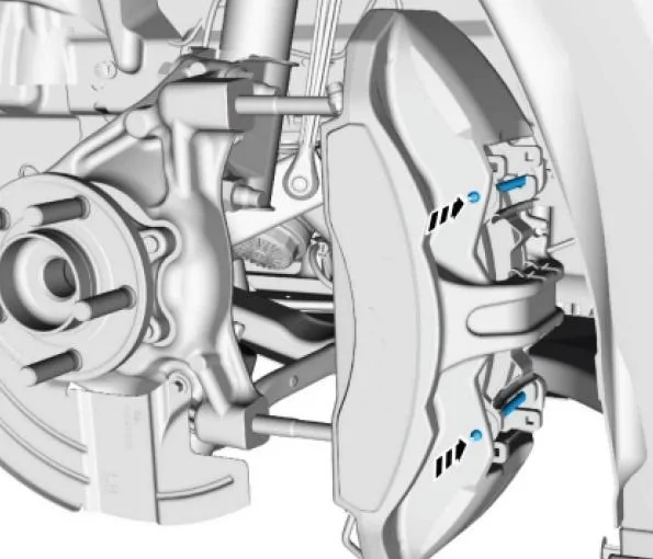

Not to go too sideways with this topic but is anyone beside me concerned with repeated removal & re-torqueing of the front caliper bolts? I don't have a good feeling about the aluminum threads lasting very long. I'd like to install studs in the knuckle and use high quality flange nuts. Opinions and other possible solutions (helicoils?) welcome.
Full strength inserts like THIS
You just need to find one that has the correct depth. They will not fail under most conditions. The Heli-Coils just do not last in Aluminum and usually unwind. It would take a fairly large run to produce studs and you would loose the ability to support the caliper during brake maint. You could design a stud with an internal threaded end that would allow an extension to be screwed on the end of the stud.
And I will add the stud needs something to bottom on, so it either needs a shoulder or needs to bottom out in the hole otherwise the stud has nothing to hold it in. In steel it's easy with just a shank but aluminum is more of a challenge. Not seeing one in person it appears the caliper mates flat to the spindle. The stud would be fairly easy to produce but just not sure how it would hold during repeated cycles just installed bottomed out with a thread locker.
The area for a nut is very small, you would likely need to make a capped nut with an internal drive (Torx or Allen) which would add cost and complexity to it. The spindles are only about $200 so would it be worth the expense to develop all new hardware?

^^^^ Thank you for the well-thought assessment of the caliper attachment options. Your last point about the replacement cost makes me less worried about this down the road. I'll continue to take care when servicing the brakes per GT Dave's comments and replace the knuckle if/when I ever have trouble. Thanks!

We include thread locker with the pads we sell but honestly I would personally use anti-sieze on a track car where I am in there very often changing pads. We just can't really go there because we can not control the public doing something stupid, like not inspecting threads and using a torque wrench. 136ft/lbs is pretty stout torque. As long as you keep dirt and old thread lock out of the threads I doubt you would ever have an issue with either method. At the track you could just use a piece of vinyl tubing to blow out the holes if you don't have compressed air. Make sure the bolts are clean going back in. Standard "Mechanic Practices" you could say :)
