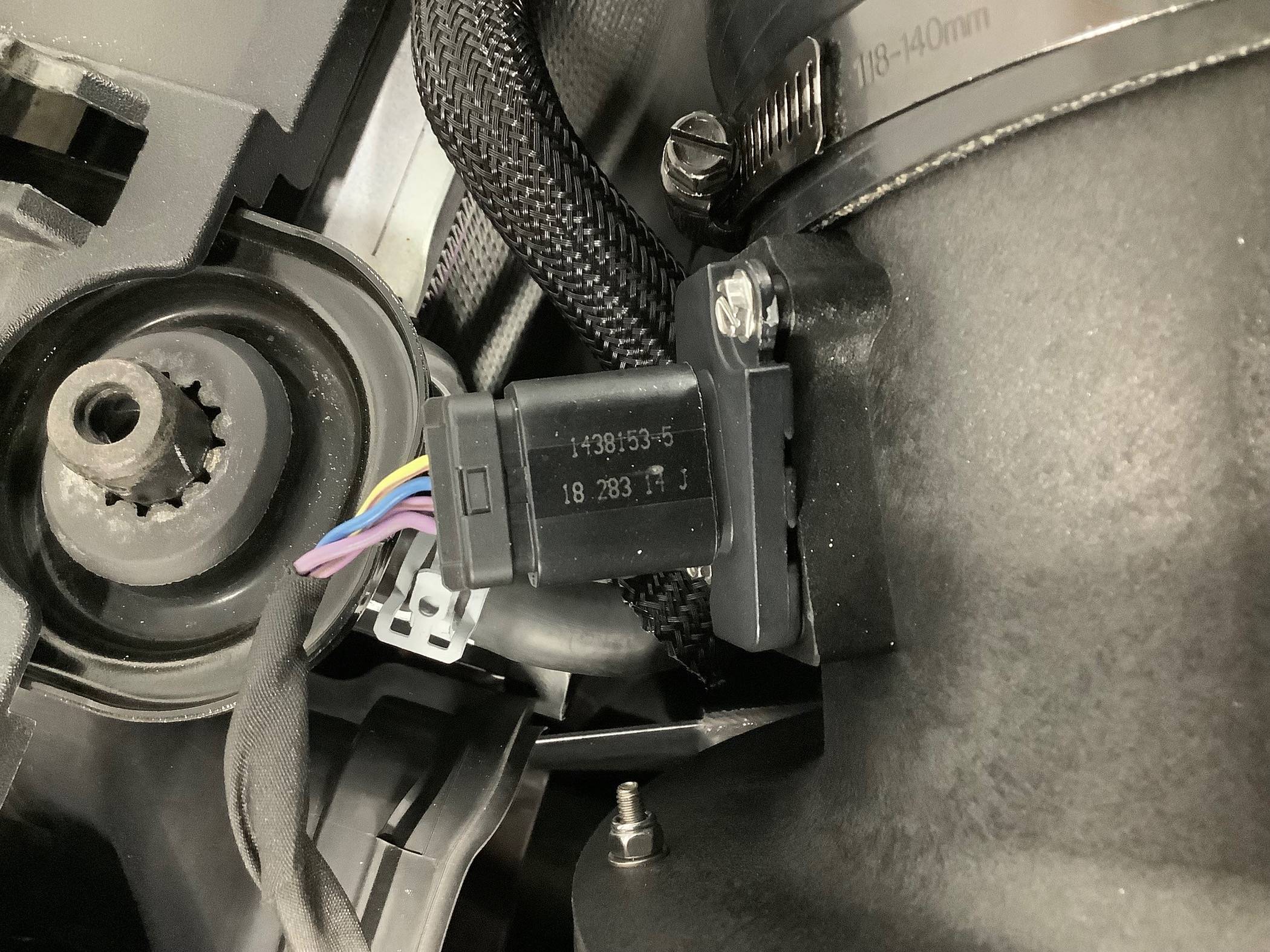

Someone else mentioned checking for vacuum leaks too. I have a PMAS (no tune required) on my 2019 Bullitt which came with a new MAF sensor. My IMRCs are also locked out. Something else that comes to mind is, maybe the previous owner locked out the IMRCs and did not have the tuner turn them off in the tune. When I locked mine out, I had to pay an additional $150 to have the tuner turn them off in my tune. I never tried to run the car without the IMRCs turned off in the tune, so I don’t know if the car would or wouldn’t even run without them being turned off.

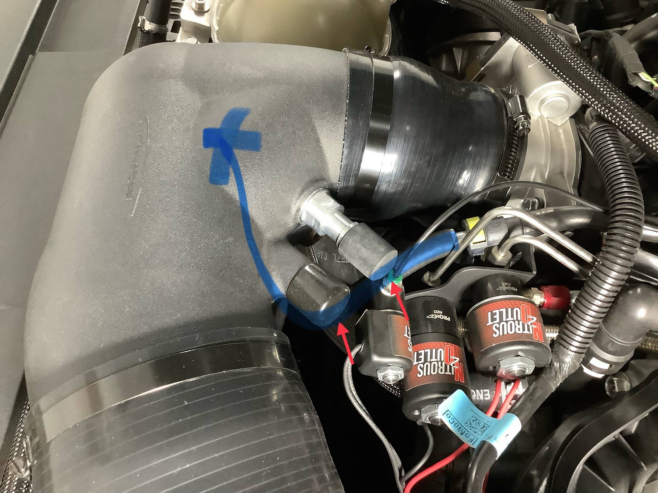

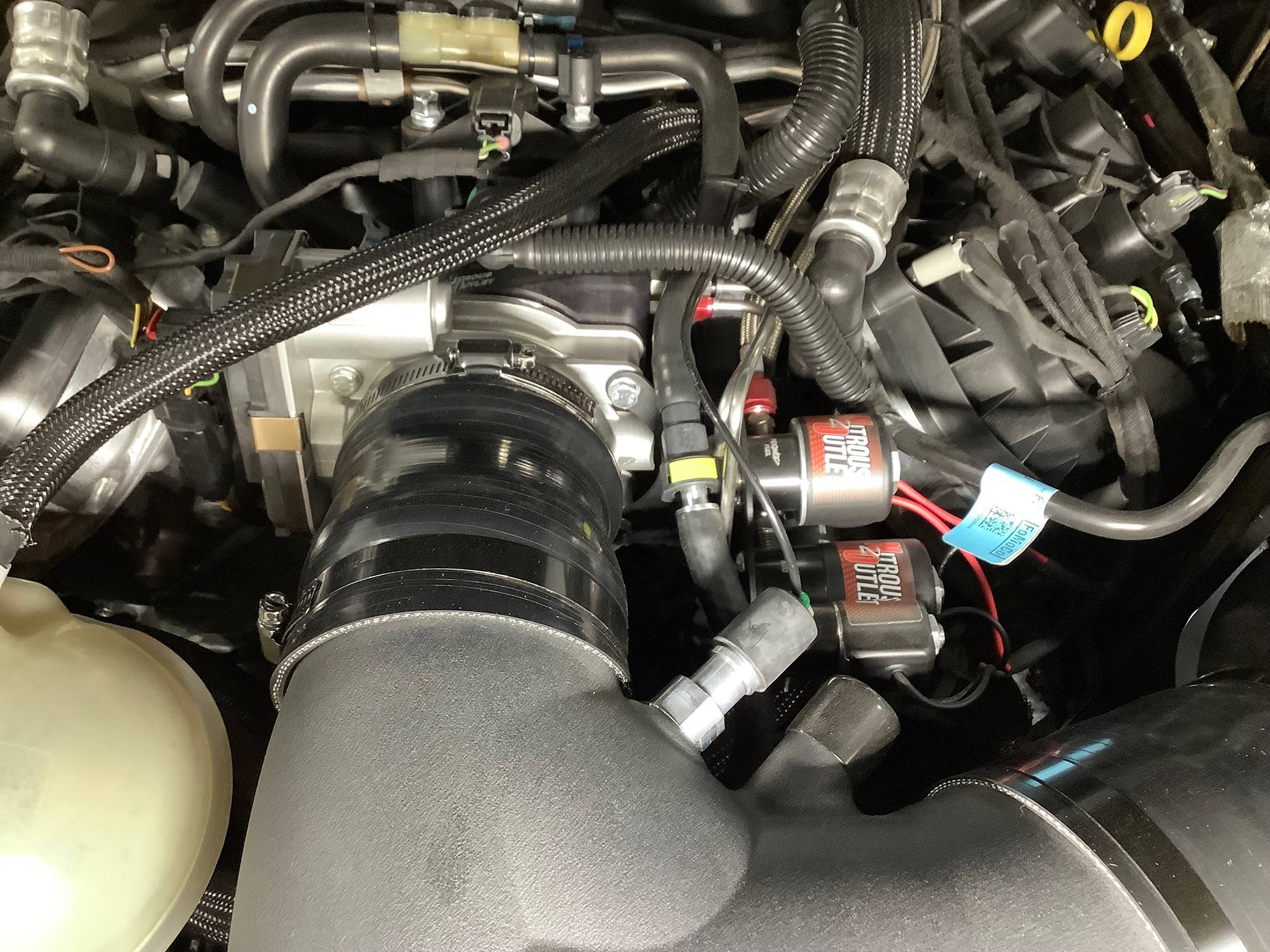

Can you post pics of your CAI and intake manifold, so we can see if you have everything plugged up? If not, here are some pics of my PMAS for reference. I have red arrows pointing to the two ports on my PMAS that are capped off. Also, follow the blue line that I drew on the hose and placed an X on the CAI tube to show where it should be plugged into a 90 degree elbow on the bottom of the CAI tube. Lastly, if your MAF sensor has the same part number as the one shown in the last pic, you have the PMAS no tune required version.

Something else I just thought of too is you should unplug the MAF sensor and remove it from the housing and confirm that the gasket is in place and you’re not sucking unmetered air. While you’re at it, spray the sensor down really good with MAF Sensor Cleaner before reinstalling it.

I appreciate your help so far. I am currently at work and did not drive the car today, but I will post a picture of the engine bay with some close ups when I get home. In my original post I mentioned the dealer was concerned about the battery, but it tested to 78% life at 12.5v, sounds like its still in good working condition.
Adding on to your picture, the two ports you shown being capped off is not the same as mine from what I can remember. One of the ports has a connection with either a hose or something else connected. Not sure if that means anything or not, but figured I would throw it out there. Doing my best to learn as I go!
You should be able to configure the tube different ways if needed. It’s been over 3 1/2 years since I installed mine now and it seems like I might have removed a plug at the bottom and installed the supplied 90 degree fitting with hose barb to attach that hose to. That’s easy enough to check by looking on the bottom of the tube to see if it has a block-off plug. the main thing is to ensure you have no leaks in the system. My PMAS came with multiple fittings and I only used what I needed to, in order to avoid interference with my nitrous solenoids.
