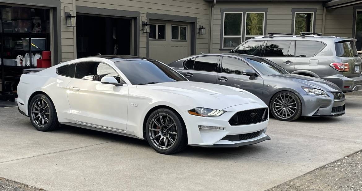

Pretty sure the *easiest* track setup is a 285/35/19 SuperCar3 on an Apex 19x10 square setup (no spacers). Rotatable, great grip, waaaay better than stock. I burned up the PS4S in 2 track days before the SC3 setup.
Steeda dual-rate springs doesn’t lower the car much *at all* I’m actually disappointed in the drop, but they handle phenomenal! Just like stock, until you click it into track mode and hit some corners.
This is what it looks like.
Not exactly my cup of tea, but it works great for the track.

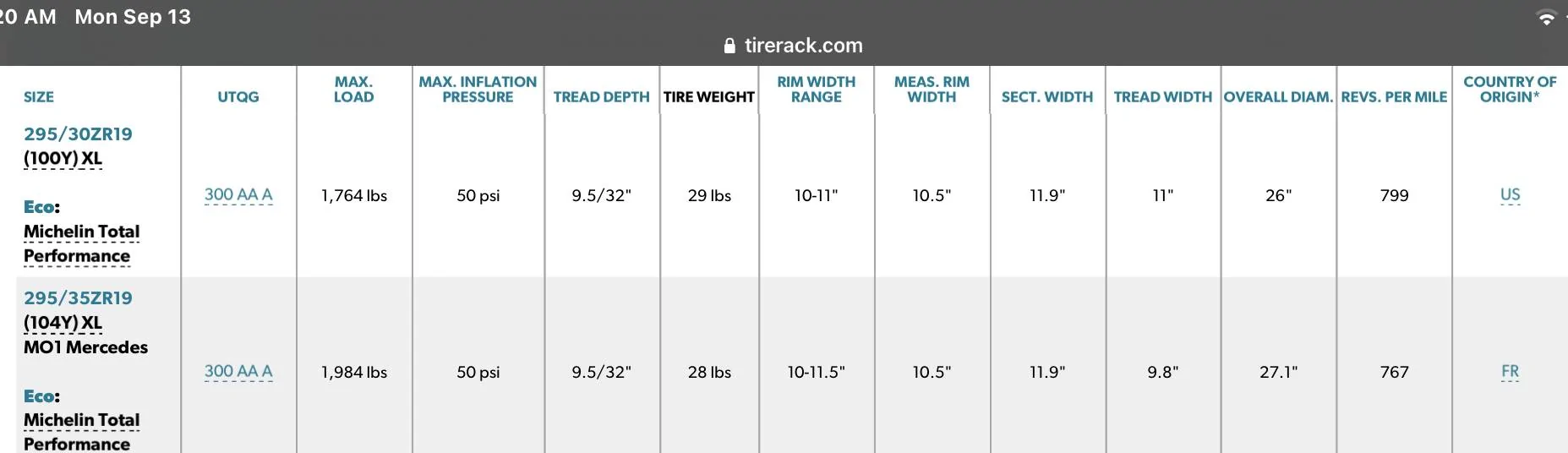

I am going with set of Michelin Sport 4S in a 295/35-19 all around.
I would recommend against that regardless of the size wheel you go with. Those are Merc OEM tires and the tread width is smaller than the 275 PS4S that come with the PP1 cars. Either go 285 or pick a different tire.
