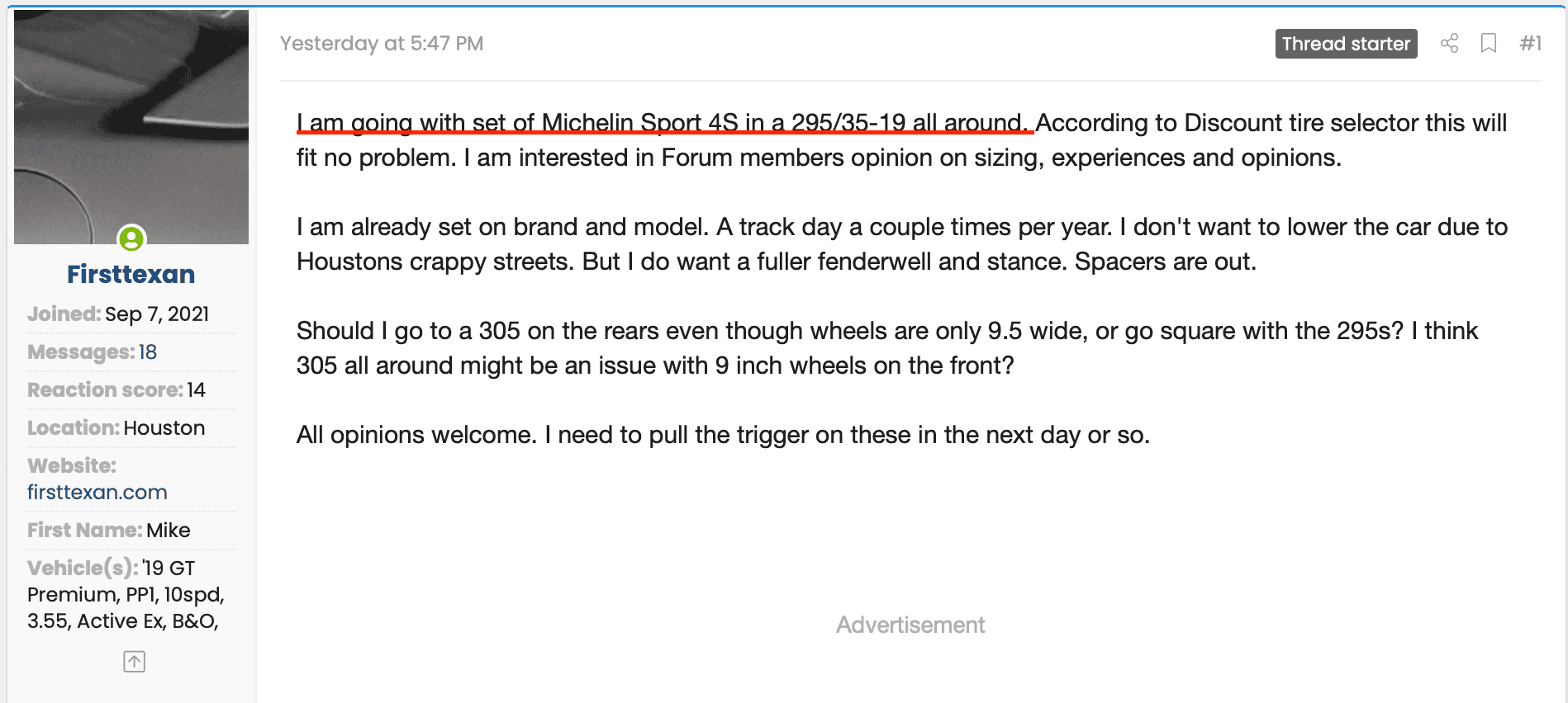

As others already said a 10" wheel would be better for 285s. What are you trying to accomplish with the new tires? Just the wider look? Is traction important to you? Personally I wouldn't change tire size at all unless I can do so while keeping the sidewall the same or taller than stock.
Keeping an eye outer diameters should accomplish that. The previous owner put 255/40-19 PILOT SPORT ALL SEASON 4 on the front.They are new. The back has PS4S on it. They will need replacing soon. I am thinking of selling the fronts and starting fresh. I like the PS4S.
Just trying to find the best setup before I buy. Going with stock size seems to be the way. New wheels are not on the agenda. Beyond that I am just looking for a wider stance. It seems that to optimize a larger tire for the GT will require a different set of wheels.
I will sell the all seasons on the front and put a set of PS4S in stock size.

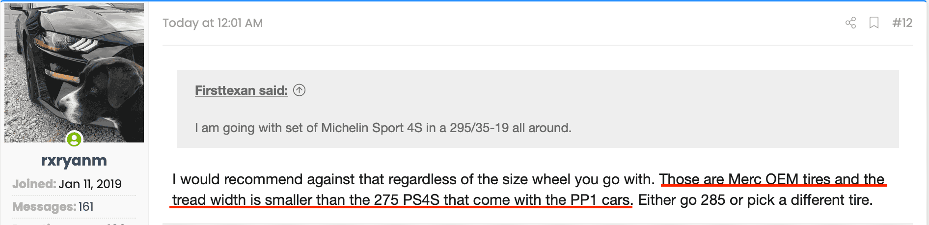

I would recommend against that regardless of the size wheel you go with. Those are Merc OEM tires and the tread width is smaller than the 275 PS4S that come with the PP1 cars. Either go 285 or pick a different tire.

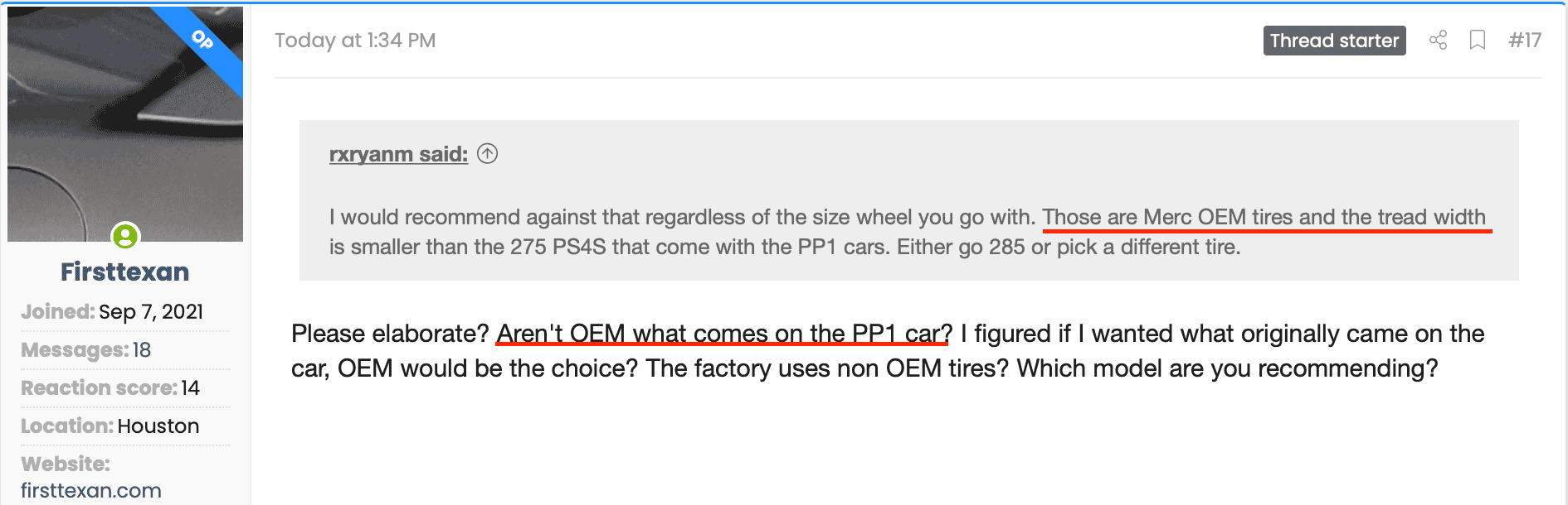

Please elaborate? Aren't OEM what comes on the PP1 car? I figured if I wanted what originally came on the car, OEM would be the choice? The factory uses non OEM tires? Which model are you recommending?
OEM are what comes on the car, but unless your Mustang was manufactured by Mercedes, Merc OEM means they didn't come on your car. They were made by Michelin for Mercedes.
I'm recommending you don't go with 295/35. That's it. I love my PS4Ss personally and would stay stock PP1 size if I kept them on year-round.

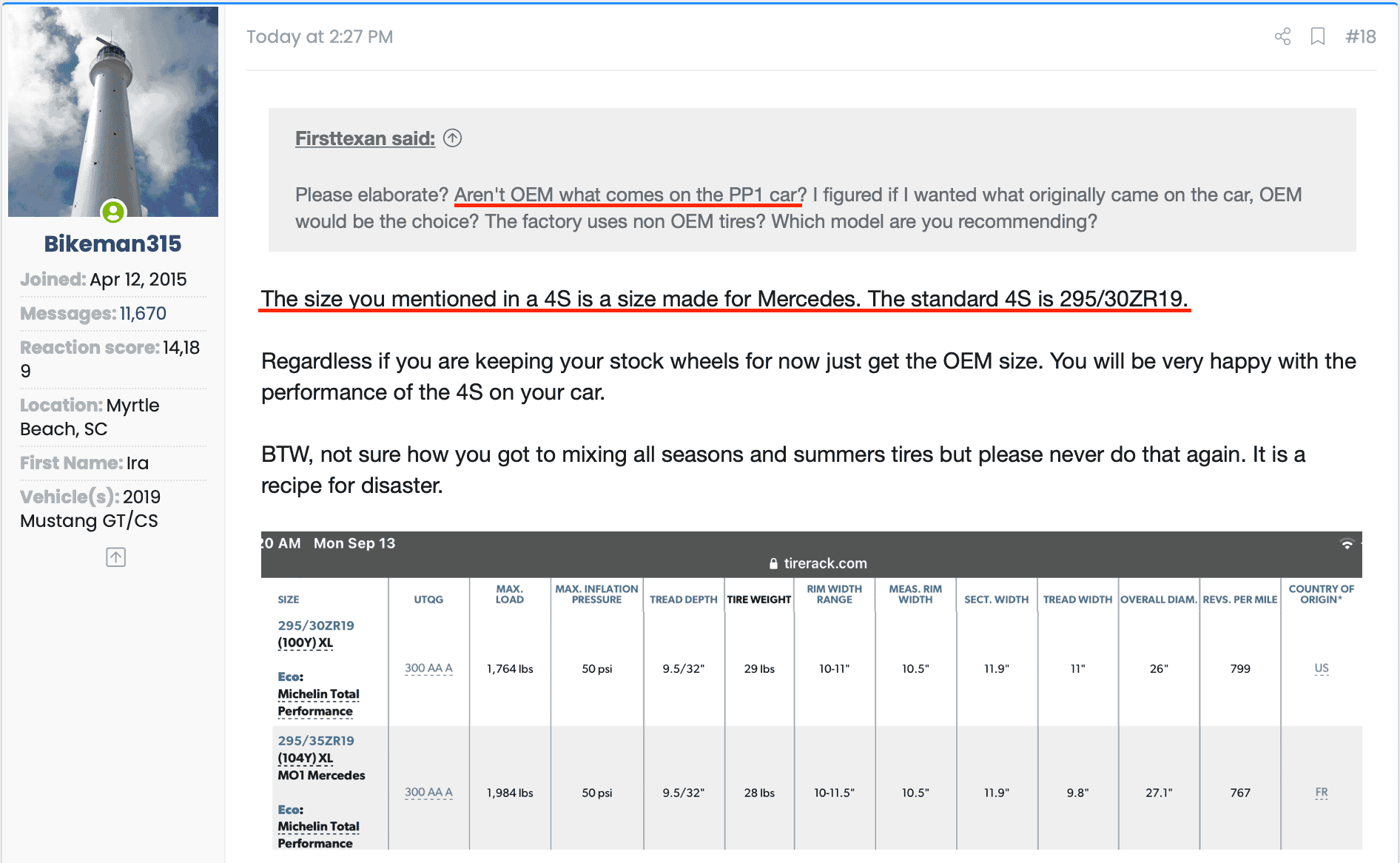

Funny you mention condescension, yet call me sonny. I don't mind being younger than you, means I know how forums and the internet works.
(Emphasis in the upcoming pictures all mine cuz it's obviously needed)
Original post:

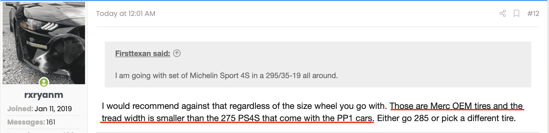

My response keying in on one very specific part of your original post:
Your response:

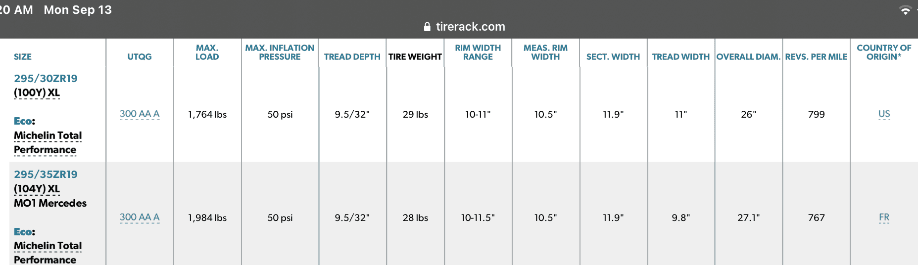

Ira's statement after I said 295/35 aren't as wide as 275/40 that you seem to think I said:

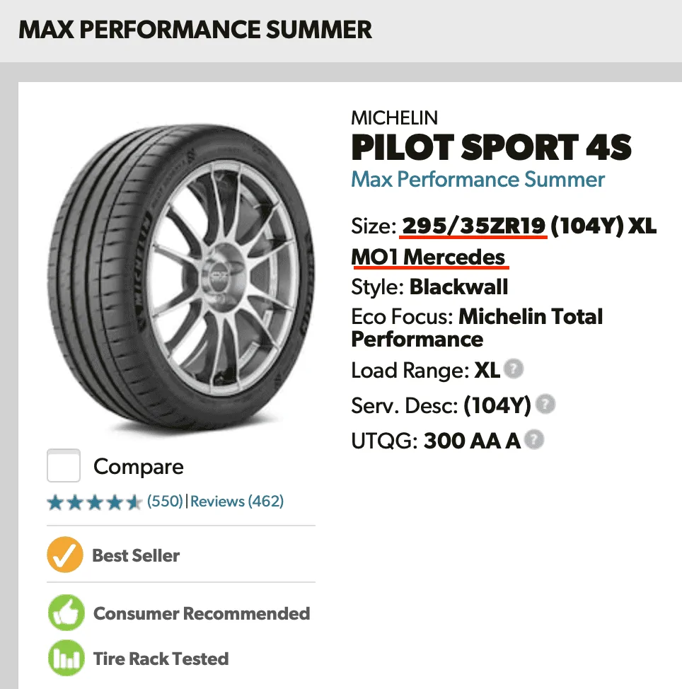

This is where Mercedes comes from:
Let's review. You wanted initially 295/35r19. I recommend against them because they are made for Mercedes (Mercedes OEM) and have a smaller tread width than stock PP1 sizes. Then you get hung up on me calling them Merc OEM tires. In no way, shape, or fashion was I "running you around". I was telling you my experience, because I've already bought and returned a set of 295/35r19 because they didn't fit how I anticipated. It's not my fault your reading comprehension can't keep up.
Original post:
Your response:
Nothing but helpful, not my fault you think I was coming across as hostile. I was answering questions.

Now help me with this. You say the tire I am showing is not for my car? Please help me understand what's missing in the search?
I can certainly understand the confusion about this. Michelin manufactures different versions of its tires for different car companies. Turns out that the MPS4S in the size you originally asked about is a Mercedes spec tire. Can you see my graph in post #18? Notice the word Mercedes on there. That tells you the tire was made for Mercedes. That doesn't mean you cannot buy/use it but the 295 spec for our cars would be the 30 series, not 35 and gives you more tire width. Hope that helps.
Check Tire Rack for more information. They are a better source than Discount Tire.
https://www.tirerack.com/tires/brand.jsp?brand=michelin
Also notice how many different versions of the the MPS4 there are:
