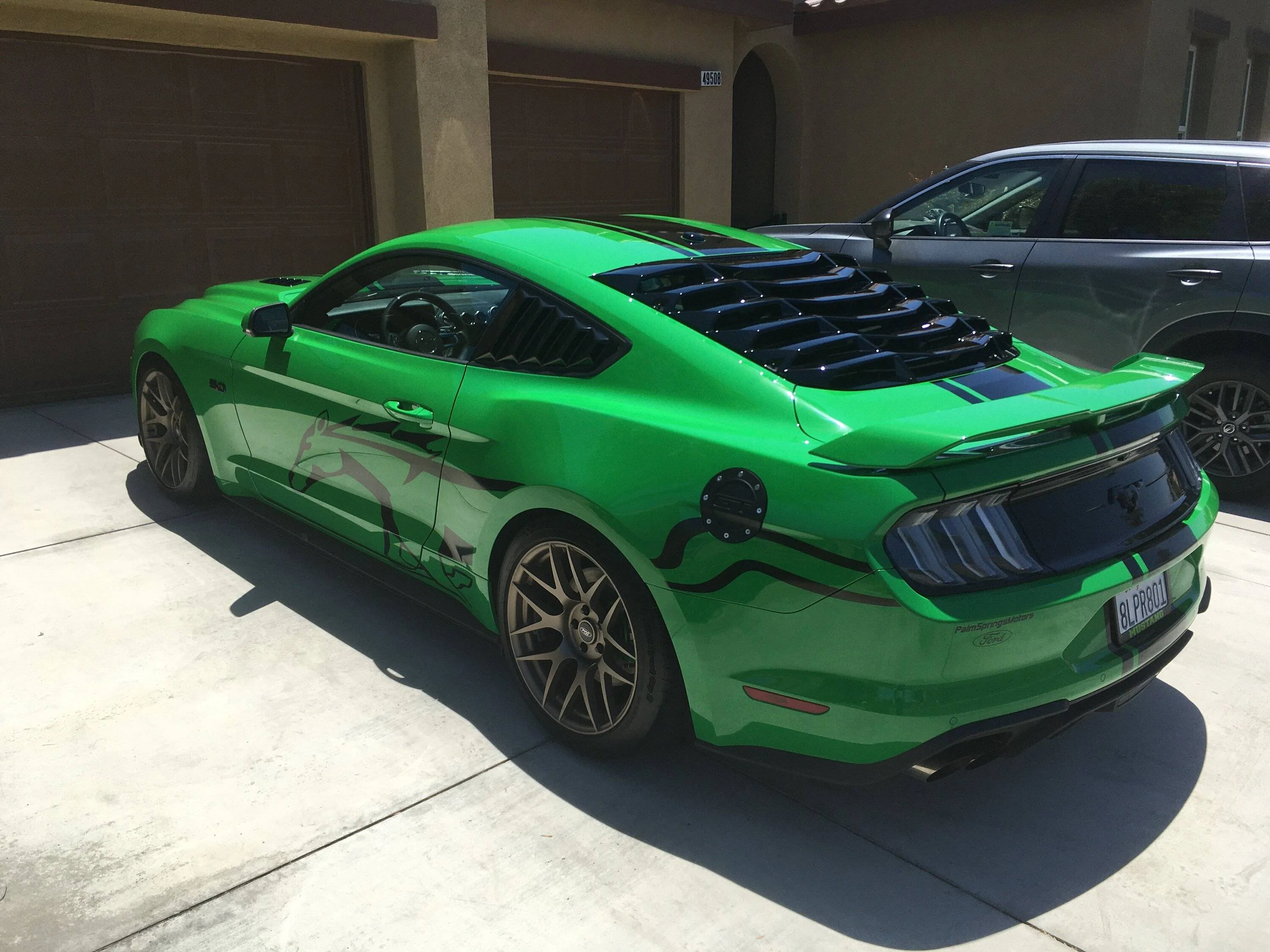

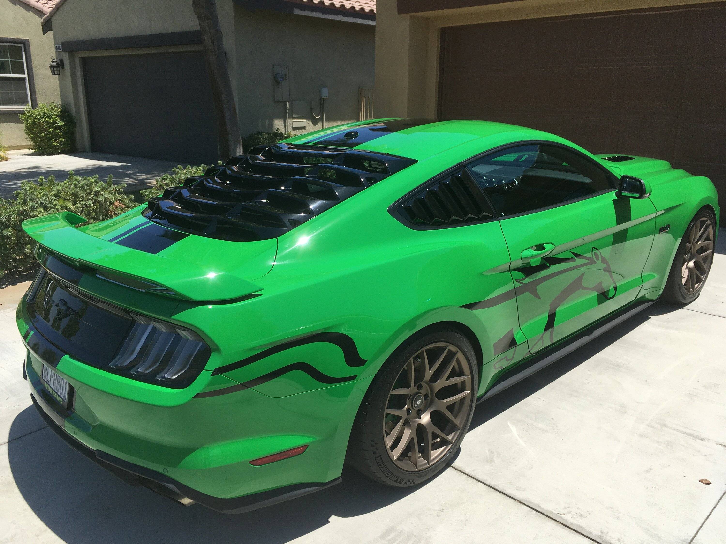

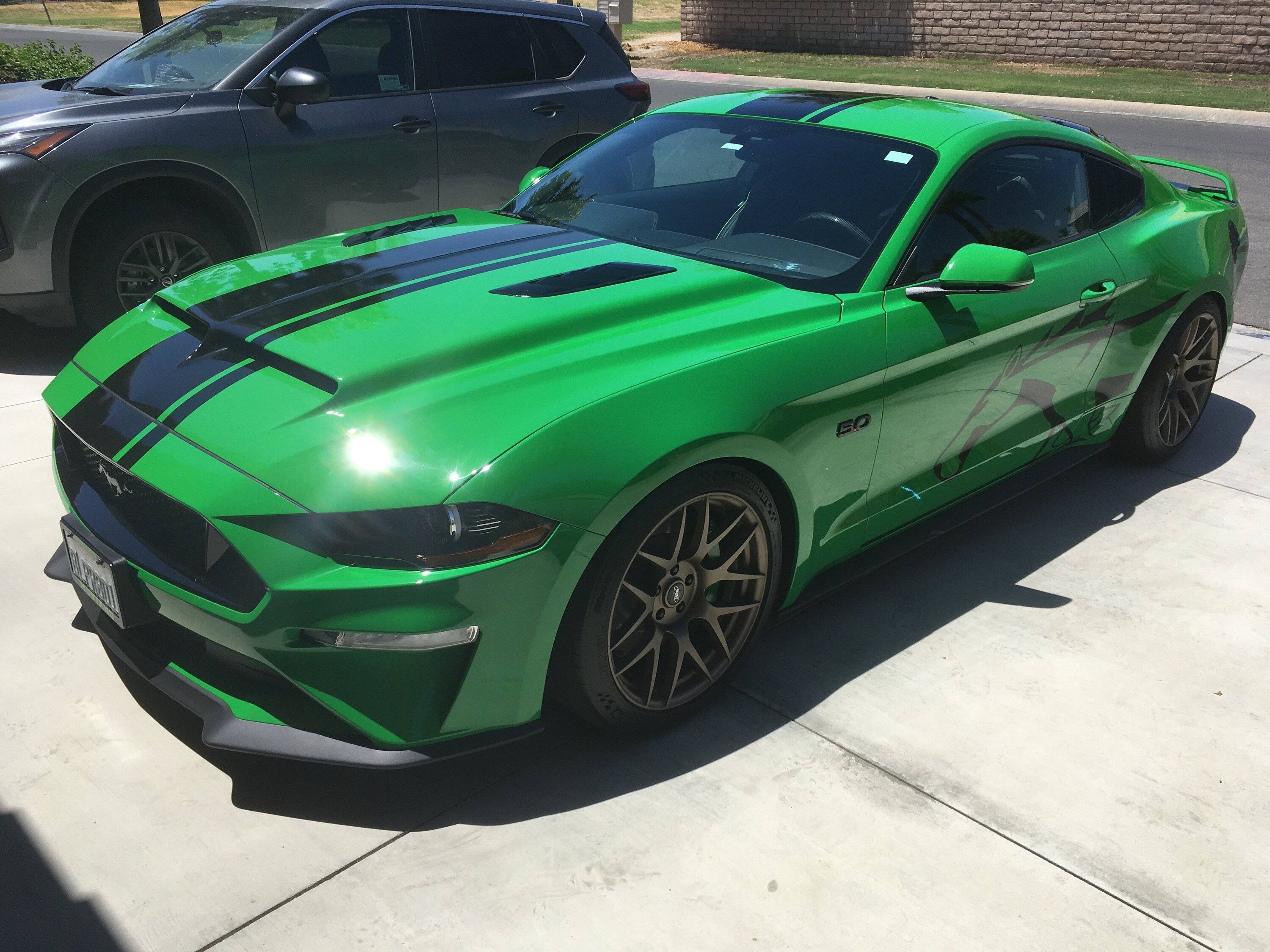

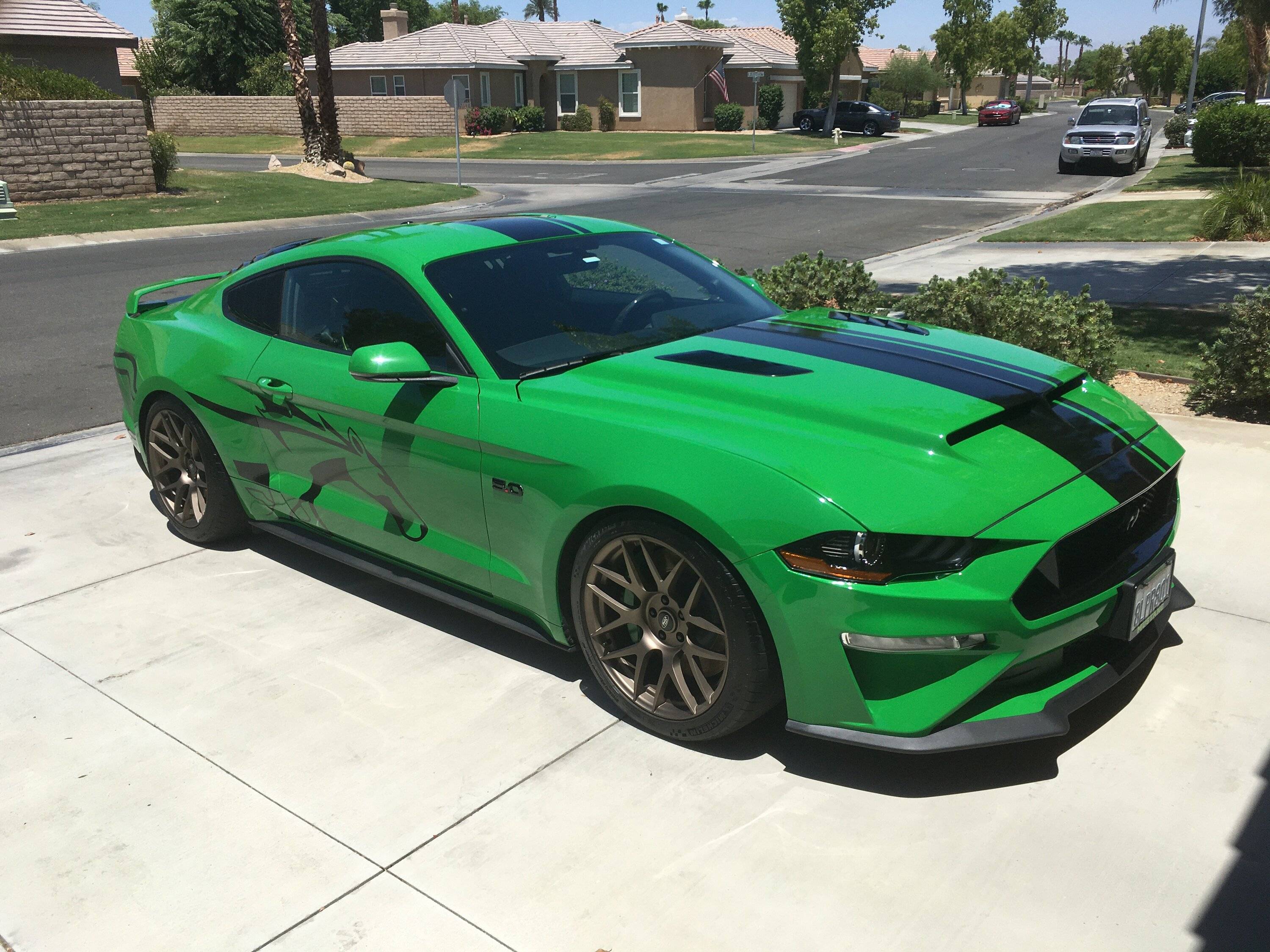

Don't have a problem with the mix. The PSS on the rear give good traction for acceleration and cornering and you all ready know how the PS4 feel on the front.
Here are the pics of the car. Haven't really taken any that show the car on the level but these may do.
