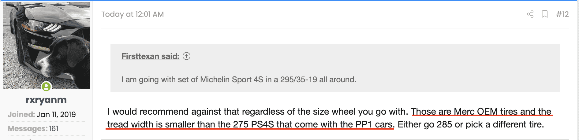

Now help me with this. You say the tire I am showing is not for my car? This has me totally confused. I guess you were saying the 295 was actually smaller than the 275 p4s and not for my car?
That was just me referencing back to you saying you wanted 295/35s. I don't really get how/why they're that way, but yeah - I was just saying 295s are smaller than 275s. They'd honestly probably "work", but I think sticking with a 275 is the move and looks really good on the stock PP wheels.

I am going with set of Michelin Sport 4S in a 295/35-19 all around. According to Discount tire selector this will fit no problem. I am interested in Forum members opinion on sizing, experiences and opinions.
I am already set on brand and model. A track day a couple times per year. I don't want to lower the car due to Houstons crappy streets. But I do want a fuller fenderwell and stance. Spacers are out.
