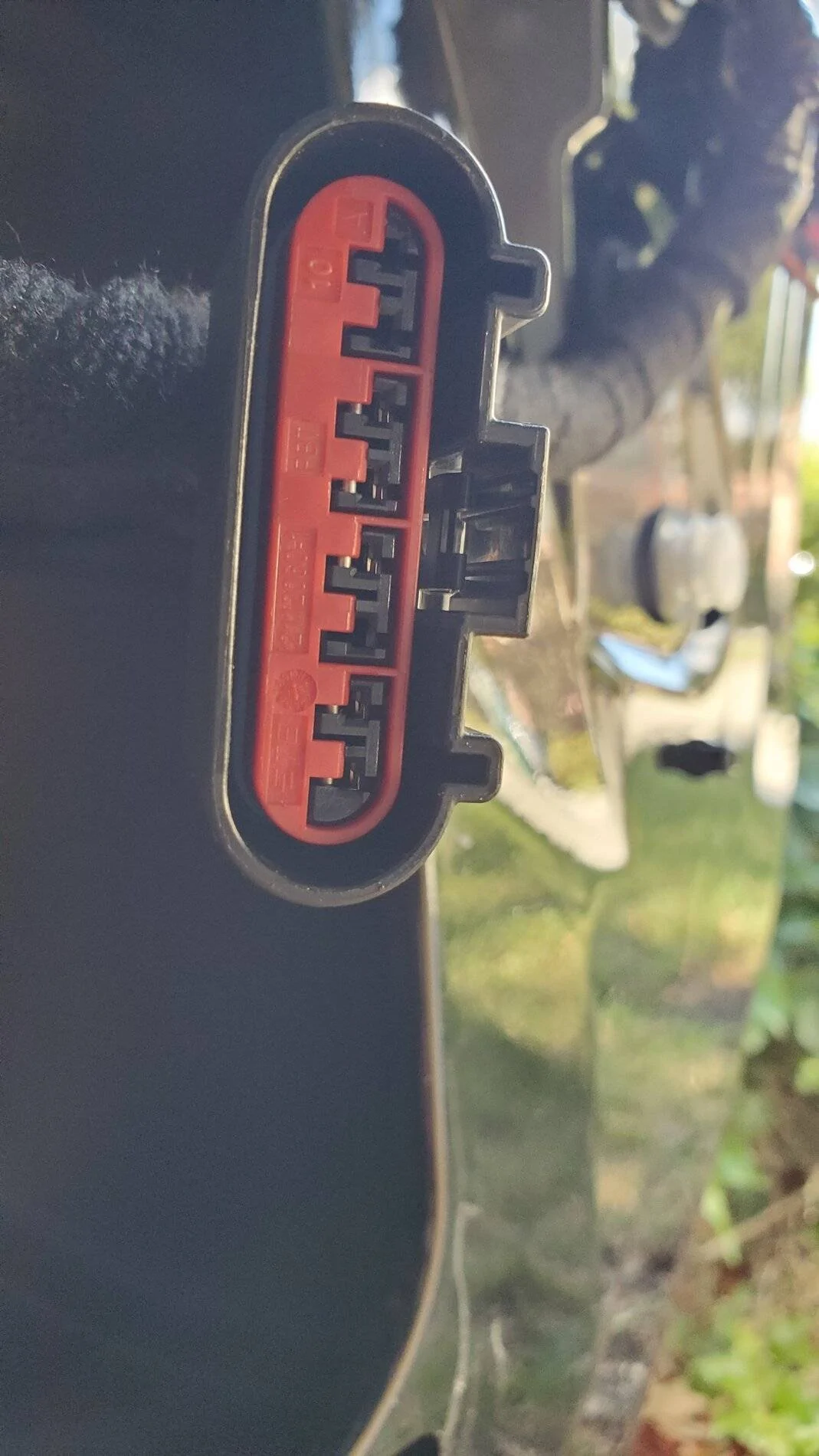

So I finally got around to working on it this past Saturday. It appears the problem may be solved. I have driven a couple of hours over the past 2 days since the apparent fix and it has not acted up once. The solution appears to be applying contact grease on the connection to the latch to resolve a connection problem.
So thanks to everyone who contributed, I could not have done this without all the feedback!
The plug in the door...
I applied contact grease across the connector where the pins would connect...
And FYI, the links I referenced for pulling off the door panel:

The photo I shared is the best view I have of the part. It is at the end of the door at the latch, so that is my assumption. I did not replace it. I only applied the contact grease. It's still working properly.

What did you have to do to get to that connector? Take the door latch off? Door panel? Can you take a wider photo? I've been battling with this for about 2 years (I also have my own thread here). Mine went from randomly moving up and down as in OP's video to, one day, just stopping completely, and now it stays down 1/4" all the time, but the window motor and other functions work fine.

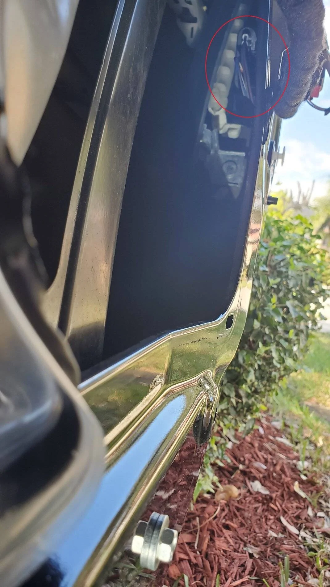

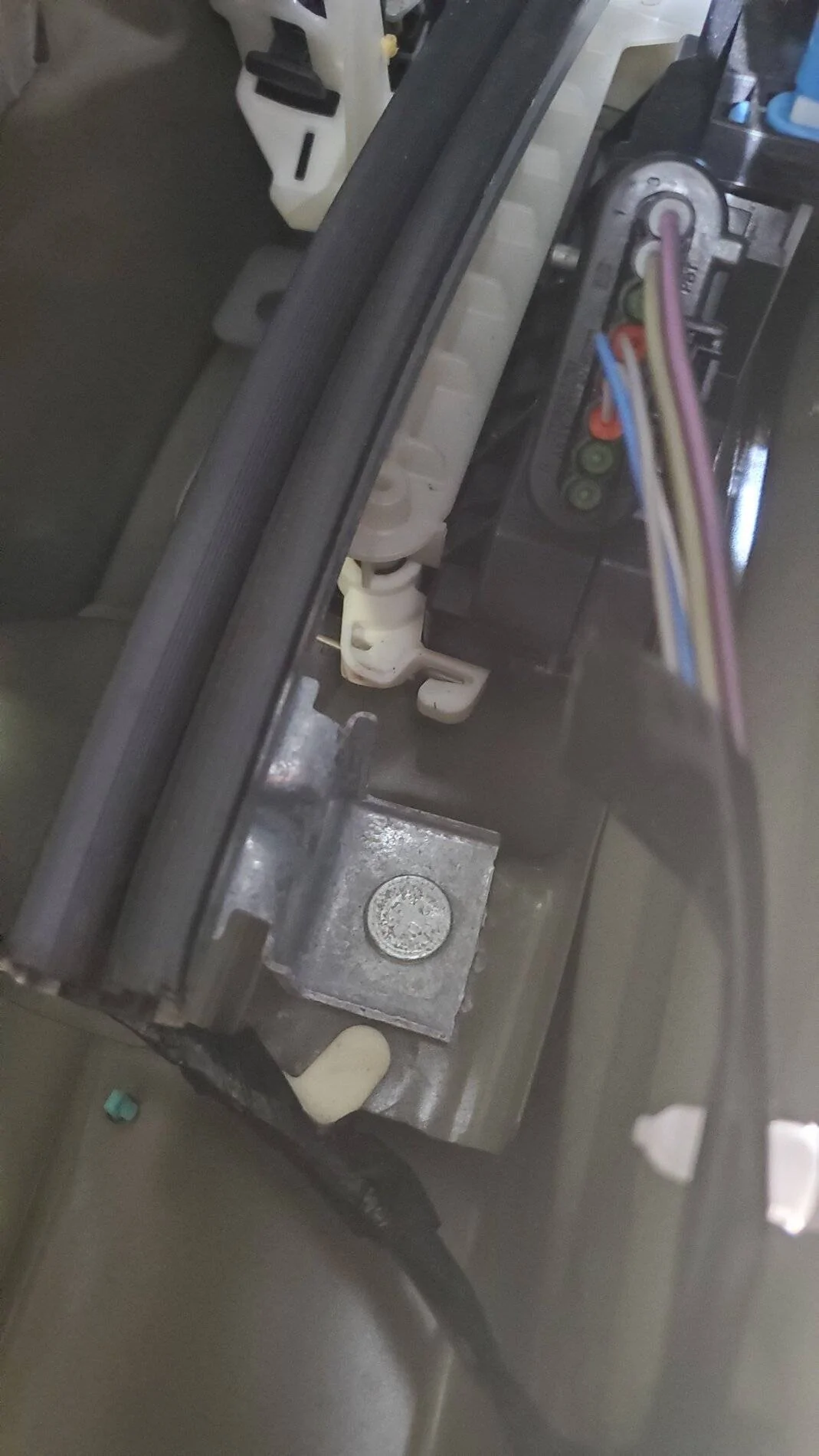

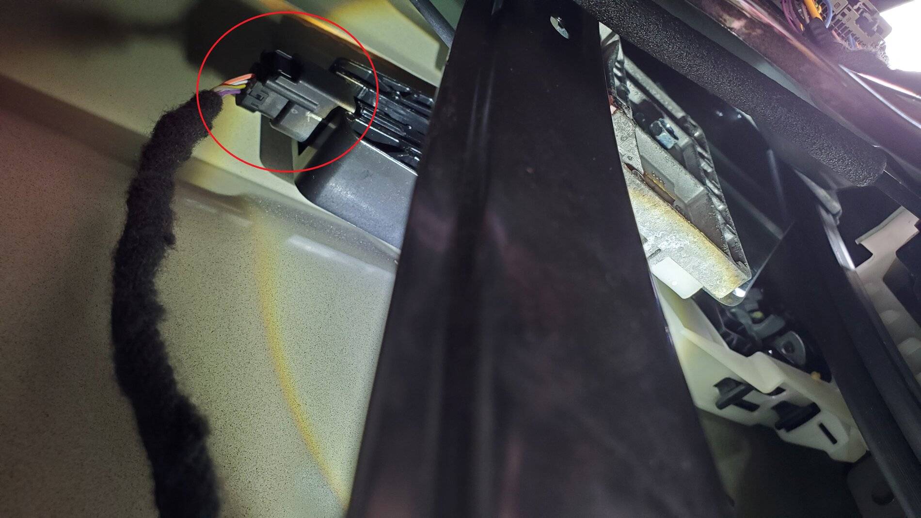

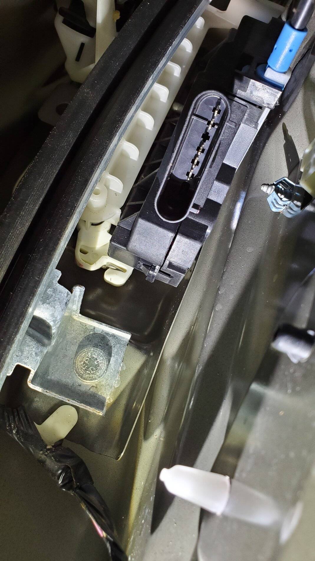

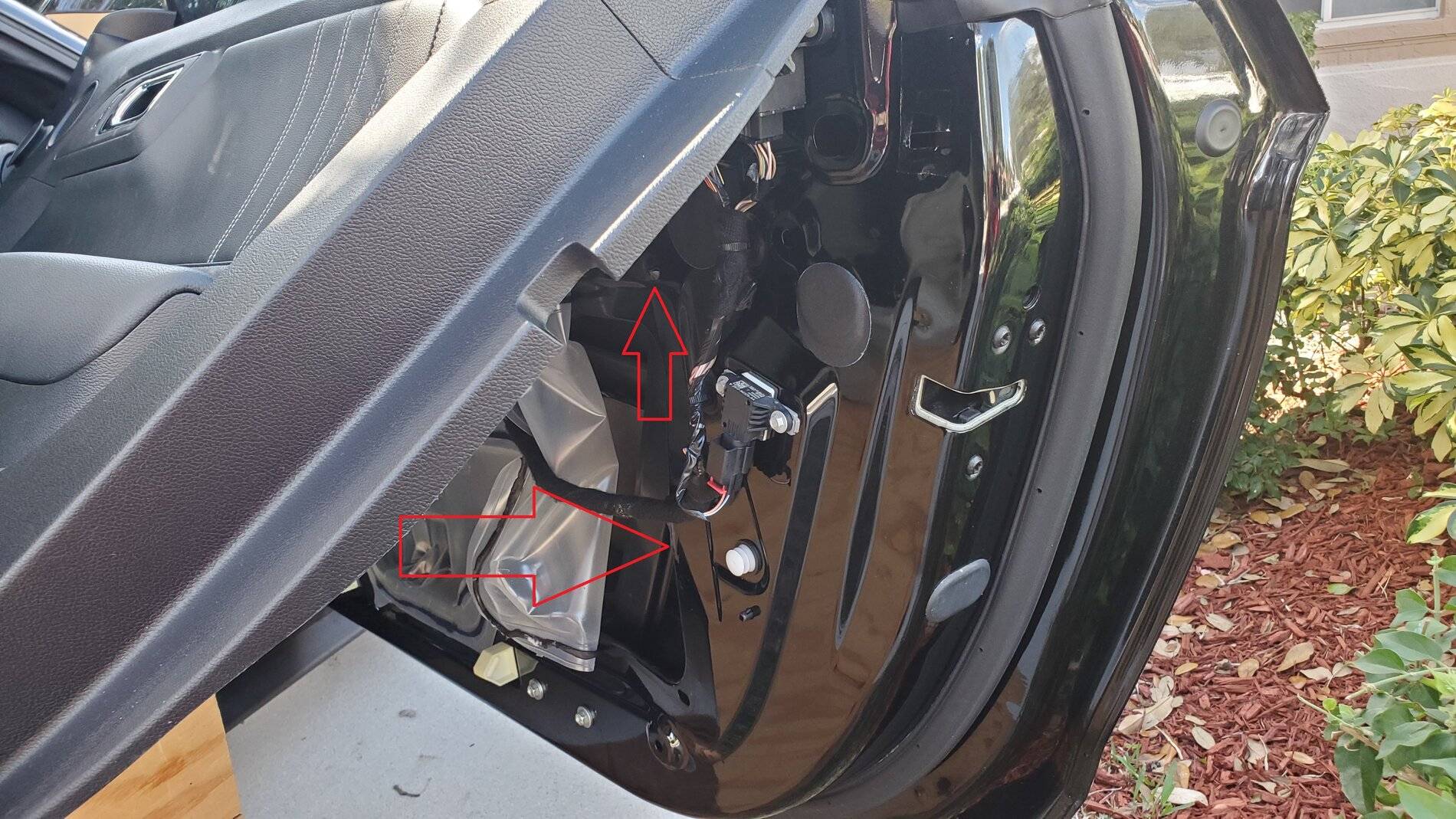

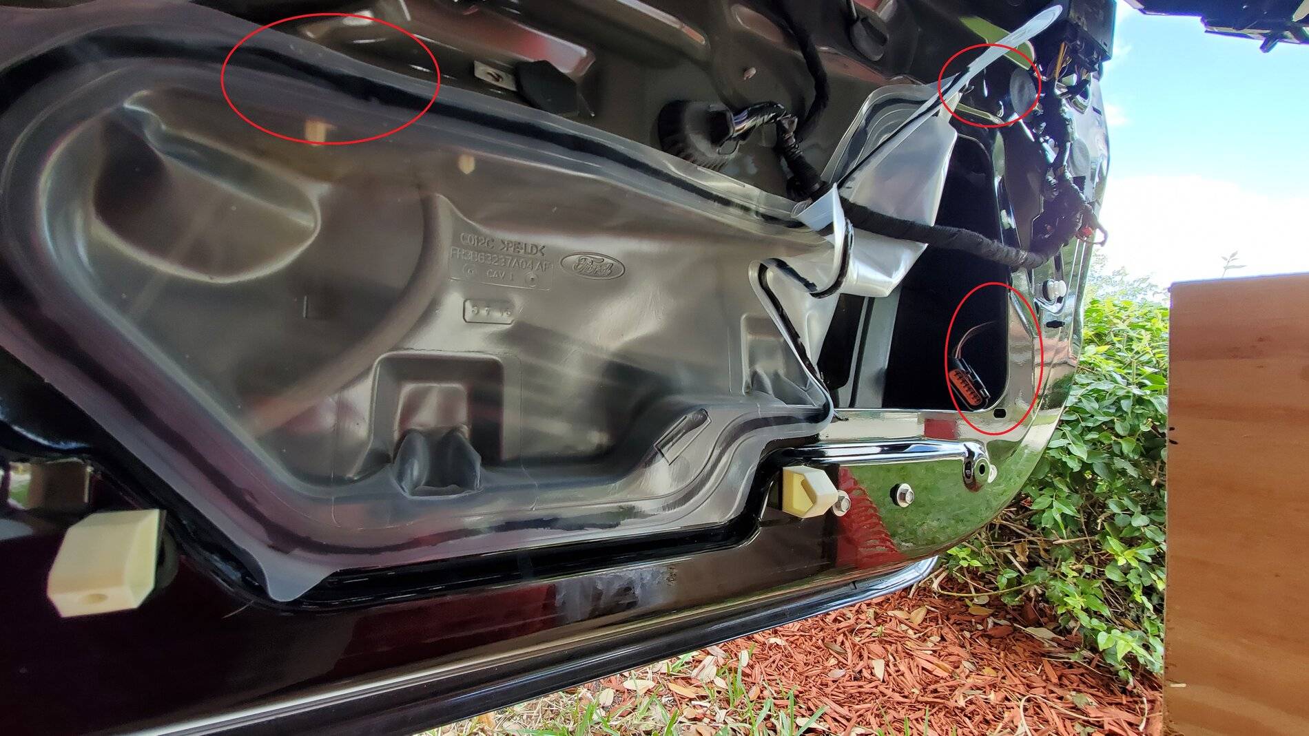

So I believe I have fixed the problem in my son's 2016 EcoBoost. It's been about 2 weeks now and it still seems to be working now... no more passenger window randomly dropping 1/2 inch and up.
kipp's post #18 above was very helpful to me. Thanks for all of the help here.
I took off the door panel and found 3 connectors that I used compress air to blow out, then sprayed with contact cleaner, then little bit of dielectric grease sparingly around the borders of the plug (not in the metal connector or pin area). It took me two tries (only lasted a couple of days the first try). The first time I did not use contact cleaner and I only did the connector kipp showed in his post (that is the bottom right in the first pic below). The second time I also added two other connectors (one going into the window motor and the other up near the lock mechanism). Some helpful pics below besides also looking at what kipp wrote above. The red circles and arrows show where these are. The connectors are all behind the metal where the window slides (so on the other side of the metal where my circles are).

It's the window motor plug. Water gets into it and the window goes nuts. Blow it out with compressed air and pack it full of dielectric grease. You want enough grease to keep the water out.
Yes, that is one of the 3 plugs I did on my second attempt. So, in my case it very well could have been that one for me as well.
