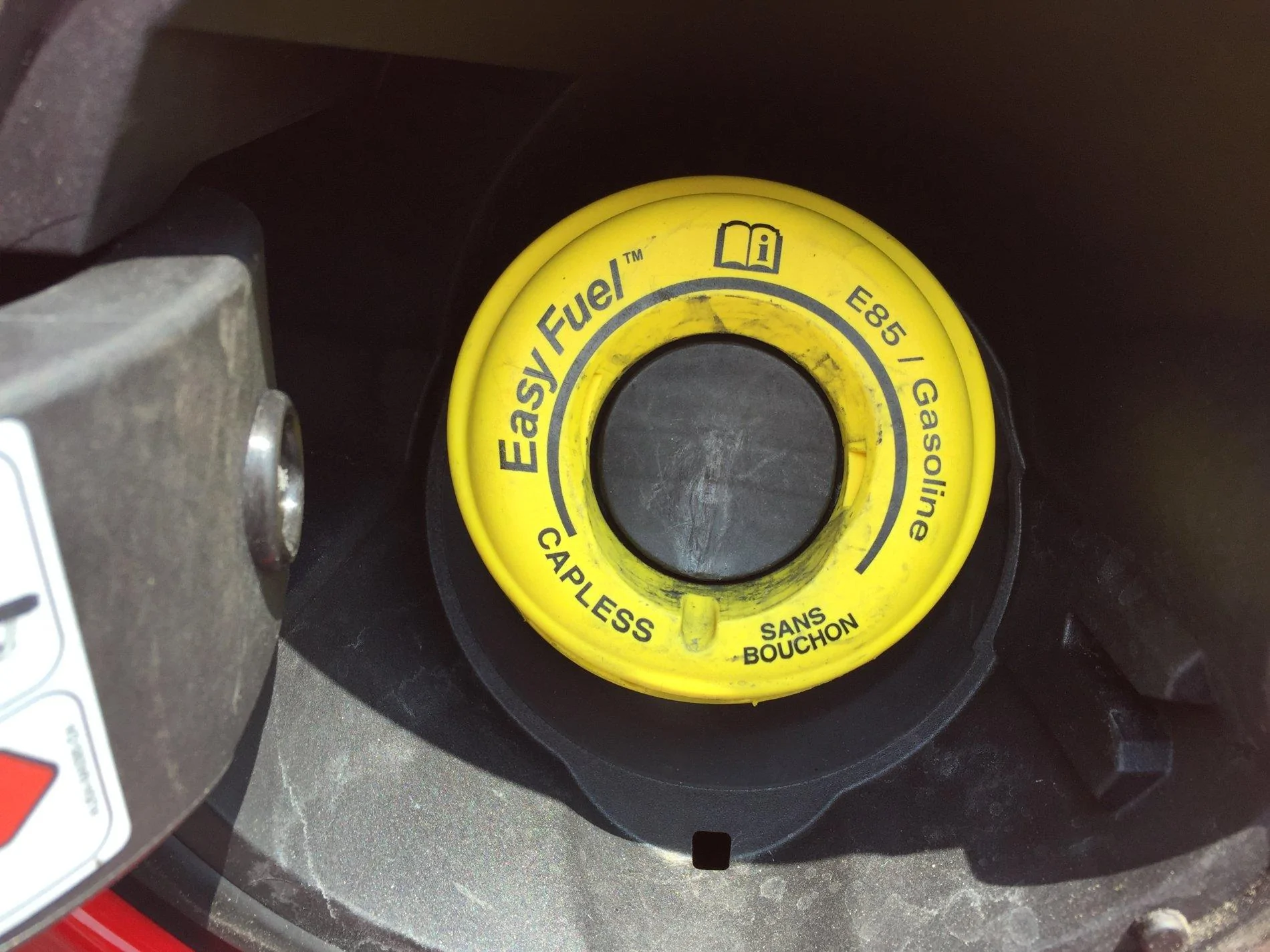

This is my rental F150 with gen3 coyote A10 cap-less gas filler. Says E85 right there... :).
My 2011 F150 5.0 has the same E85 filler....Ford has data from trucks on this fuel....no mustang love yet....
