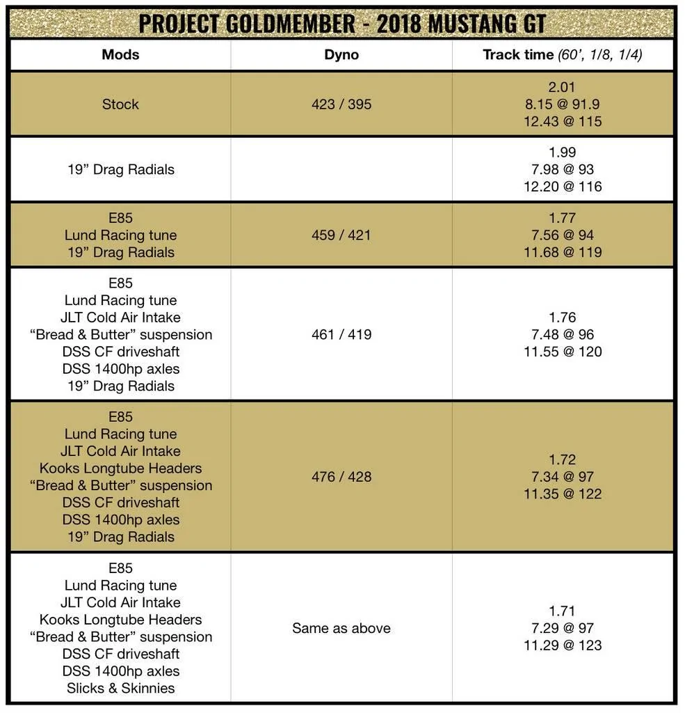

Very nice comparision here. I would stop at e85 and drag radials. There seems to be very small incremental drops after that with a very high spend.Here's the results we got on our 2018.
And this is the reason I converted to cornHere's the results we got on our 2018.
