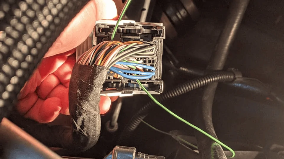

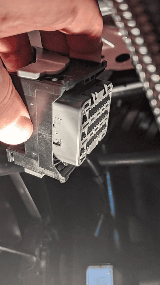

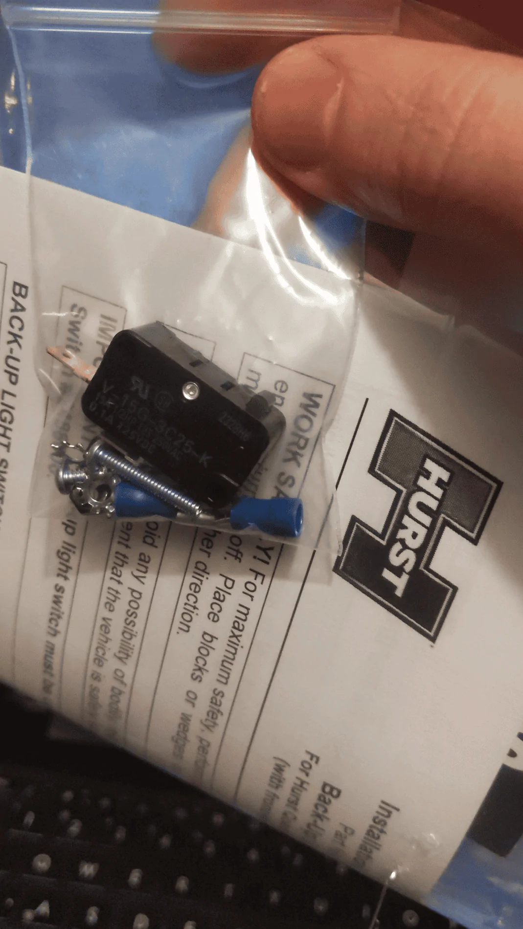

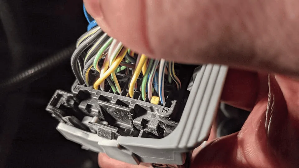

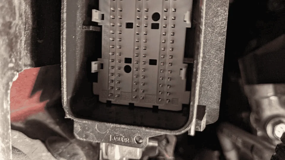

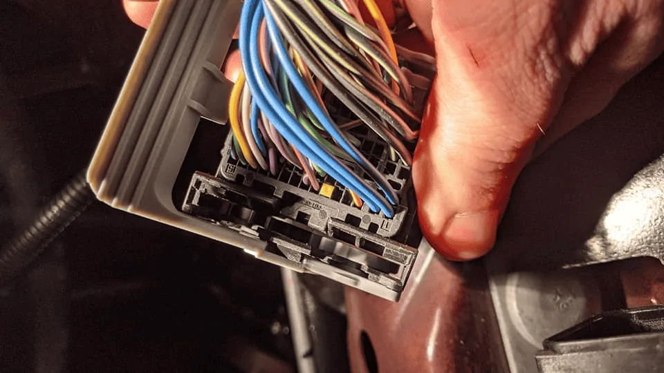

Looked at them earlier today, don't think a micro will work . Looks like the tr sensor is all digital and tied into the transaction. Looks like the transmission sends the gear selection to the bcm over a can network . On the other hand if it was a manual no problem . If you want I can shot you over the wiring diagrams in the morning .Looking for someone that knows the wiring/schematic for 2018+ 10r80 reverse light and backup camera activation. I'm planning on using a micro switch on the shifter to turn these on. Would like to know what I'm up against. Anyone have experience with these circuits?
