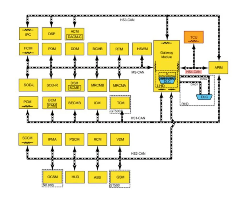

There's another piece involved, one which has seen more activity than the physical PCM under the hood: the GateWay Module (GWM). The GWM is the DataLink Connector (DLC)/On-Board Diagnostics (OBD) port that people are plugging into. It acts as a physical place to hock up. It also acts as a switch/hub for all the network segments.
The front of the GWM is what you attach to. The back of the GWM is the central hub for the network segments.
I don't think the GWM was broken during the event. But with people physically accessing it several times, any of the connections involving the GWM might have loosened up. Gently, check this area to ensure everything is connected well and in-place. A GWM with poor connections could produce any of the effects being witnessed. A poorly-fitting or bad OBD cable being used to hock up could also produce problems.
