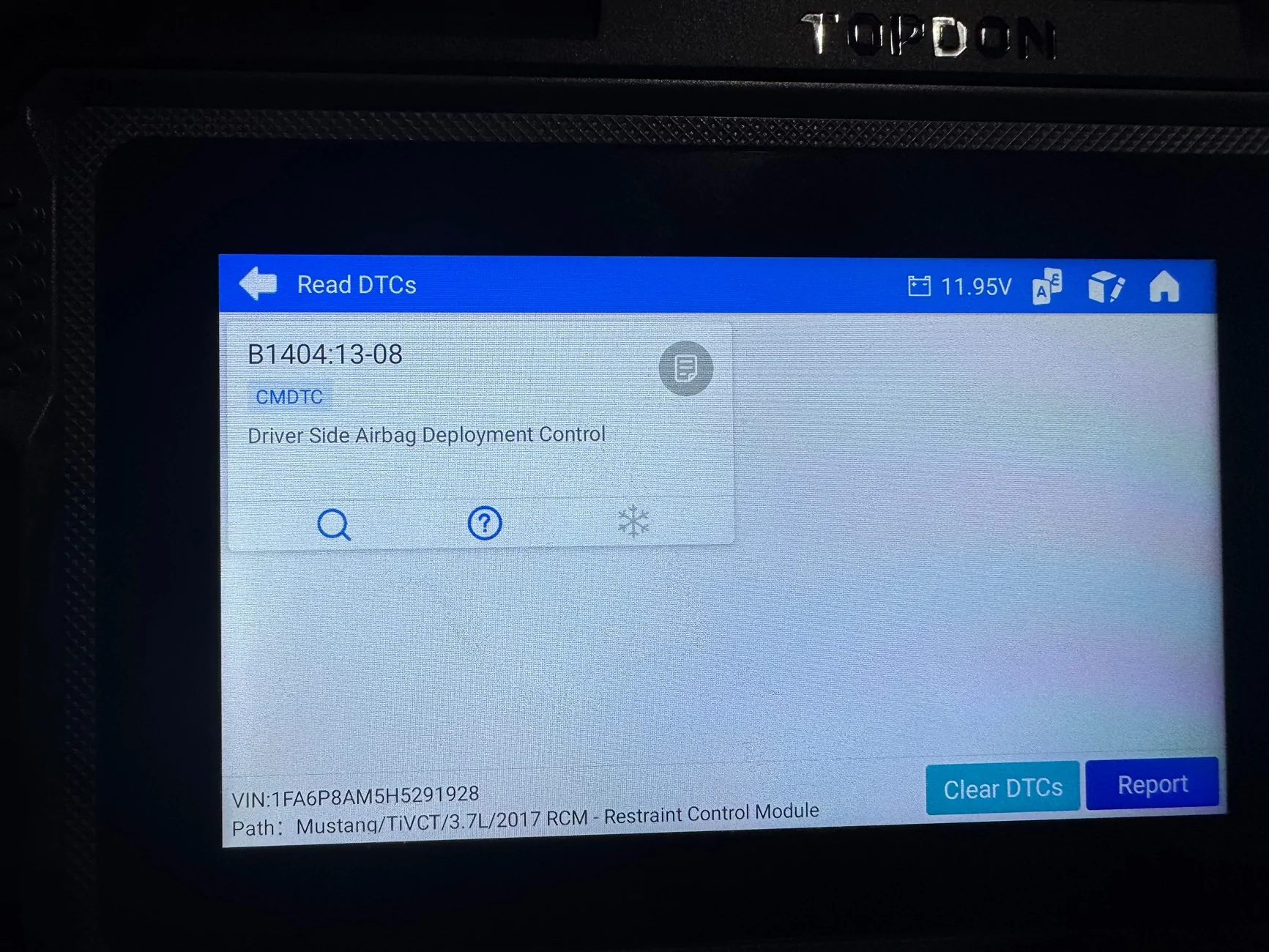

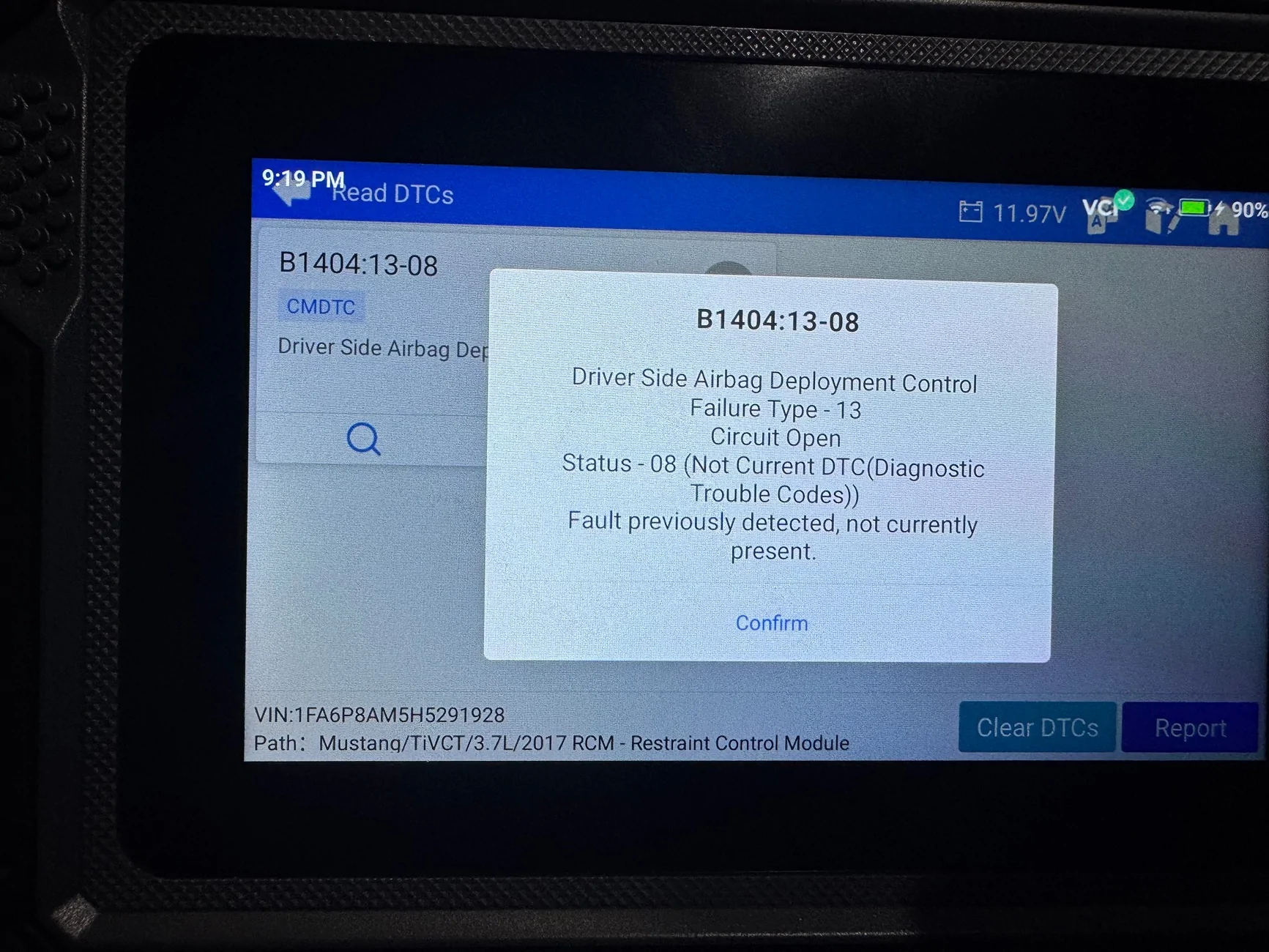

First time posting. I have an airbag light that comes on intermittently. Just wanted to see if anyone had this issue before to see how I would go about it. Not sure if it could be the cable inside the driver seat because I pushed back against the driver seat this morning then the light turned on but still not sure

I had posted SES/airbag info a while back for folks rebuilding salvage S550's with airbag codes/SRS lights or non-start issues. The info within may also be helpful.
https://www.mustang6g.com/forums/th...cident-or-salvage-repair.165362/#post-3364334
Check these 2 areas for SRS issues that may trigger the air bag light, threads below for reference.
Knee air bag connections:
https://www.mustang6g.com/forums/threads/2018-gt-airbag-light-on-cluster.107200/page-3#post-3333786
Overhead map light air bag "jewel":
https://www.mustang6g.com/forums/threads/2018-gt-airbag-light-on-cluster.107200/page-2#post-3017970
The S550 airbag system is very complex and any hard fault code reset needs to be performed using a proper scan tool that is equipped to reset air bag codes because airbag faults are totally separate from the normal DTC faults.
The SRS light and codes can be reset by a Dealership using the Ford IDS system OR I believe some M6G members have reset SRS codes using the Forscan device too.
The below charting was applicable to the 2015-2017’s. Some may still be applicable to the 2018+, but there have been many production changes after 2017 so use caution.
