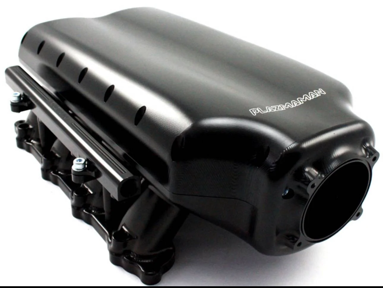

I've been 25+ on a ported 2018. No issues. I have seen some LS manifolds blow open on much lower boost pressures, but keep in mind those manifolds are 20yrs old and heat cycled a million times. I'm sure the epoxy and polymer gets brittle over time.
Imagine a polymer manifold exploding under boost, rails and injectors become dislodged, fuel everywhere.... Not to say that is common with coyotes but it's possible. That's why I went aluminum.
That thing looks awesome. What manifold is that?
