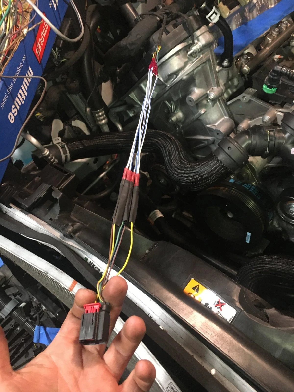

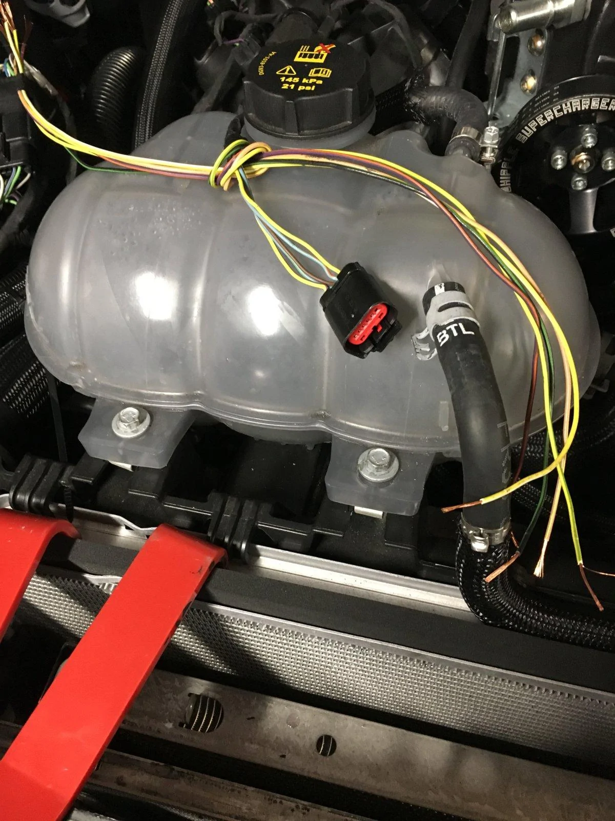

Just wanted to follow up.... reason why I never saw one before was because steeda didn’t put one on when they installed it. They opted to make their own instead. Lol I kinda wish they hadn’t after seeeif what it looked like under the harness tape...
Glad I pulled a whole harness out of a mustang a handful of years ago. Hefty supply of extension wires; that’s tomorrow’s project
