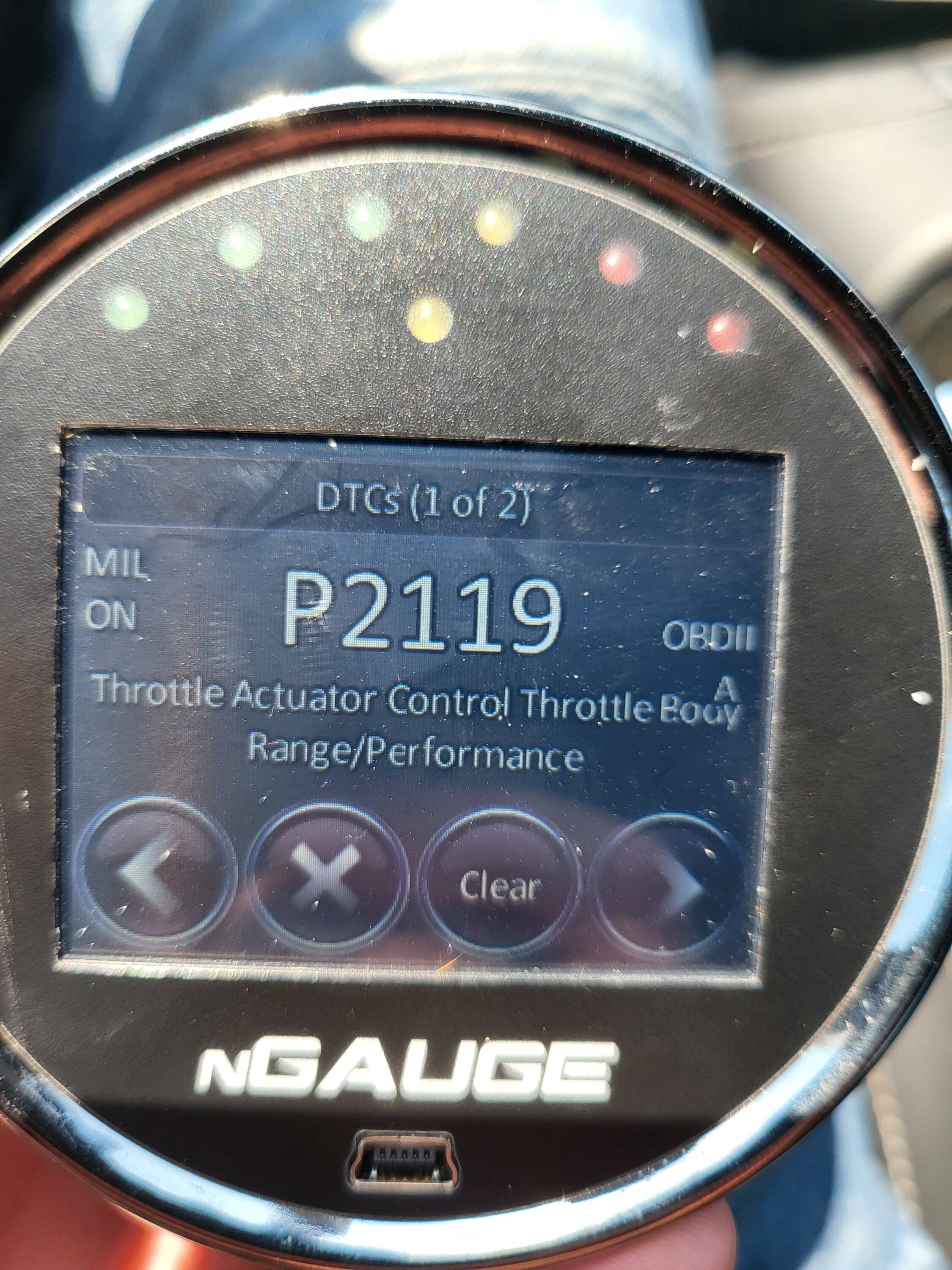

It happened 2 times this week.. car goes into limp mode, I forget the code but says throttlebody actuator out of range. Any suggestions had it on car 60k miles now its doing this.

2015 mustang gt
That's code I am getting. I do a 40 min drive at night when it's Colder it's fine.coming back during day when it'd 90 plus degrees almost home I go in limp mode with code above.
