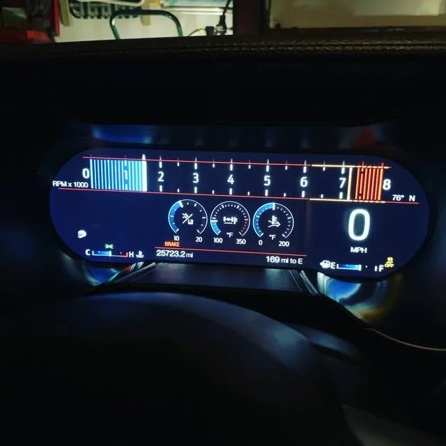

Went ahead with my install tonight anyway, used what I posted above and encountered some Service Has Been Interrupted Errors initially. Those didn't go away with uninstalling/reinstalling Forscan like some people had reported - I ended up deleting my vehicle profile which brought up another issue where Forscan doesn't detect tuned vehicles and I had to reflash my stock tune (love how slowly the X4 does that /s).
After doing that, was able to connect and program my mileage then also start with the other programming bits.
For some reason the odometer rewrite did not take my actual entered figure? I put in 40262.3, it said on the pop up screen, then showed 40260.5 instead (also showing on my cluster now)? When I tried to rewrite it again, it warned that the number was lower so I'm not sure what's actually happening.
Now I've got a U0401 (full is U0401:82-0A) code for the IPC, not sure why but in the process of flashing my tune back on now - hopefully it magically disappears.
Spoiler/edit » code did not magically disappear but I'm tired of tinkering for tonight. All said and done, my install probably took about 5 hours with 2.5 of that being fighting with Forscan and going back and forth from the car to my apartment to try downloading different stuff / searching for others' possible solutions. The other tough part for me as a guy without many good tools was the damn torx screws on the top of the SCCM. My Torx screwdriver is a POS that I need to replace because it just spins the handle while the bit stays in place -.- So I sat there using pliers to twist it from the base a quarter turn at a time. Thankfully it booted back up with no issue.

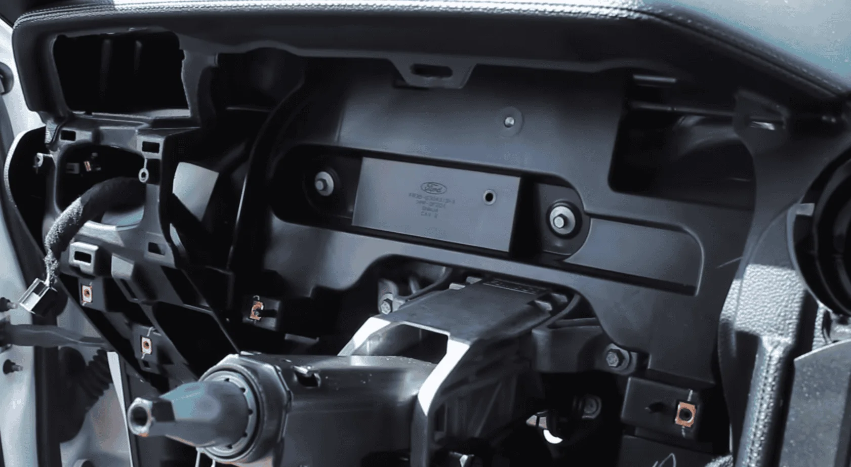

DarkHor$e
Apr 3, 2018
203
73
SF bay area
Chris
RaceRed '17 PP Base- Sold!!!
Sorry, i don't get here much since i sold the stang. you will cut out most of the center and up top, but you need to leave a link on the left side where i marked to keep the plastic joined in one piece, basically you taking the center out of it but leaving the surrounding portion, the bottom for the clips, and the TOP so you can drill into it and it will be stable instead of flopping around, which is what will happen if you break the link between the upper surround gutted portion and the now lower portion. the existing line is pretty thin, you have to cut, insert the cluster, and take a look, remove and cut. I think i was able to join them with like a 1/2" of plastic remaining.

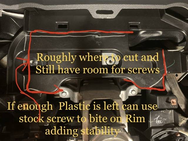

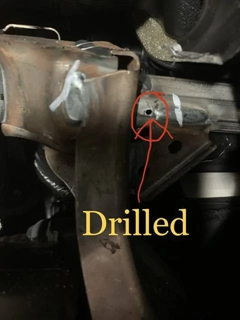

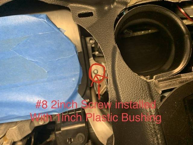

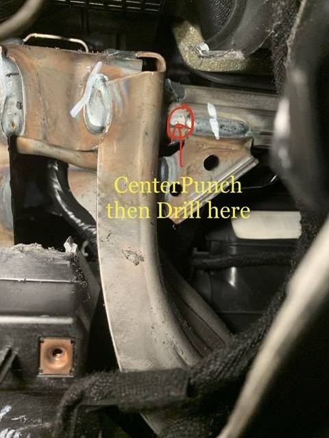

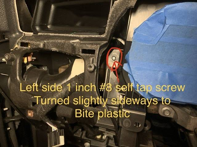

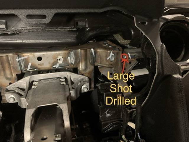

Another successful install here. I ordered the kit from Sam (breeves02) and it really was plug and play !
Even got a display with the diff temp so happy about that. I also opted to use the Darkhor$e method which worked great!
Takes a bit more time on the install but the cluster is in there rock solid no vibrations or movement etc. Attached some pics and tried to outline the best I could on where to cut, punch, drill, and screw. Hopefully will be useful for someone in the future

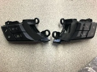

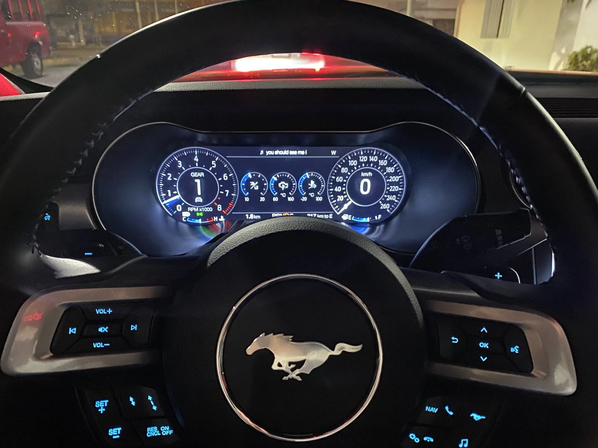

Hi all,
I did this swap yesterday to my 2017 GT convertible.
Installed the digital cluster and programmed it with Forscan. Fine.
Changed the buttons on the steerong wheel to the 2018s.
My last problem is, that the new steering wheel button "sends" the old signals. Let me please explain: in standard the 2017 has the arrows for the menu and the "OK" button on the left upper part of the steering wheel. The new 2018 buttons have this function on the right upper buttons. But the menu only changes and "OK" will be entered, when I push the buttons on the left site (Vol + Vol - and mute as "OK"). Is there something wrong with the wiring? Does it need to changed internally in the steering wheel? Or is there a problem with the forscan programming?
Kind regards,
Daniel
Mike K.
Jul 30, 2017
239
95
Lakeland, FL
2017 Mustang GTPP
Did you swap the sccm / clock spring mechanism also ?
