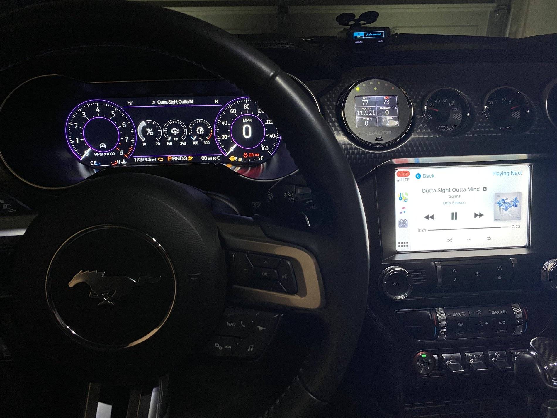

Can anyone tell me if there’s a way to make sure it shows what song is playing in the cluster from Bluetooth or even Apple CarPlay I saw above it says showing the song playing doesn’t work at the top
Rapidx
Jun 1, 2019
Oregon
Daniel
2018 Mustang GT PP
I upgraded to this and it shows the song title from Bluetooth.
