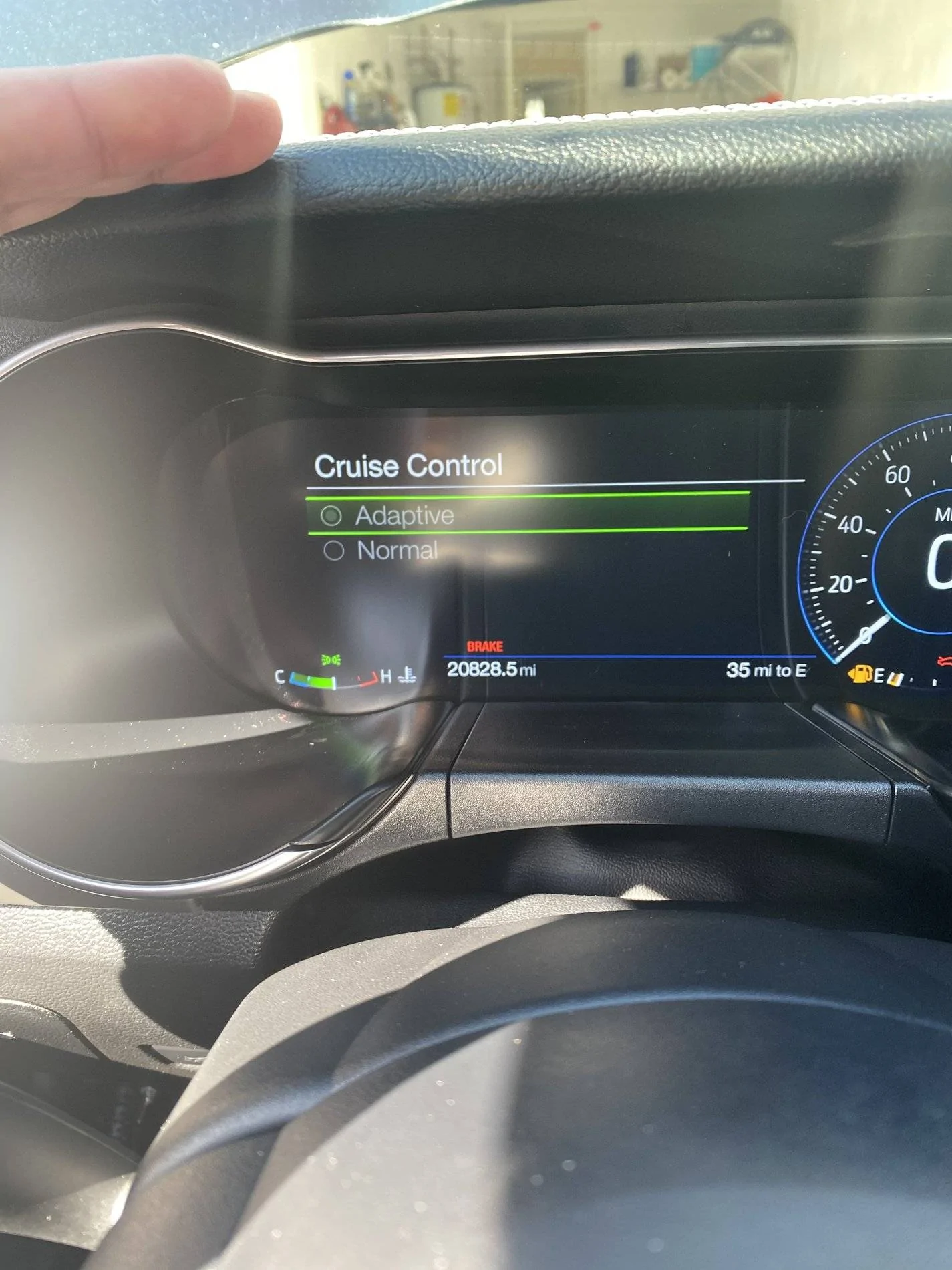

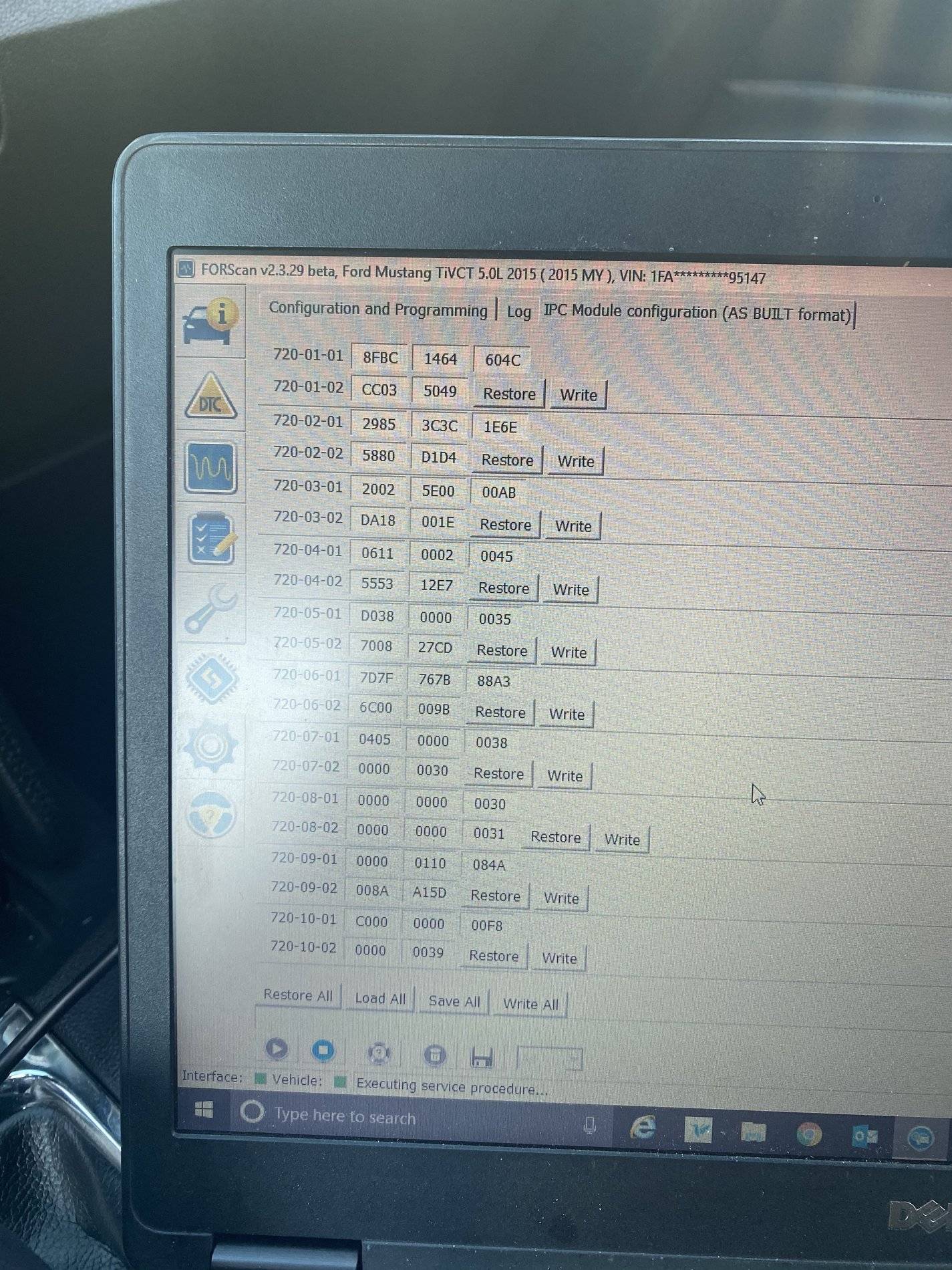

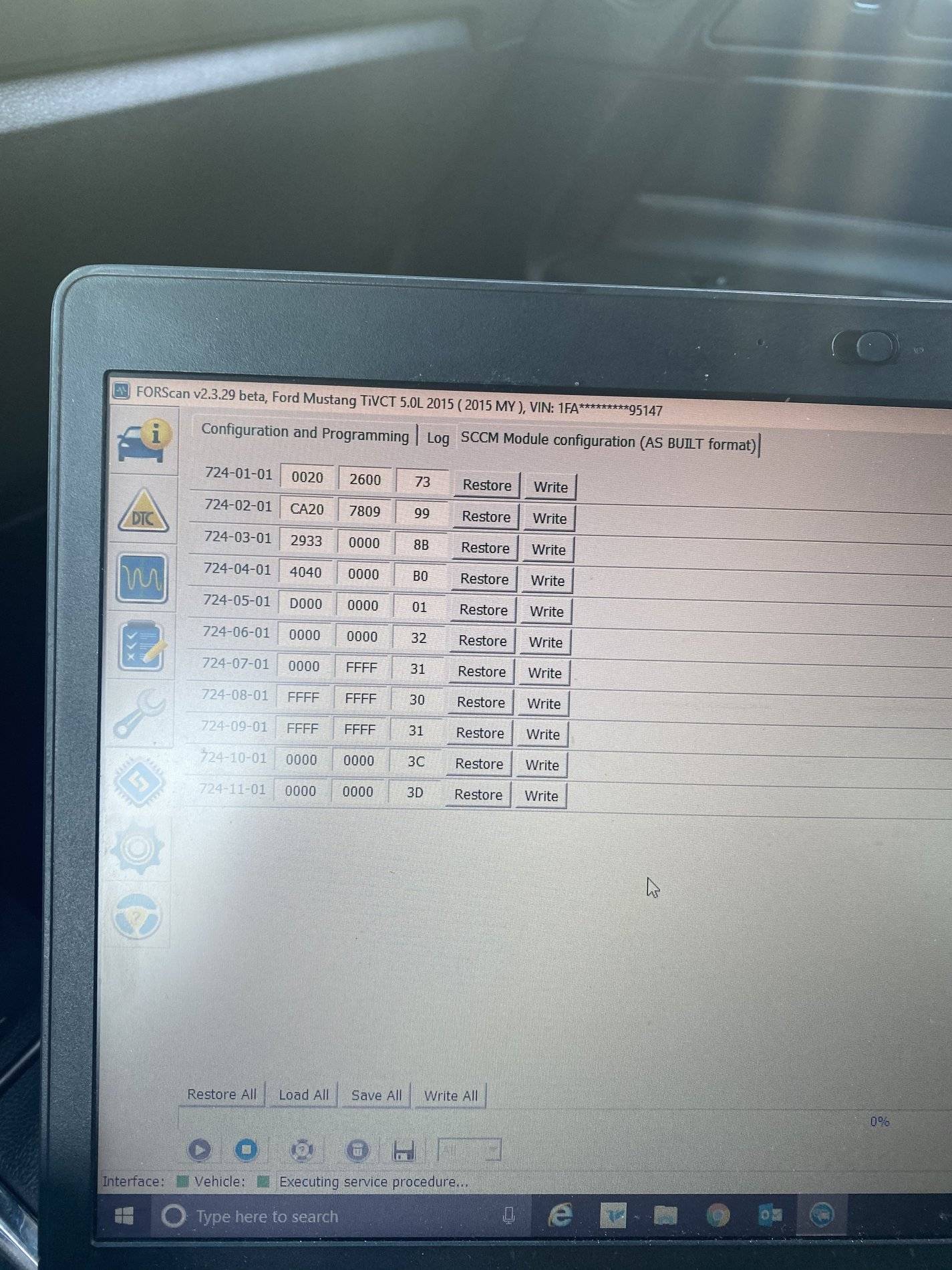

So I just did the cluster for a friend and the adaptive cruise control is greyed out. I set the SCCM to 2933 and IPC to F for enabled. Any ideas? Took the car on a ride and buttons don’t work

The car has adaptive cruise control and collision warning. Not sure why the adaptive cruise is greyed out I reset and re wrote everything and it’s still greyed out.

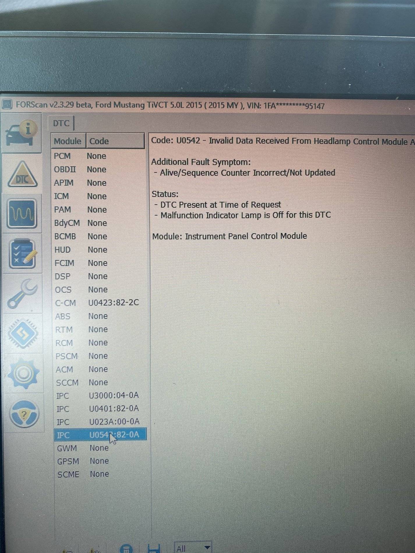

Just finished my install and programming on my 2018 and I am down to one DTC.
DTC Code: U0260 - Lost Communication With Seat Control Switch Module A
I've adjusted everything I can think of with the seats and went into the IPC Module Configuration and turned off anything that says seat.
Has anyone else experienced this DTC or have any idea how to clear it?
