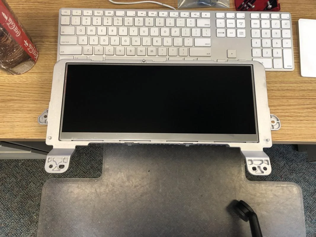

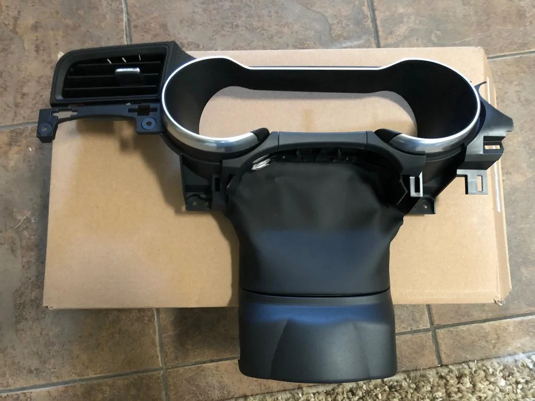

^I had to remove the bezel of the cluster to clean the display off. There were some large particles clinging onto it. Be very careful not to damage the display! I suspected it was actually a square display and this confirmed that.
Bezel:
Is it possible to use the IC without the bezel or at least the clear plastic part? It is terrible at catching glare from all 4 windows.

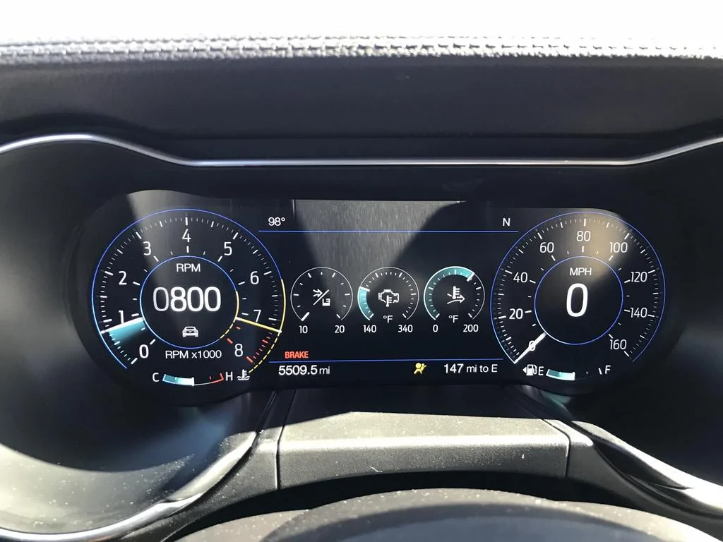

Another successful install here! Only thing bugging me is the yellow airbag indicator light at the bottom. Anyone know what that is or how to turn it off? Do I need to check my airbag connect again? Kudos to [MENTION=29356]breeves002[/MENTION] for this great thread and all the help on this forum!
UPDATE / EDIT: Nevermind, I figured it out. It was a loose connection on the airbag plugs (yellow one popped out). Repluged, checked other connections, and it was all good.

Glad you figured it out. I've noticed a few people have made the same mistake. If the tab isn't pushed in on the airbag connector it will turn the light on.

Yea, it looked like I pushed it in, but when I opened it and looked, the orange tab was completely out :shrug:
On another note, I did have a high beam issue where the high beam works, but won't stay on when pushed away / towards the dash. I triple checked the IPC codes and ended up fixing it when I saw that there was a highbeam code also in the SCCM :doh:. All worked out now and the drive is ever so pleasant with the digital look :headbang:
