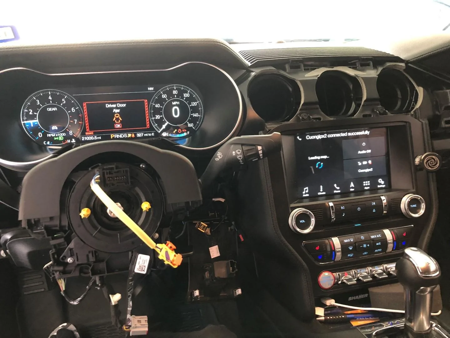

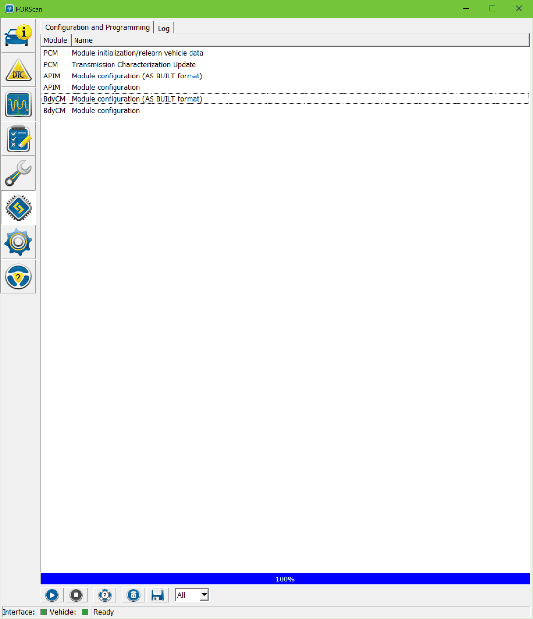

Done with the installation
However, Forscan only read APIM and BCM and PCM, there is no IPC or SCCM or anything, does this have anything to do with my OBD adapter? I use the $19 one in the first post

Yeah.It can't read the high speed buss, which is where they sit. You should just buy the https://www.amazon.com/gp/product/B006NZTZLQ/ref=oh_aui_detailpage_o02_s00?ie=UTF8&psc=1 Bluetooth one. The one you have will work but it needs you to install a DTDT switch.
" -Windows PC with OBD2 adapter that can access all busses "
