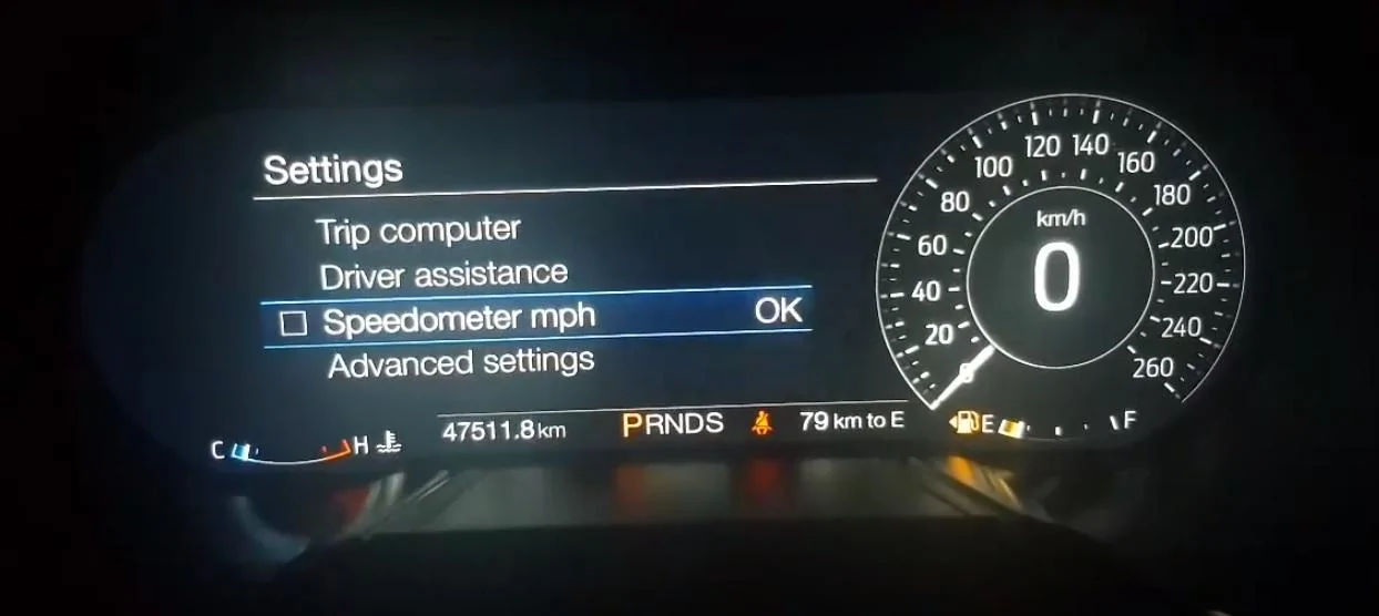

I was just watching a video on FB where someone in Europe has installed the digital cluster that indicates the speed in kph. He told me that you can switch to mph if needed - you can actually see this in the photo below.
My question is if the opposite can also happen: switch to kph in a cluster programmed for mph. I am interested in buying the cluster of someone who lives in the US, but it will be used in Europe, so I definitely need kph. If you can switch from kph to mph and vise versa, what is the reason for having 4 different clusters (mph and kph, both in manual and auto)? Are there any other differences that would make a cluster programmed for mph inoperable on a European car?

Mak when you hit the show mph it just shows a digital mph speed below the Kph gauge there. Doesn’t change the gauge or the KMs to miles.
You can use a MPH/miles cluster if you want but the odometer will be in Miles and speedo gauge will be in Miles even if you check the box it will just show the digital kph gauge.
Also the auto cluster has the “PRNDS” and programming that checks if the car is in gear or not. If you put an auto cluster in a manual car it won’t stop dinging when you turn the car off because it thinks it’s not in gear. I bet a manual cluster would work fine in an auto car it just won’t show the gear.

Thanks Sam. I took this information to our “European gang of experts” in our FB group and it seems that even if a cluster is mph programmed, it can be reprogrammed to show kph!
So it seems that a cluster made for the US can be reprogrammed to work in Europe and vise versa. It’s just a matter of having the right tools to do that.
EDIT: our "expert" members just informed me that a digital cluster that was meant to be used on a manual, can be flashed so that it even shows the PRNDS and the current gear on an auto. This means that that I can get the cluster from someone in the US and use it on my European automatic (that indicates kph), even if it is currently used on a manual and indicates mph. Please correct me if I am wrong :shrug:
