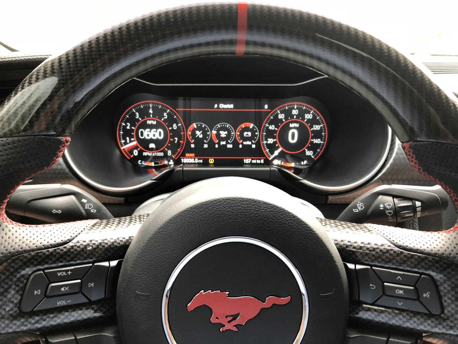

Successful install today on my GT Base with Perf. pack.
Thank you to all who did the research and prework, without this page I'd never have been able to do this! I love it!!
ps. The only thing I couldn't get the outside Temp to work, the line code seems to be the same as the transmission?
and the high beams icon will flash but wont stay on. And I miss my 4 wheel drive lol.

High beams is an easy fix. Change your SCCM as built. 724-01-01 xxxx 2xxx xx and 724-04-01 x0xx xxxx xx
Outside air temp is in IPC 720-02-01 xxxx xxxx xExx
You can also disable your TPMS sensors so you don't have that light on in the BCM.
Thank you !
But the 720-02-01 relates to the auto/manual transmission per your spreadsheet, not the air temp? As soon as I changed it (didnt write it yet) I got a checksum error.
ps. Have to manually reset each wheel tpms, I got new 20"'s so its off.

Each line of as built data does more then one function. Each word of xxxx consists of two bytes. Each byte consists of two nibbles. Each nibble is 1 hexadecimal value. 1 hex value is 4 binary values. 1 hexadecimal value gives you 0-9, A-F - so 16 total options. This means each "x" in the as built string has 16 different options. That means it can set multiple parameters. The hexadecimal value is then broken down into binary to figure out what is set. For example look at the 720-02-01 line. Mine is 2D80 3C30 then the checksum of 1C. The checksum is just adding the previous values hexadecimally and does nothing for the actual configuration of the module. Its a way that the module knows if the data was entered correctly. FORScan calculates this for you.
2D80. So the 2 is what tells the IPC if it is a manual or auto. In other vehicles it also shows if it displays gallons US or UK, and if it has global window open and/or close enabled. So this ONE nibble does 4 total functions with those 16 different possibilities. A 2 means Gallon type is US, its a manual trans, global window open is enabled, and global window closed is disabled. That 2 in binary is 0010. To this logic in theory the first 0 means gallon type is US versus a 1 would be UK, second 0 means manual, third 1 means global window open enabled, 4th number 0 mean global window close is disabled.
2D80 in binary is 0010 1101 1000 0000
Each binary 0 or 1 is one bit. 8 bits = 1 byte. A half byte or 4 bits = one nibble. Each nibble can have its own hex value.
You can control SO MANY different functions with one line of as built data. Hopefully that crash course taught you something.
Ignore the checksum error and hit OK.
The mustangs auto learn the TPMS sensors so if they haven't learned after a day or two theres something wrong.
