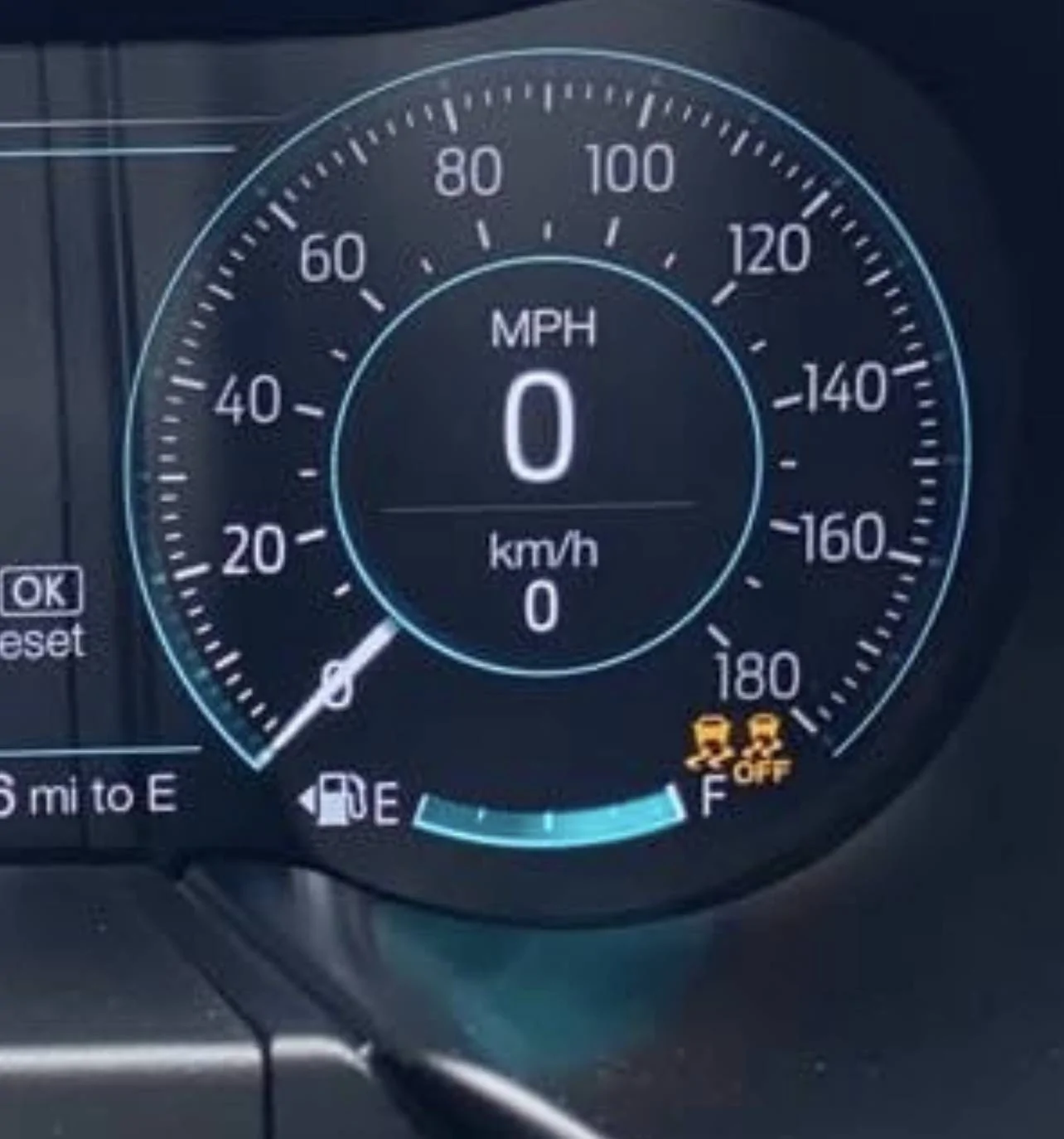

I installed my cluster over a year ago, I know it is mentioned here somewhere But I cannot find the comment. How come the Advance Traction icon does not show up right next to traction control off? It shows me the message when I turn it off but no icon.
bump to this, has anyone found a fix? just saw a 2015 with a cluster that has traction and advanced off icons
