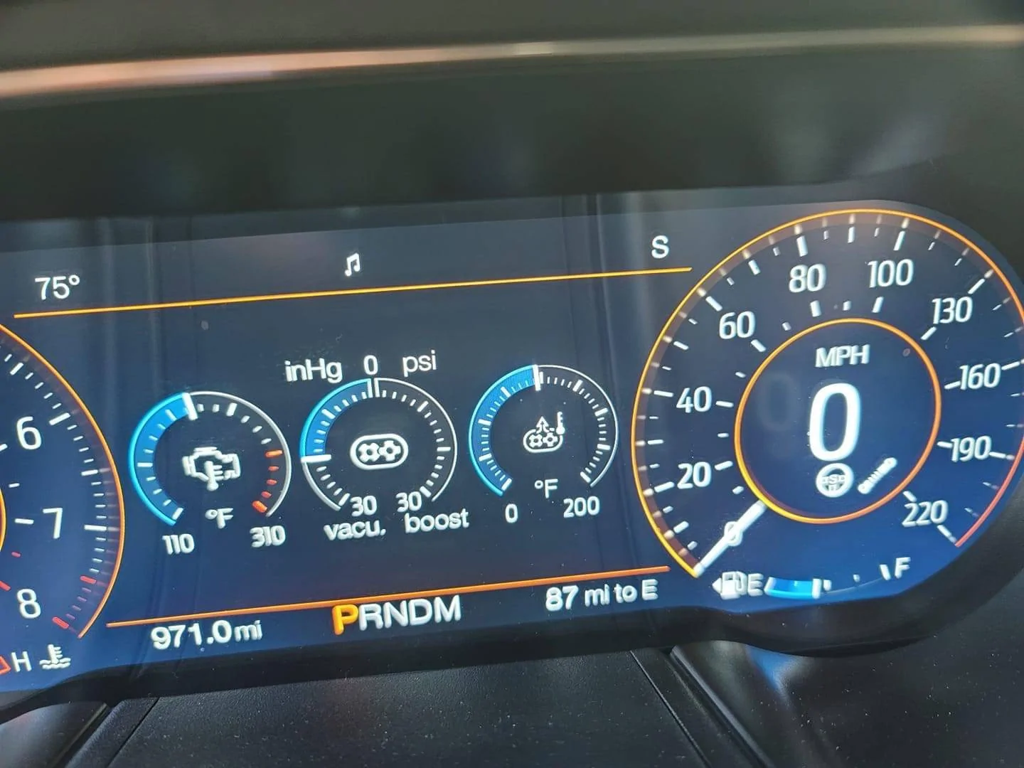

Anyone seen boost and boost temp gauges on GT500? They’re cool. I wonder if there’s anyway to add them without flashing the whole cluster.
