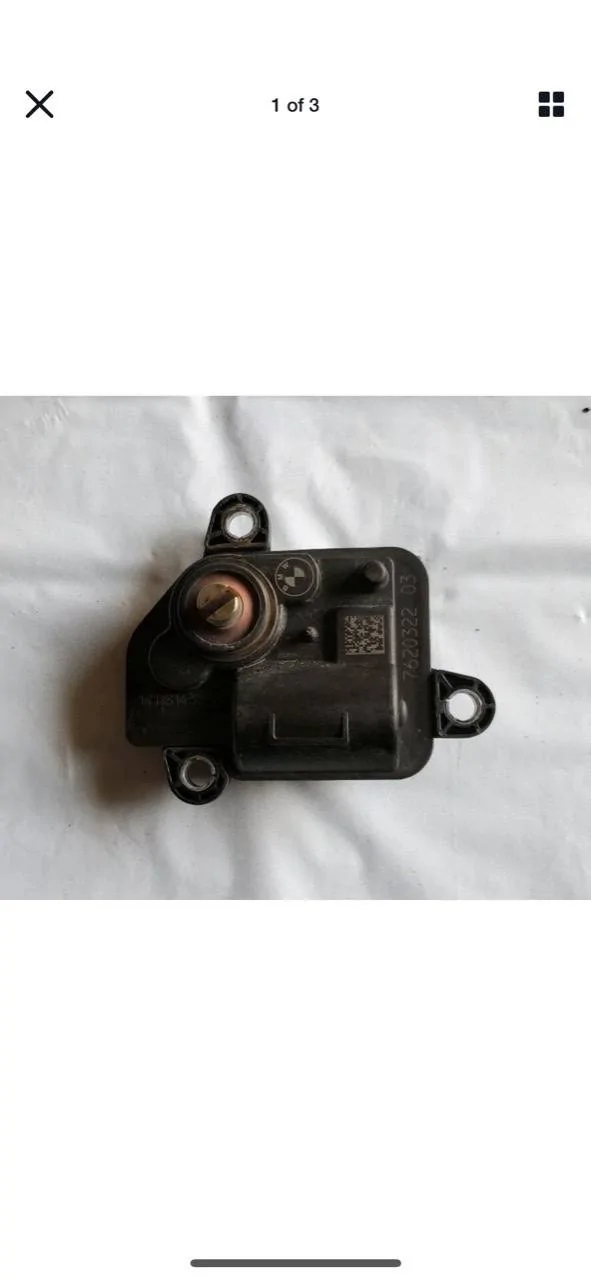

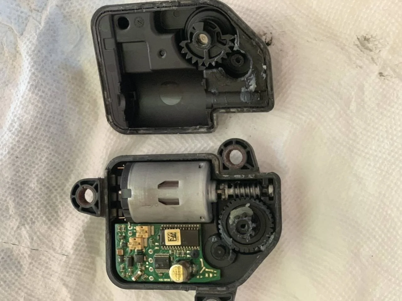

Interesting option for some of the guys who want to go the manual route. I found that the actuators out of BMWs are basically the same thing that Ford uses but the output shaft is clocked 90*
it’s pretty easy to pull it apart though and adjust the clocking. Side benefit, there are LOTS of used actuators on eBay and elsewhere for pretty cheap.
Also you can break the seal with a razor knife and it’s much less invasive than the Dremel option. Just follow the seam around with some force and you can split the two halves apart pretty cleanly.

I’m at about $65 at this point. I think interfacing with the stock system would be nice, but I didn’t want to mess with anything that might mess with the warranty on my new car just yet.
Plus, this is a fun little project to see how cheap I can do it for.
