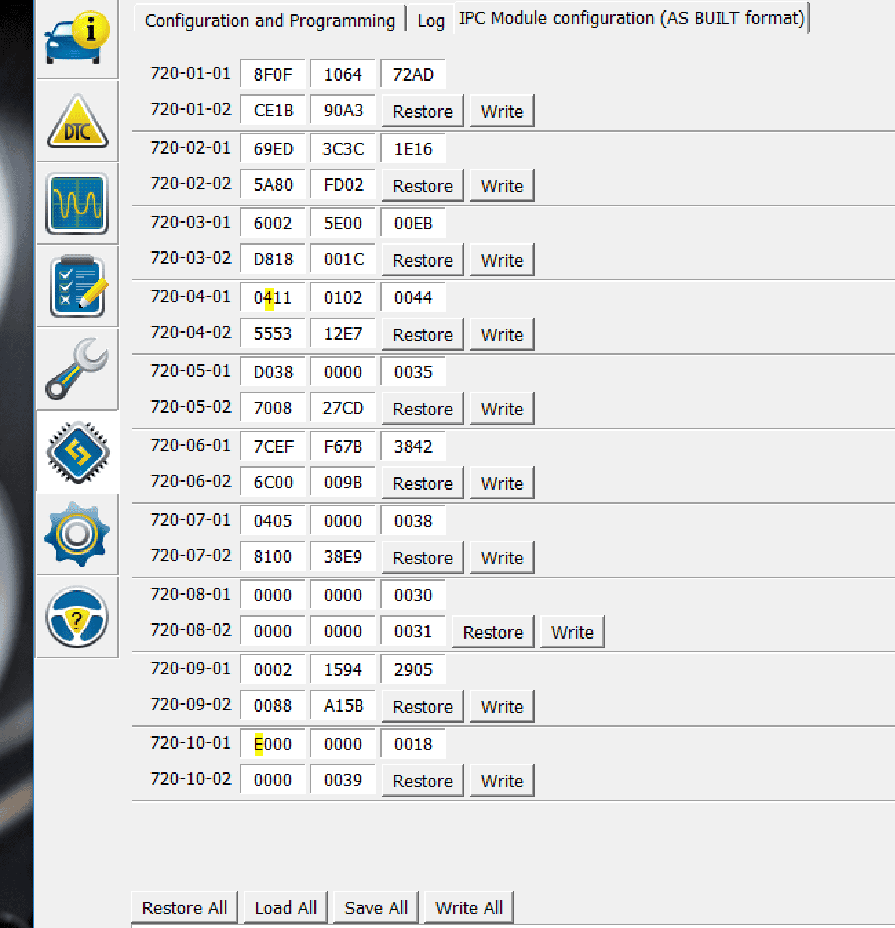

The programming was different between the digital dash and the analog dash. Just throwing it out there but you did the programming correctly? I can't see them changing it for the 2019 model year but anything is possible. The curious part is, when I did the programming and had not installed the mufflers, I was getting an error message. I would think if there was a problem with your system, an error message would pop up like guys who had shorts in the wiring that needed repair.
This was my thoughts as well. I went over the programming 3 times.
This was my thoughts as well. I did go over the programming 3 times. See attached.
The one thing I find interesting is that some folks display the 10-01 line as 2 sets (XXXX-XXXX), and mine shows 3 sets. Not sure if that matters or if that is just they way they are showing it and it not mean anything at all.

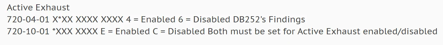

I just looked up the programming. Digital dash requires both the changes you made and analog has a single code change. You seem to have done it correctly. Has to be something simple getting overlooked

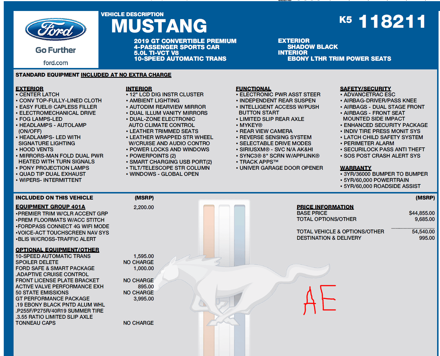

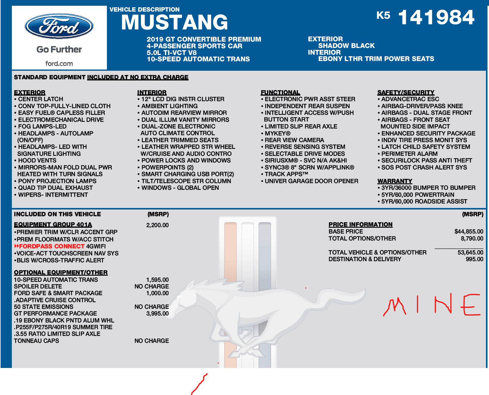

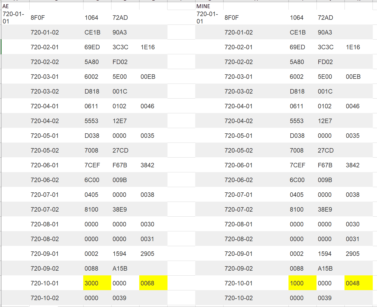

Just to catch up those who are following, I was able to locate my cars doppelganger+AE. With mfoleys help, I pulled the VINs AB data and crossed them. The stickers and compro data are attached. Unfortunately, even after setting it up with the AB data to match the AE car, I am still not getting the no muffler pop ups...
I returned the mufflers this morning due to them being damaged in transit. I am on the fence as to whether or not to reorder until I get this straightened out.
fairplayinc
Jul 17, 2016
64
West Palm Beach, FL
2019 GT PP1 Convertible

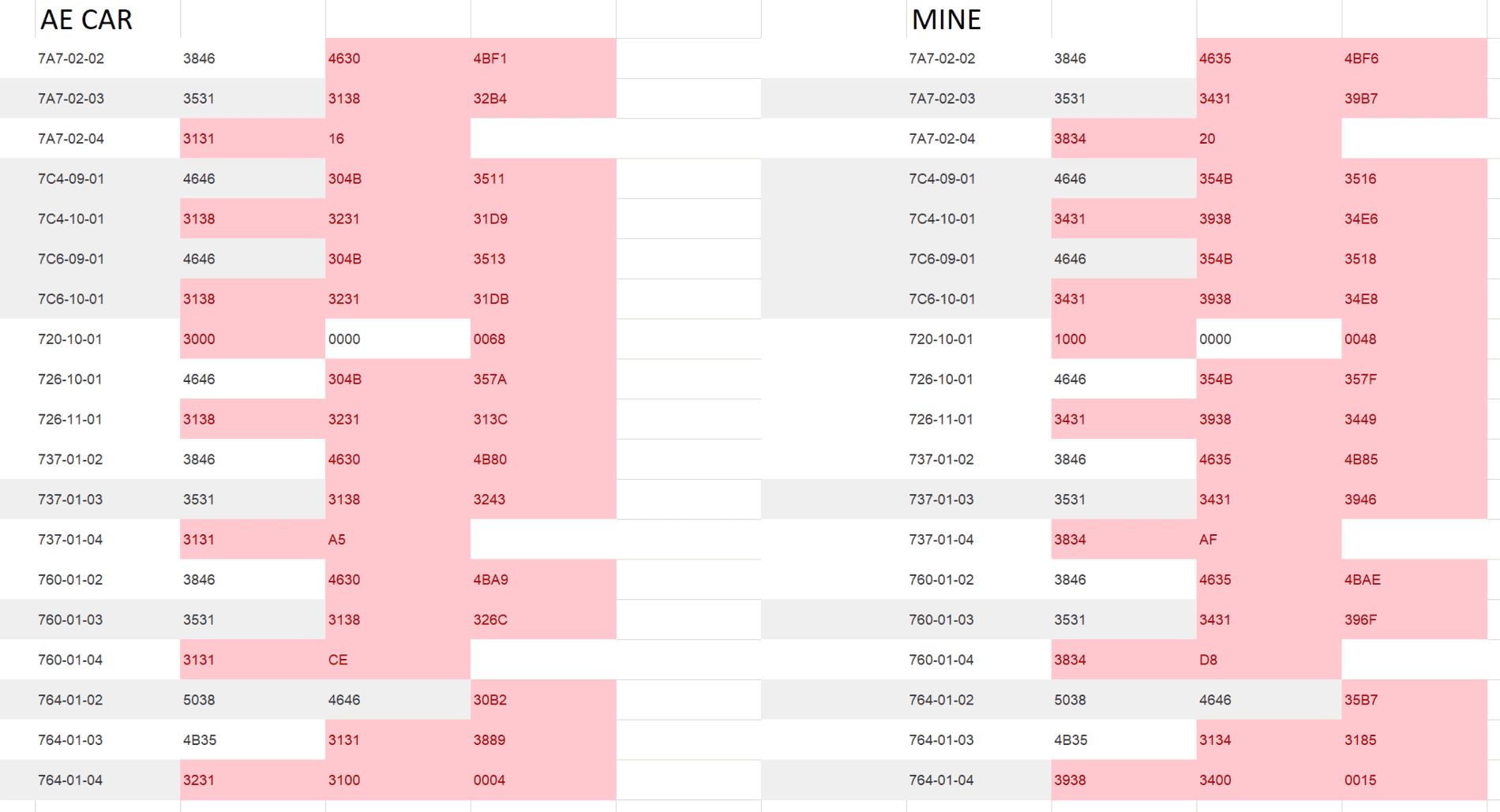

I took it a step further ans crossed ALL AB data. See attached. I dont know where to begin at this point. I have changed the line 720-10-01 and that turns the Exhaust Mode option on in the dash but does not throw the No Muffler alert that others have gotten. If anyone else has any ideas, please chime in.

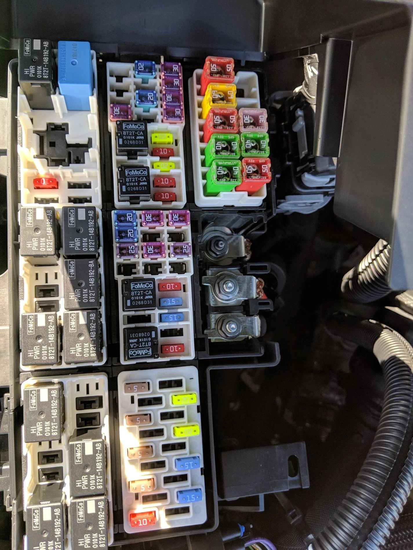

This is the fuse box of a 2019 ecoboost with the 101a package and active exhaust option.
FISHTAIL
Jul 24, 2016
409
107
Laplata MD
2018 GT Premium PP
What exactly do you mean by this? Mine is a late 2018 model, and mine only works intermittently. I got new wiring harnesses for it, and it's still being buggy
Just that another member here had identified that their car, without factory AE, had the relay in the box, but it appeared to be plugged in upside down. It would be good to inspect a car with factory AE and ensure that the relay is installed in the correct orientation before we all go flipping them around though.
Welp, for those of us with 2019's the other setting to change is in the PCM and Ford had to do it for me. $60 well spent! I am now converted to Active!
