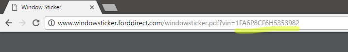

Step two: On each listing, you should be able to see a VIN. The listings are a terrible source for info. The people who work at dealerships and are responsible for internet listings are overwhelmingly bad at their jobs. But don't despair! We can take that VIN and add it to the end of this URL: http://www.windowsticker.forddirect.com/windowsticker.pdf?vin= to get a window sticker, like this:
After you've pulled up the window sticker, save it to your machine. By default, it's saved as "windowsticker.pdf" and I always replace "windowsticker" with the VIN.

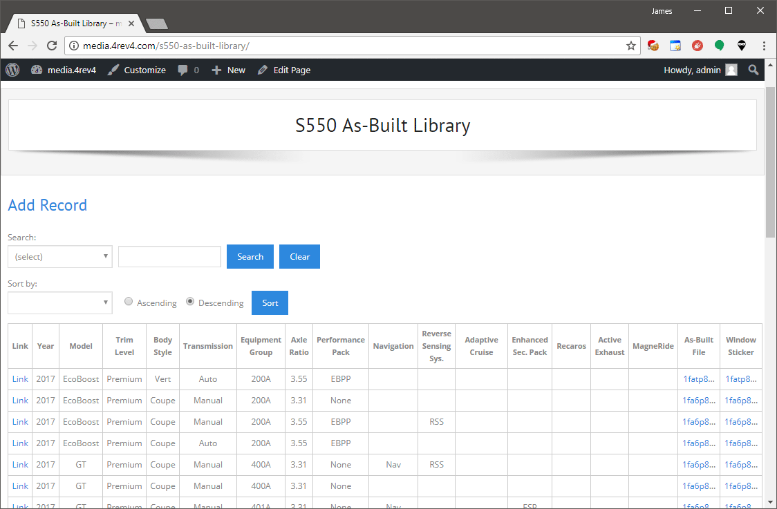

Step four: Now it's time to add a record to the library. Go here and click the "Add Record" link near the top of the page. You'll need to input the VIN, choose the .ab and .pdf files you saved, and select all of the options that car has. That will be added to the public library and now other people will be able to access it.
