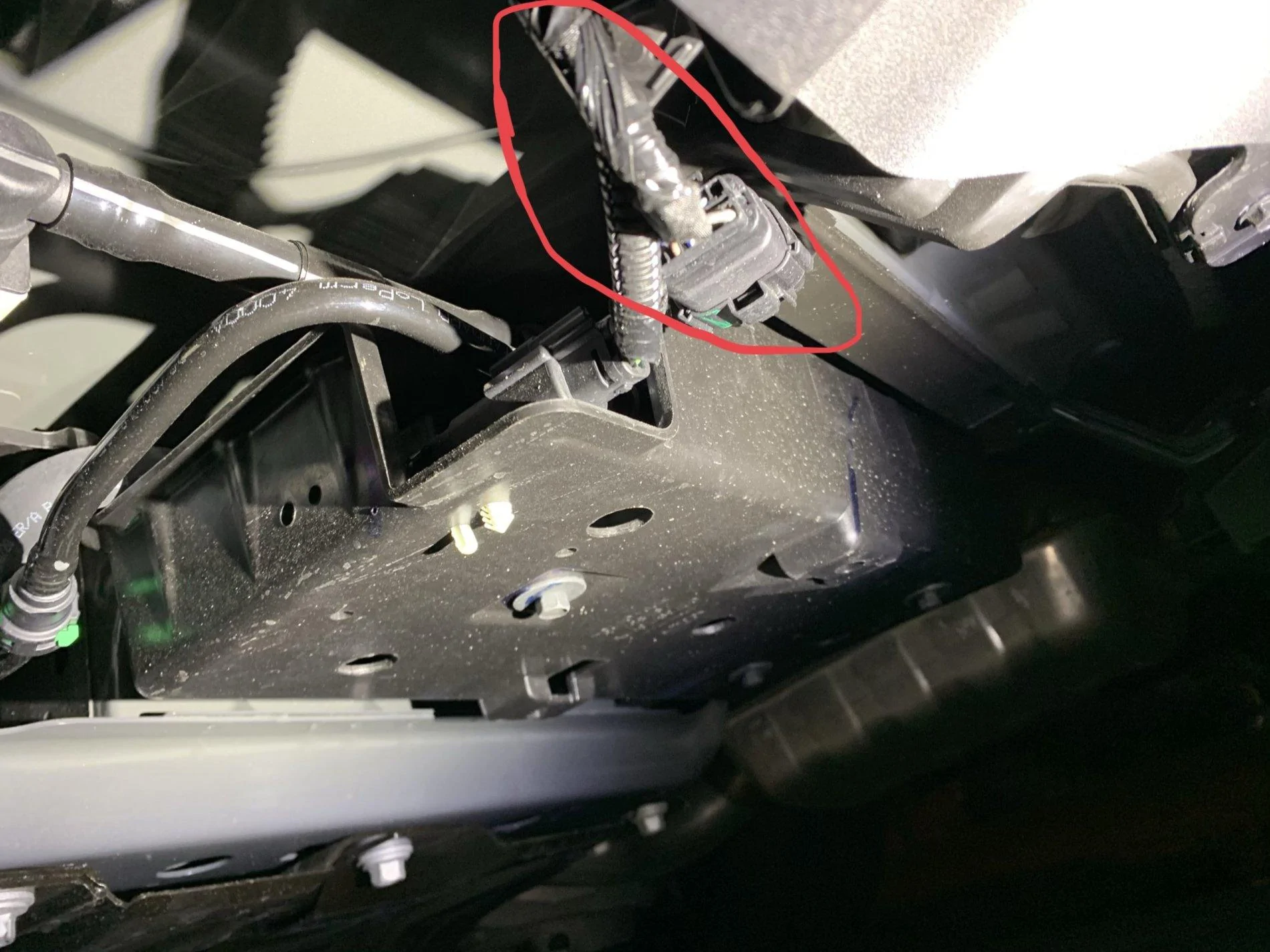

2019 here. Is this the right plug?
Also, I changed the forscan stuff. I have it in my cluster now but do not get the “no exhaust” alert. Is that normal?
Yes, that is the right plug,
Is your car a 401A? Keep in mind, if you have a 401A, there are 2 lines that need changed for the active exhaust to work. It doesn't seem right that you don't get the "no exhaust" alert despite not having anything hooked up to that plug, but I can't give you a certain answer as I programmed mine after install
I did what mfoley posted:
“For me, the first line was same but the second wasn't. I had a 1 instead of C but used the E anyway.
720-10-01 *XXX XXXX E = Enabled 1 = Disabled”
Just curious if anyone else has ran into this.
Well did your car come from factory with digital dash or no? Because if it did, there's another line you need to change
fairplayinc
Jul 17, 2016
64
West Palm Beach, FL
2019 GT PP1 Convertible
Yessir. It’s a 401A car. I should have mentioned that I did change the second line as well.
720-04-01 and 720-10-01
10-01 had the different character. 1 instead of C. I changed it to E like mfoley did. He got the alert. I am not.
