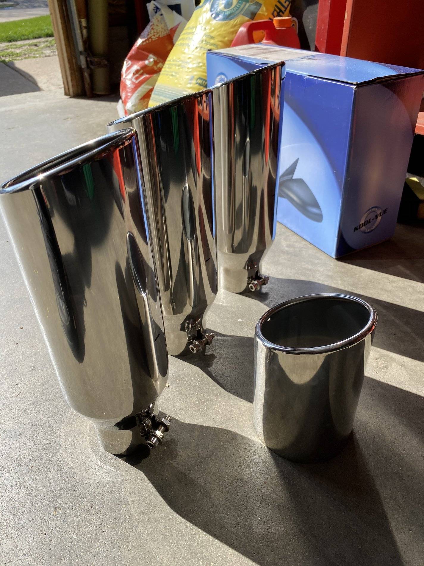

Ok, had n idea. Currently doing headers and a bunch of stuff. But tip wise. I bought off eBay some 12” long x 4” round slash cut rolled edge tips. Chopped em to 6” long from the top for the inside tips and 6.5” for the putter tips. For attaching them. I am gonna tig inside where the tip goes into the rolled edge and then either the top, side or bottom atleast an inch long. I don’t believe in bolting tips on. I will probably scuff them in advance as I plan to paint them black and the stainless will discolor where the tip is on the end. Thoughts?
https://www.ebay.com/itm/263863936088
The tips I bought. Keep ya posted with more pics to come.
This is exactly what I was going to do. Actually I was going to order double wall but Im glad to see you doing it. Curious to see the final install

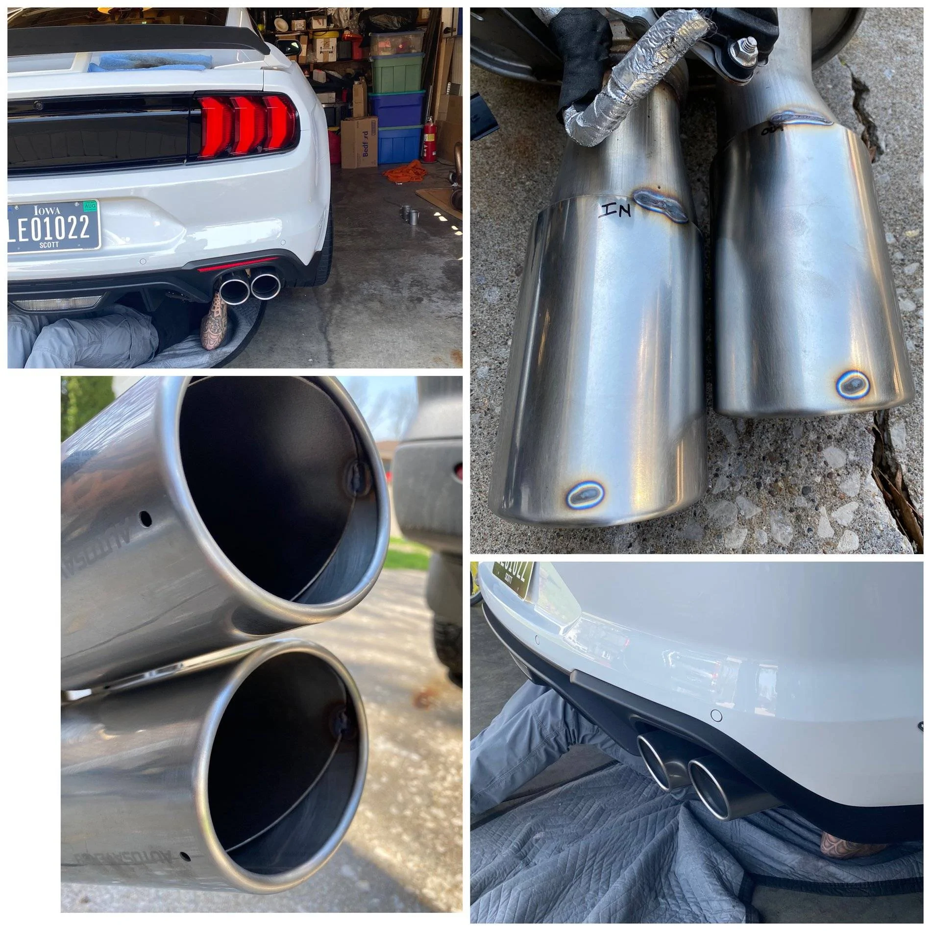

Ok. Tips are on. And pics before painting them black as promised. I think it’s gonna be perfect
Man really looks perfect. No more sticking out! Great job! I'm going to do this now
Btw, why didn't you buy black tips to begin with?

I didn’t do black tips because I wanted to tig them on. So it woulda burned the paint on the top ends do you the weld. Sitting here debating on black or just scuffed stainless as they are.
Scuffed looks nice!
Is there a way to have them welded just in the back? I don't know how to weld so I would have a shop do it for me but I would like to buy black tips so if they just weld it in the back and might be okay

Possibly. But the tips are larger diameter then factory tips. So you can’t weld all the way around. I just tacked the ends so they don’t shake or move at all
